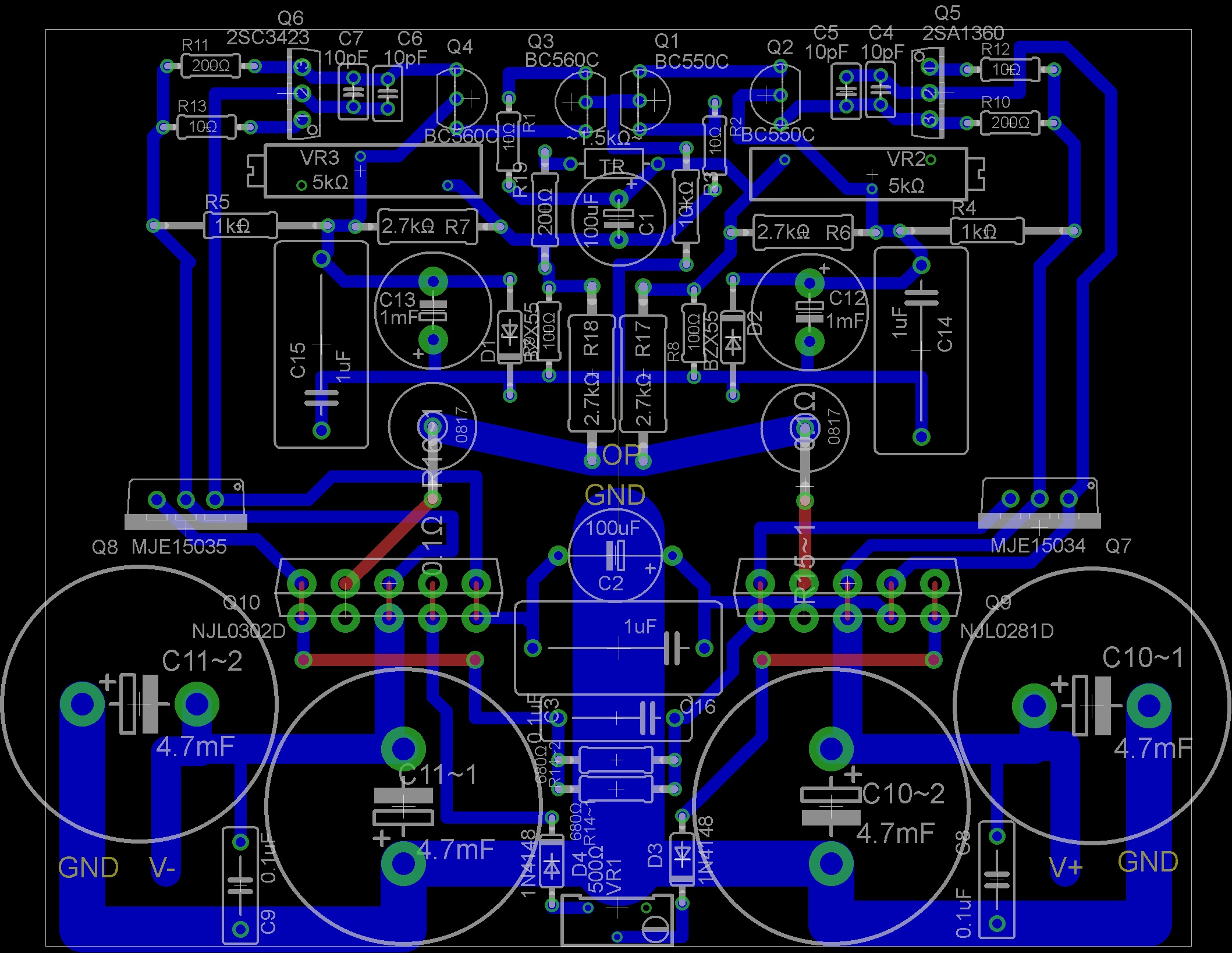

LC, I'm thinking changing output power resistor to 0.1ohm, will it effect much ?
Below attached is ammended version, which incorporated the 'joint ground'.
The layout is a bit clumsy, but my intention is to show the basic layout of my SSA BJT. Does it still posses much problem within ?
Futher possible additional feature :
(I) Regulated Power supply of 20V to small-signal-stage (Input & VAS)
(II)Input ground separation from main ground (as like LC yours)

Neither for me, development goes on with CSA BIGBT HP. Component layout, not final yet, but something like this just for the taste. ;)
Andrej, would this be the final design of the SSA? Are you going to offer a group buy soon? Hoping that it will happen, since it looks interesting and I think everybody is also waiting. I tried your simple SSA BIBGT version but wasn't so successful. The DC offset wasn't stable and everytime I turn on, it keeps on changing. I didn't have time to play with it since suddenly I became busy at work. I might just wait and try your final version, which you said it's reliable and stable.
Yes, obviously from latest layout this is not anymore simple but rather complex design, still symmetrically based but without any stability issues.

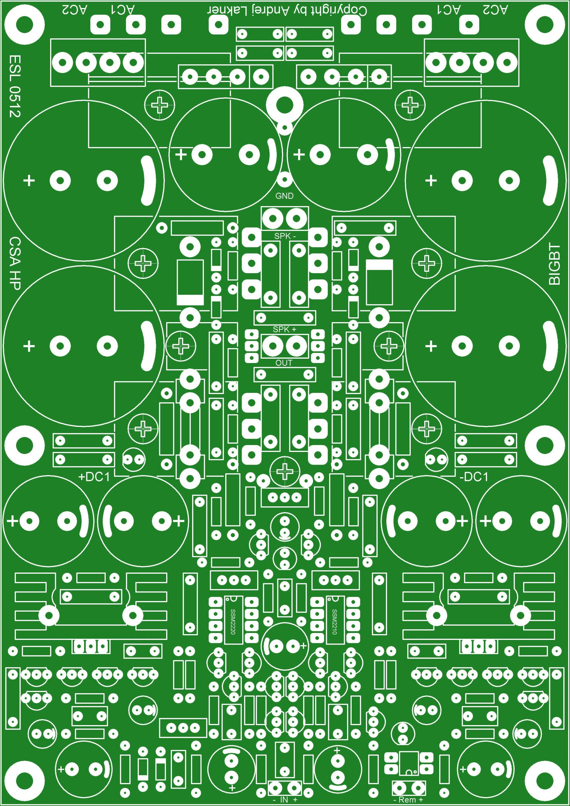

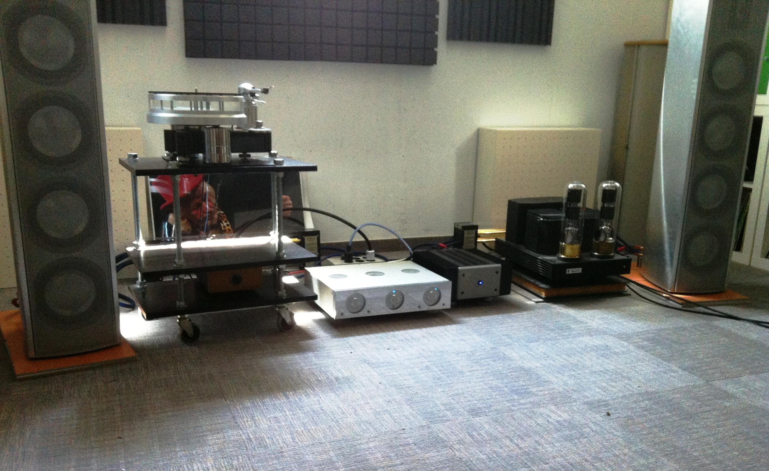

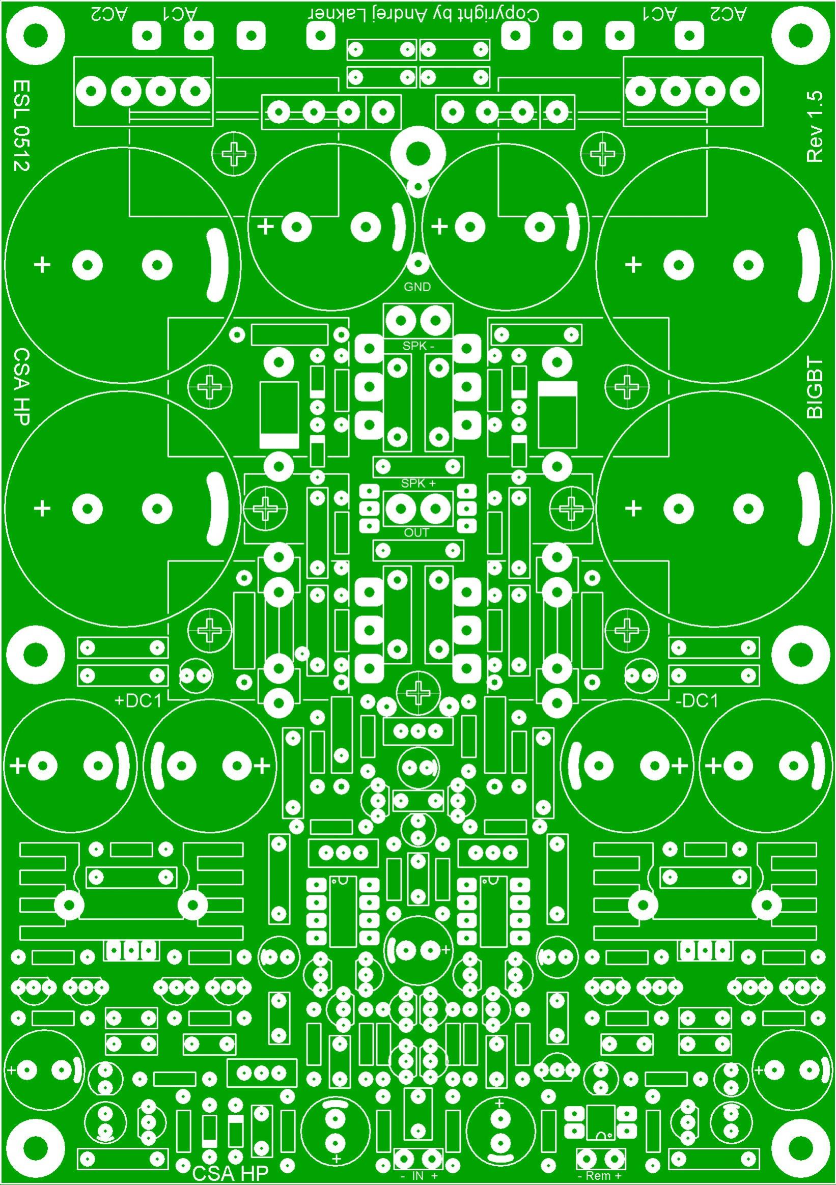

Hi guys :wave:
Just to inform you that last week we plug SSA into high-end mastering system in a recording studio for Jazz, free Jazz, Ethno and Electronica specialists and consequently SSA stayed connected. :D
So I made a formula: SSA + TSSA = CSA and new PCB (pic) went into production. :cool:
After assembly and testing I will start the new CSA thread. ;)
Stay well and have fun building amps, regards Andrej :up:
