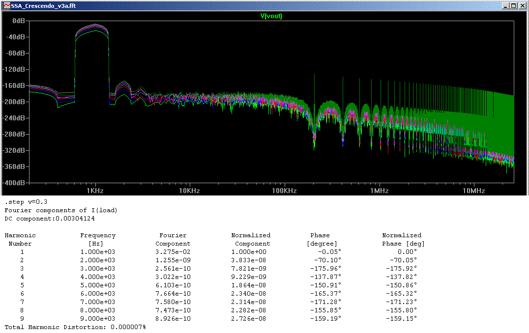

My question is, is there such thing as too low drive for the mosfet, when I can be sure that the signal is never distorted or switched when the input is tested up to 0.7V. I guess the low drive "might" cause an oscillation that cannot be seen from the chart. But what else should I look for, in term of the minimum drive for the mosfet? The more I aim for low distortion and DC offset, the lousier the drive. The picture I attached is the latest iteration for 2-stage SSA-Crescendo that I did long time ago with acceptable distortion (170mA output bias) but I think will not work in practice. I have also recently given up the basic 2-stage (driver) SSA-Latfet with 56.56V rail (Now I'm working with 3-stage SSA-Latfet).

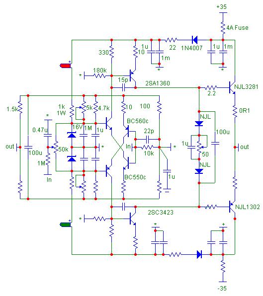

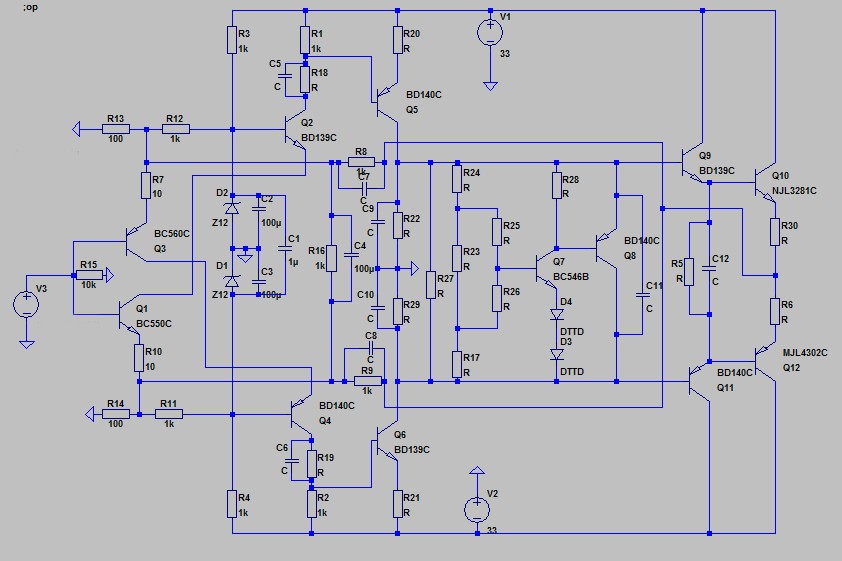

SSA BJT Thermal Trak simpleton version 1
op Q1 Q4... set to 2.6 mA that is about the middle of min noise ( 600µA) and max ft for BC550C
op Q5 Q6 set to 60 mA for best linearity and max fT.
R8C7 R9C8, R18C5 R19 C6, R22 C9 R29C10 lag lead compensation to tweak square performance under varying complex load and optimize reactive distortions.
Q7 has thermal trak diodes D3 D4 in emitter , the R network is to provide constant bias
between 25 and 125 degrees junction temp of thermal trak BJTs Q10 Q12.
This is a first simpleton approach it can be done better.
Was mild on ~zero gate current Latfet. Not for BJT output then.
Removed the CCS. This is what I have now. It actually looks pretty good on the scope. A little overshoot, but I guess that some playing with compensation would eliminate it completely. Only problem is stabilizing bias. LC hasn't yet published his thermal comp recipe yet, or have I missed it?

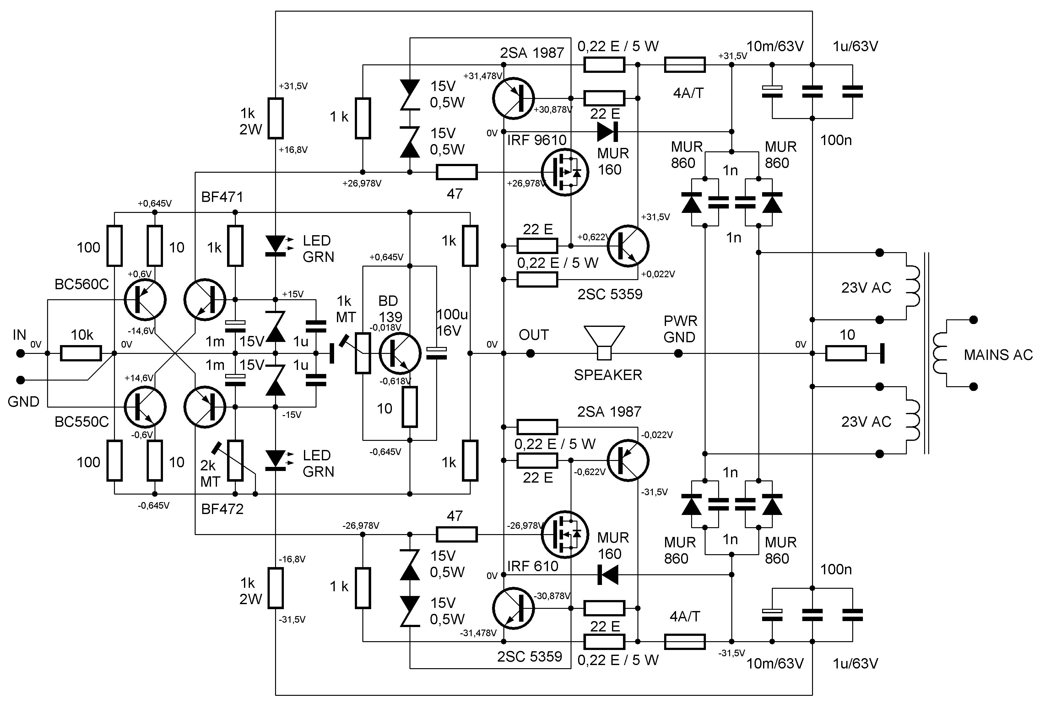

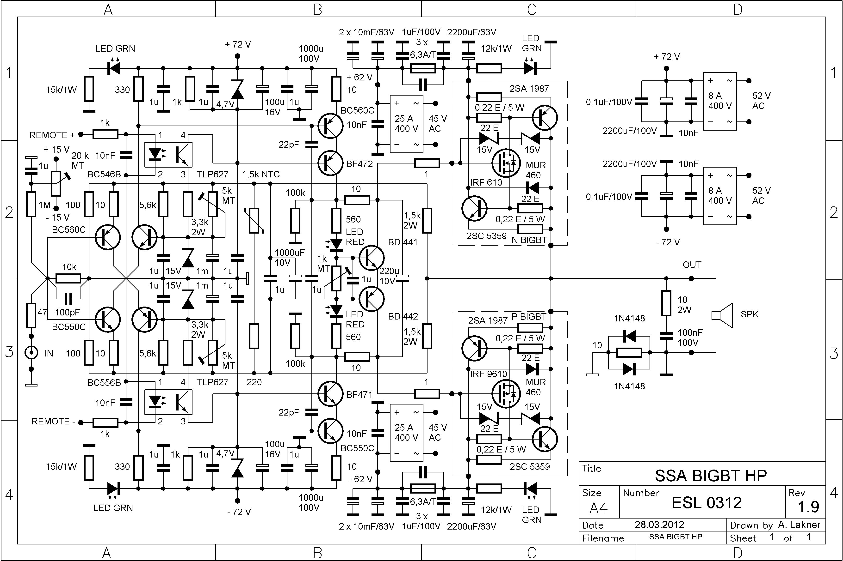

SSA BIGBT HP 1.9
Hi guys :wave2:
This schematic is working very good. Exact values of the parts are from the real SSA BIGBT HP. :)
Inner resistance at output terminals is 5,6 mohm at 20 kHz, square waves at 60 Vpp/100 kHz are razor sharp, with no overshot or ringing with or without 4 ohm load connected. ;)
1,5 k NTC is small (3 mm disk diameter) SIEMENS negative tempco thermistor, thermally coupled to input BJT pair. Together with linearization compensation 220 ohm resistor, serves to stabilize VAS 10 mA bias current within tolerance of +/- 0,5 mA. ;)
That's all for now, regards, Andrej :cheers:

I would like to start building this version (attached). Any advice or modifications to the circuit?
Well this version was more or less intelectual exercise nothing more. I do not see the reason why it shouldn't work in reality. Maybe some small frequency compensation capacitor as local feedback to mos-fet would be necessary, but that depends on PCB, complementary parts characteristics symmetry, etc. But this sch would certainly not have even near as good specs as upper sch, one important VAS stage is missing to get a real performance SSA amplifier. ;)
My latest version isn't that much more complicated and if I were you I would choose upper schematic for sure. :cool:
My question is, is there such thing as too low drive for the mosfet, when I can be sure that the signal is never distorted or switched when the input is tested up to 0.7V. .
I probably don't understand your question. Driver is a high impedance cascode (with a video transistor), over-calculated to supply enough current to the gate holes capacitances of the mosfet, not ? And mine is stable, even on high transients.
