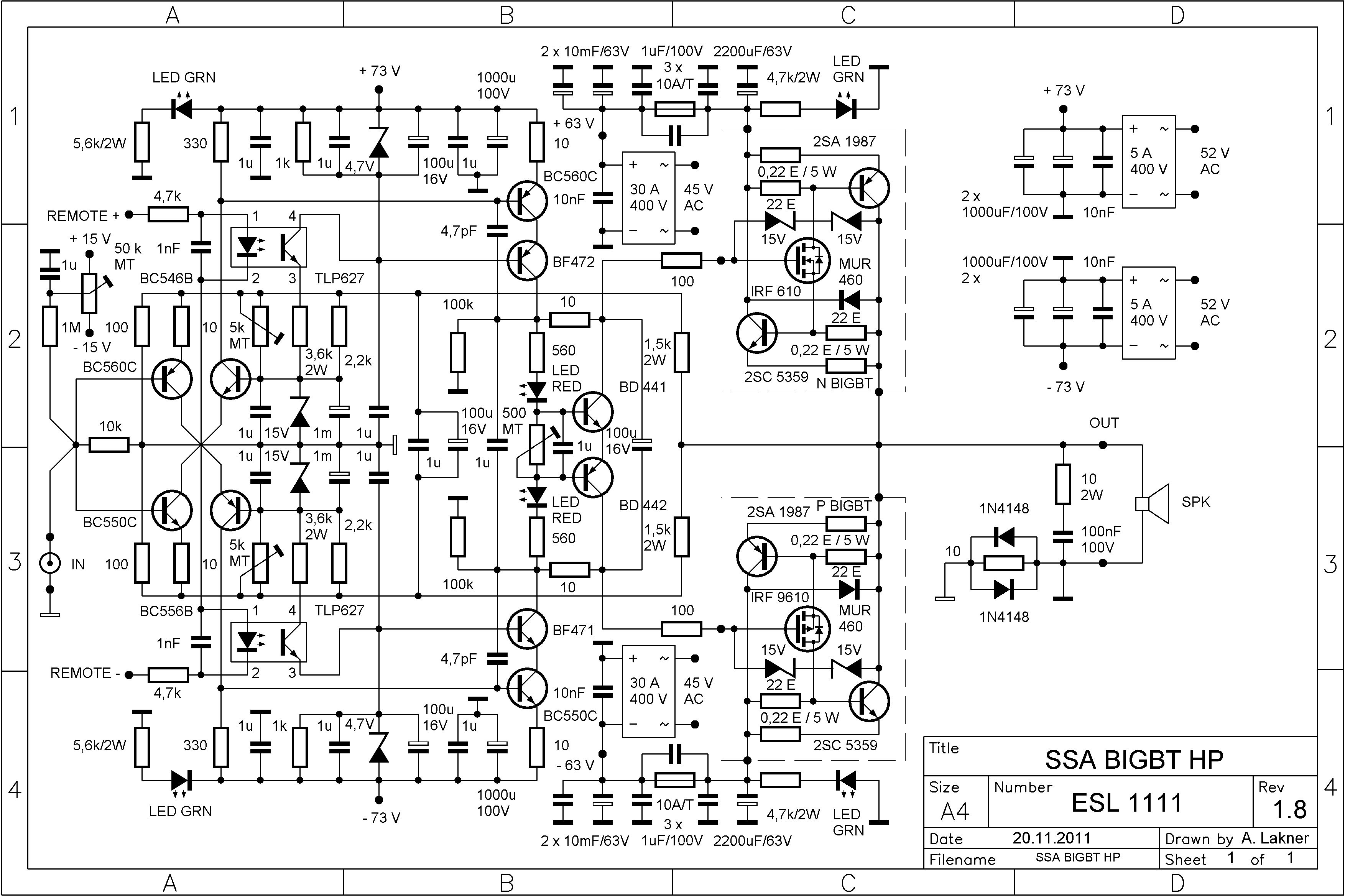

LC, the one you had just built is accordance to ?
I'm curious what is the thing at output speaker (right side), which consist 2 diodes & resistor to input ground, and the 10 ohm with 100nF cap ?
What is the meaning of 100k to ground after VAS ?
What is the terminal "remote" connects to ? What is the TLP627 use for ?
You use different transformers in schematic, is to prevent ripple go into small signal stage ?
I'm thinking of cascoding my VAS too, but is the criteria for it ? Is BD139/140 sufficient ?
1. Yes
2. Ground link between input GND and PSU/SPK GND. You can notice different GND sign (hollow, filled)
3. 50 k AC input impedance (100 k parallel to 100 k, both to GND) of the output stage, also light VAS load but the most important role of this input impedance is GND reference when VAS goes to high Z in off state (TLP's off)
4. Remote input serves to activate VAS, thus put the amp-channel to on state (bias on)
5. TLP's when on, conducts the current to wake-up the VAS and thus ouput stage bias (bias on)
6. I use one 400 VA transformer per channel. It has four secondary windings: two for VAS and two for output stage. Yes, better ripple rejection resulting in better PSRR value.
7. Cascoding VAS results in a higher bandwidth, higher OLG, etc.
8. No, BD139/140 have not sufficient Vce. Again I will suggest to you please use 2SA1209/2SC2911
Regards, Andrej

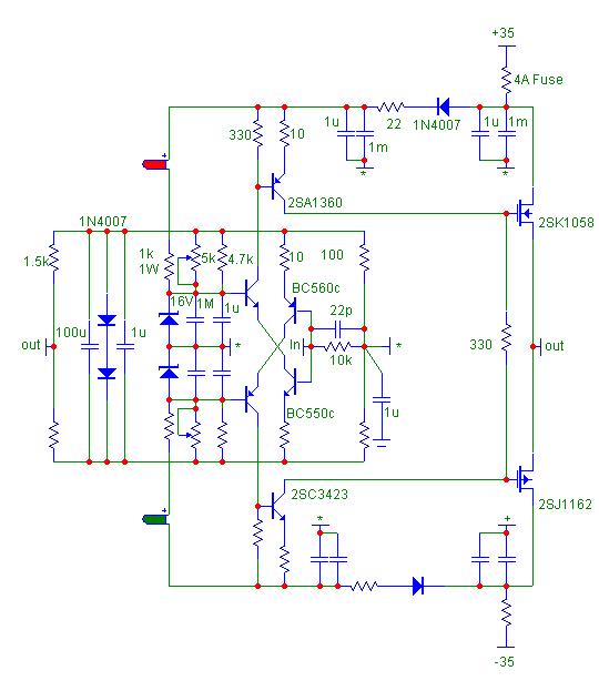

Hi guys, me back
I really like the simplicitiy of the input stage and splitted feedback and all about SSA, so I decided to solve thermal stability issue in a simple manner. Of course one could do it by adding BJT's, OP amps, etc., but than this would become something else. The simplest solution of them all is to put NTC + serial resistor in parallel to 100 uF in feedback bridge. NTC must be thermally coupled with the input pair BJT-s and serial resistor is serving to lock the NTC to be in exact proportion to input's Vbe thermal drift. At the end VAS bias current is stabilized to 10 mA from cold start to any thermal condition there is.
And some pictures to show how SSA BIGBT HP should look at the end.

Great looking chassis and layout , a couple questions , what is the 4 pin locking connector for ? Any issues with the transformers being so close ?
Hm... then I would like to understand how different is when input and general ground is separated and join ? (won't the input ground separated from amplifier ground sounds bad ?)1. Yes
Regards, Andrej
For 2-5 answer, its all incorporated because of TLP (remote) ? its like standby mode ? nice ^^
Hm..... For 2SA1209/2SC2911, The spec is wonderful for me, but the seller site doesn't favor me in that way. It only have one of them in sales (seems funny and ridiculous ? thats the way they are doing.... even my BD139/140 brought from different manufacturer because of that....)
They are not "separated". This just allow "star" grounding near power supply, and avoid ground loops and it is classical. The little resistance just gives a reference in case correct grounding of the input is not done.Hm... then I would like to understand how different is when input and general ground is separated and join ?

Input GND connection through 10 ohm resistor to main GND (antiparallel diodes serves to limit the resistor voltage drop to +/- 0,7 V and thus its max power dissipation) prevents interference currents to flow from source device because this 10 ohms resistance is around 10.000 times greater then direct GND connection from input RCA to main GND. This connection has to be done with separate wire from input RCA to main GND to equalize these two potentials to zero - same reference potential for input and output. Also in stereo amp left and right RCA's pins GND are connected together with short wire. This equalize potential between channels.
As you can see now the input GND is not separated from amp at all, there are simply two paths (exactly described above) made to prevent the hum & noise from interference currents.
TLP's when off, turns the output stage to high impedance state (Zout=Mohms) - BIGBT's are completely off, so you don't need an output relay.
... As long are they are not burned in short circuit !BIGBT's are completely off, so you don't need an output relay.
I performed some testing today before putting the channels to case assembly.
First I checked thermal stability of VAS bias current through 5 hours testing period. At cold start VAS bias current went from zero to 9,7 mA in 3 seconds period, than in next 1 minute it went to 10,8 mA and finally stabilized at 10,0 mA. When playing music loud main the heatsink becomes hot and within some pauses went back to 45°C, in between VAS bias current fluctuated between 9,5 mA and 10,5 mA, so difference was 10 mA +/- 0,5 mA, which I consider as a very good result. At the end VAS thermal influence with such simple compensation solution is ruled out from equation, so only Vbe multiplier has the standard role to prevent the output stage from thermal runaway.
Signal generator measurements with square waves shows no ringing at 100 kHz with speaker connected. Also I checked stability with Vout=120 Vpp at 100 kHz. There was smoke coming out from zobel resistor but on scope there was not a sign of any instability.
Than there was 2 MHz sine test which showed gain drop of only -0,8 dB and phase shift of some -15° between input/output signal.
After the signal generator testing there was a few hours of music listening and VAS bias current monitoring.
Output DC offset was within +/- 10 mV all the time, independent from thermal conditions present and this without any DC servo circuit.
Now, based on upper results, I think putting the amp together is quite realistic next step.
