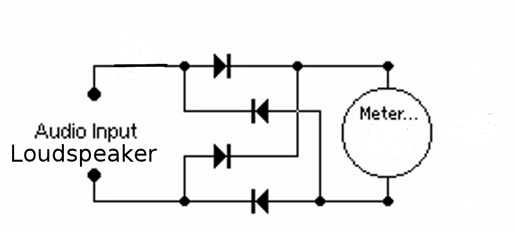

simple solution for VU-Meter
Apparently, your meter is not very sensitive. You can improve the sensitivity by using a 1N34 (or similar) germanium diode to feed the meter rather than a silicon diode. Silicon diodes do not conduct until there is about .7 volts across them. Germanium diodes will conduct at a much lower voltage.
You can improve the performance even more by using four 1N34 germanium diodes in a bridge configuration to feed the meter.
Other than that suggestion, you may need to build a buffer stage to feed the meter.
It's possible to build such a stage using a transistor or two. It's easier to use an op-amp.
So.....I could have used the original one-trans. circuit (s.Pic) had I just fed it from the output? I think I' ĺl try the germanium diode first.

P { margin-bottom: 0.08in; } I tried a 1N60 (1N34 equivalent) diode, meter registers a little earlier but the sound still needs to be turned way up. I'm going to try a bridge with 4 x Schottky's 43/46, they're low-voltage similar to 1N60. Ordered online, wating...............zzzzzzzzzzzzzzz.................
Well I've tried the diode bridge, it didn't bring any improvement, meter still only registers at high volumes. Could you possably point me towards a very simple op-amp circuit that works on 15 volts, no negative rail. I don't need complicated circuitry to calibrate or anything else, as long as it registers at a reasonable level. Much obliged
I used the schematic from Rod Elliot (VU And PPM Audio Metering).
