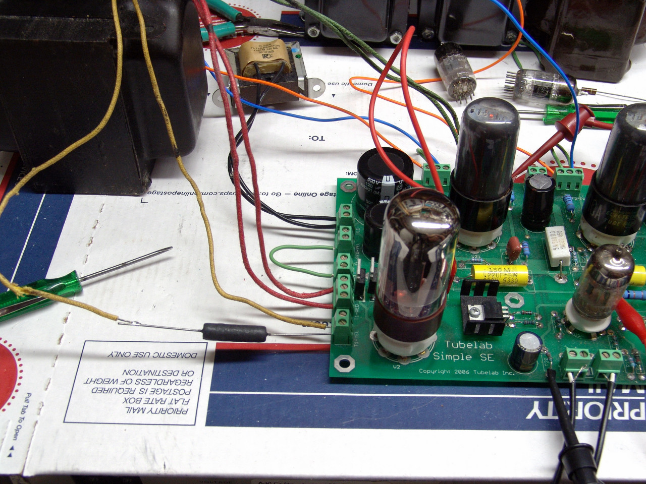

Has anyone hooked up one of those ten pound power transformers that George found on e-bay for $15 to a Simple SE amplifier? The power transformer has 6.3 volt taps. Can I use one of those taps plus a resistor to heat up the 5 volt heater of the rectifier? I am sure that it can be done. Has anyone worked out what value of resistor? What pair of leads?
My estimation is 6.3 – 5 = 1.3 volt drop at 2 amps gets 0.66 ohms. E/I = Ohms

Not yet. It looks like it would be easy to do, and yes I would use a resistor. I have the transformer and the resistor, but I don't have a working Simple SE board! I have the crusty old one that has been used for all sorts of experiments including anything that might blow up. If I get time tomorrow I will try to fix it.
Pure conjecture at this point...until I actually try it:
Install the SS diodes BACKWARDS. Run a jumper from the SW1 terminal closest to the front of the board (the diodes common) to one of the ground terminals at T1-RED-YEL. This creates the SS part of the hybrid bridge. Add a resistor in series with one of the 6.3 volt secondaries and connect it to the T1-YEL terminals. This should result in a B+ in the 325 to 360 volt range. This should work with the usual tubes and a 3K ohm OPT, or a set of 6V6's and a 5 or 6K OPT.

After changing a few parts in a dead SSE board (how did I blow a 12AT7) it is now live. I removed the SS diodes, turned them around, and reinstalled them. I used a 0.8 ohm 7 watt resistor to feed the 5AR4. I wired it up just like described above and flipped the switch. No boom, no smoke.
Bad news:
My estimates for the B+ were higher than I really get. Using a Chinese 5AR4 I get 285 volts of B+ under load. 5AR4 heater is 5.05 volts. Now 285 volts isn't going to rock the world using any tube that will fit in the board. So I just stuffed in some vintage smoked glass RCA 6V6GT's wired them for triode and let both watts rip.

It's an experiment that has been on my list for a while. I needed to find out how much voltage these transformers will provide in a real world application (before the price goes up again). I plan to stuff some SS diodes into the 5AR4 socket to see what I get. I need about 350 volts for SSE and SSP boards. It doesn't look like these are going to get there. I measure exactly 235 volts on the secondary unloaded and 234 volts with a 120 ma load.
