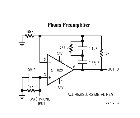

0.1 dB is hard to hear but 2 dB?? RIAA curves creates a certain "klang" (sonic impression) so it's rather important that the curve fits to the reality. If you have one amp with -2 dB in here and there and an another one with + 2 dB.... The amps will sound different the SAME ears. I guess you don't change ears from time to time?
halojoy said:The 0.1 dB accuracy of the filters is to overdo things.
A deviation in the region 1-2dB is well enough.
But use very high quality resistors and capacitors for setting the filter values.
halojoy said:If we build a Simple but good RIAA, it can be sometimes
hard to find the exact values for the components,
unless we use several in series or parallell.
But if we can get within some % from the timeconstants,
with a few components, We don't have to panic.
It's not so hard really to use few components. The amp at the picture has decent accurancy.

Simple and very good OP
this OP-amp Schematic, posted by peranders
shows that it needn't be complicated
It uses LT1028, one of the most suited OP amps, for this application
and a few components - use 1% resistors
and try to find 2 capacitors that have close values
MKT or MKP
Of course a good quality Power Supply is important for
an amplifier with high gain.

Re: Re: Re: Bugle!
gotcha
so what did you do with these diodes? did you put them across the power supply?
Cobra2 said:
The bugle has 6 amp-stages (stereo), 3 for each channel, and that is what I'm trying to tell...
An OPA4134 is fine for MONO... add a OPA2134, (or another 4134, 2-unused), and we have STEREO!
BTW, I have good results running them i "Class A" , using a "J508" constant current diode (2,40mA)
Arne K
gotcha
