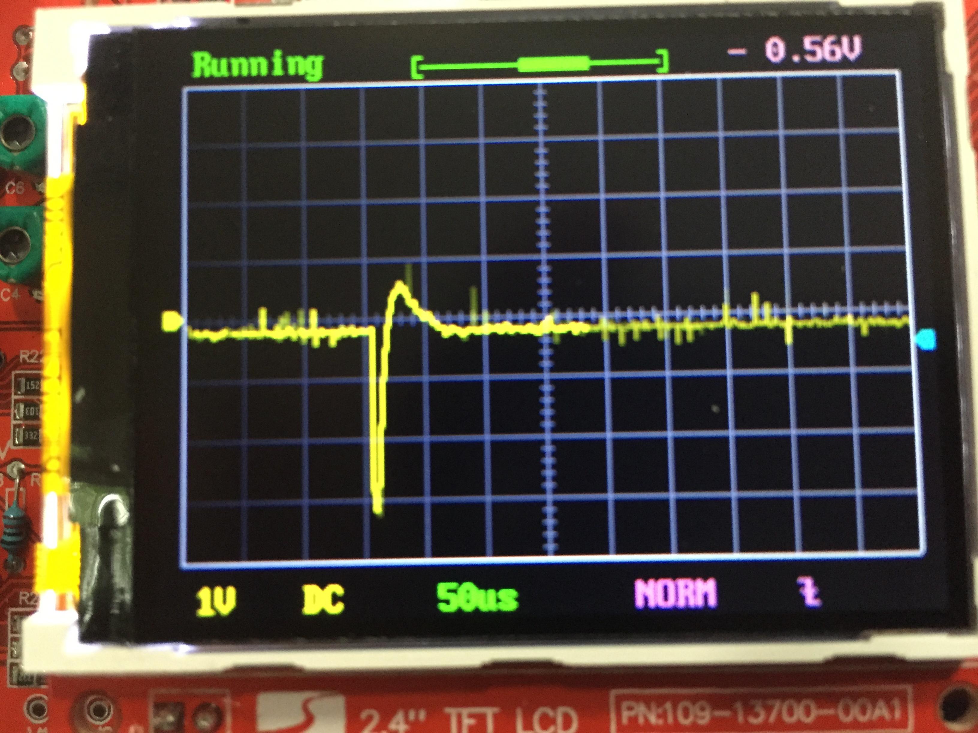

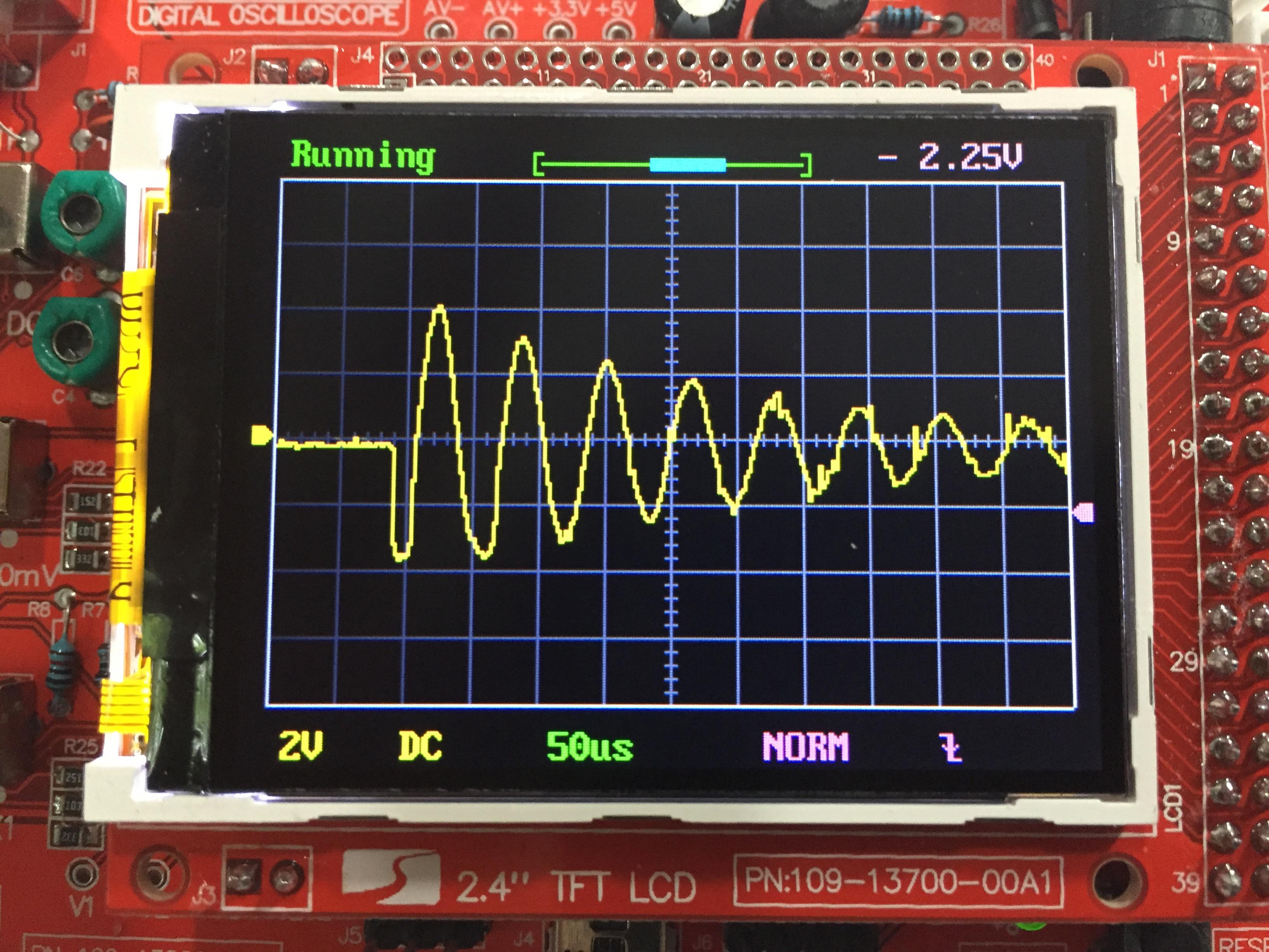

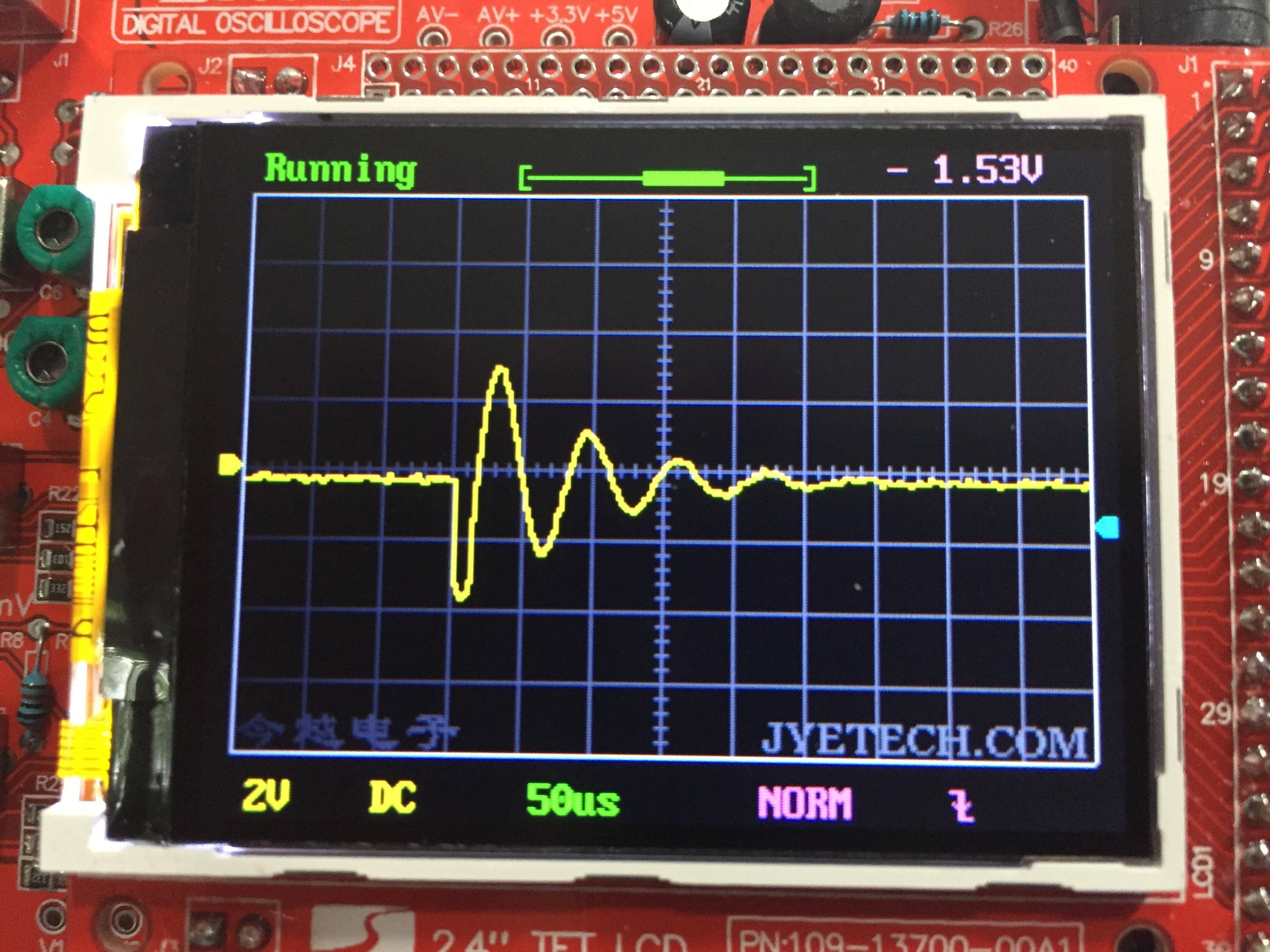

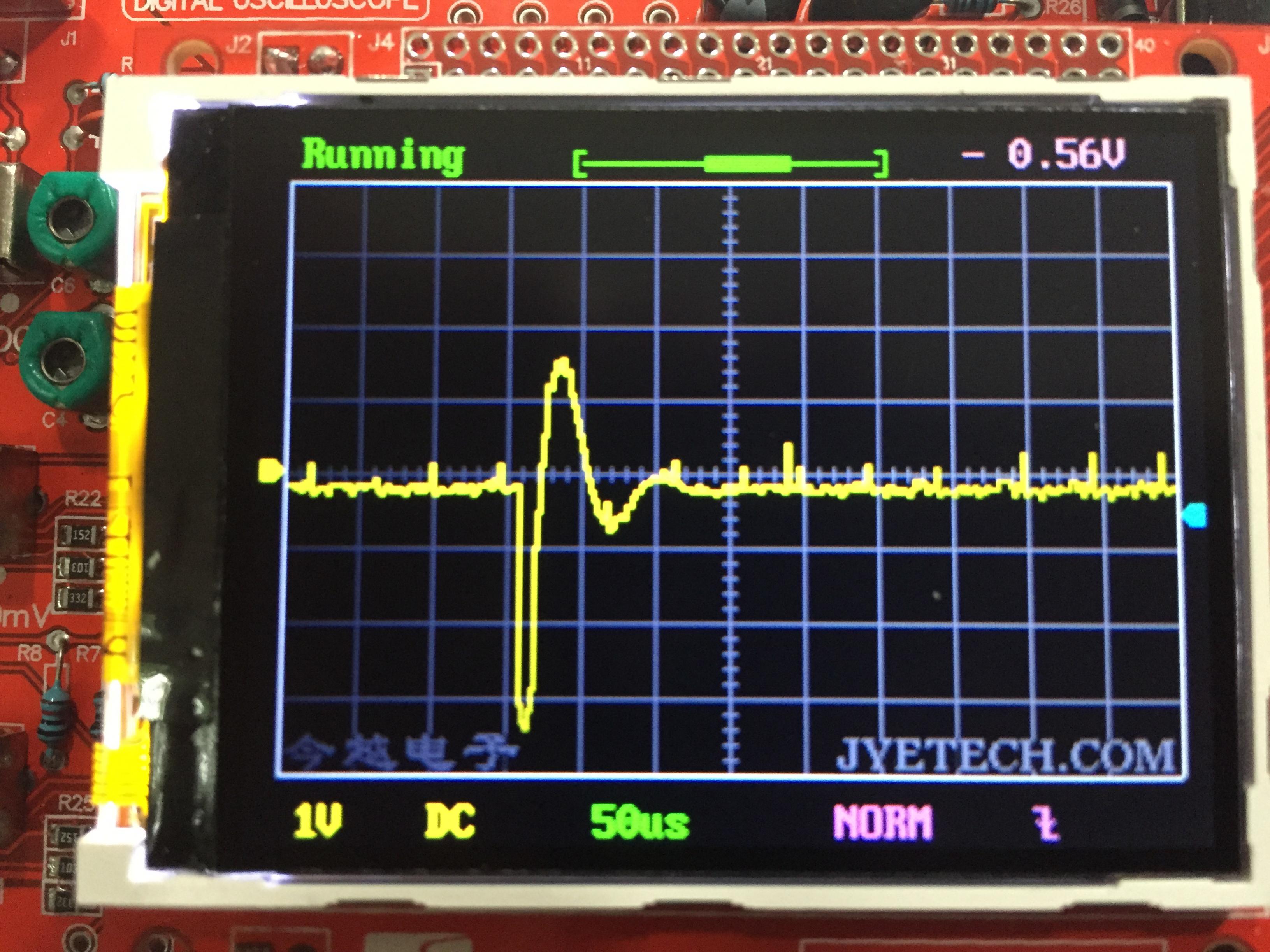

I bought one of those eighteen dollar oscilloscope kits on eBay, the "DSO138", and tried it out with Quasimodo and some transformers and some inductors. I found it to be a cute little electronic stunt and enjoyable hobby plaything, but not actually useful in combination with Quasimodo.
The thing simply isn't fast enough to digitize and display waveforms from real transformers with real snubbers. Although the claimed bandwidth is 200 kHz and the claimed sample rate is 1 Msps, I couldn't get it to trigger on nonperiodic signals even at much slower settings. It certainly won't display the ringing of a low-leakage-inductance toroidal transformer like the Antek AS-2222, which is used in many chip amps.
I did succeed in using DSO138 + Quasimodo to critically damp a 10 millihenry fixed inductor, as shown below. Unfortunately real transformer secondaries have leakage inductances a factor of ten thousand smaller than this. So the toy example below does not extrapolate into real world success on real world transformers. Too bad, it would have been fun to measure a $100 transformer with a $18 oscilloscope.
