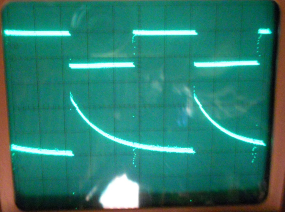

I include 2 pics about my situation:
Pic "500VA-1200VA" should give an impression between a standard 500VA/2x42VAC and my special 1200VA/2x28VAC-tranny. Of course my tranny is oversized, but a very low noise design specified for only 1000VA; I assume its core to be at least 1200VA.
Pic "Quasimodo Results" show traces on an old (like me) analgue scope before and after suggested 10nF-series cap. Upper trace (before = input) has 10V/div., lower trace (after = output) has only 5mV/div (!!!).
Results with 500VA-tranny were just normal, identical to Mark's description in his technical article.

hm4nine, your analog scope photo might have the bottom trace inverted (?) Quasimodo uses a state-of-the-art, super low-Rds MOSFET to yank down the left end of the series capacitor Cx, and yank it down HARD. This also yanks down the right end of Cx.
So we expect to see falling-edge waveforms in both traces. But your traces show a falling input and a rising output? That's perplexing.

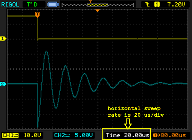

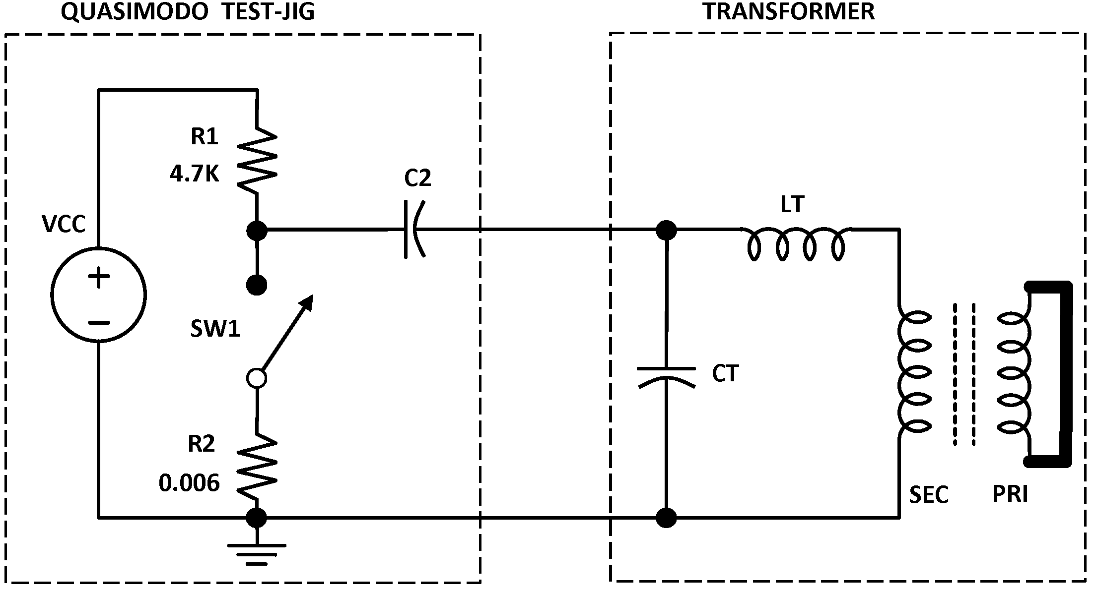

hm4nine, the Big Quasimodo Idea is shown in the design note Fig.2 (page 3), which I have copied below. Switch SW1 is the bell ringer; the bell is struck when SW1 closes. That's where all the action is: at the instant when SW1 closes, a very steep falling edge is driven into the transformer's secondary leakage inductance LT, and this rings the bell. So we use a dual trace oscilloscope to trigger on the falling edge and to zoom in to the ring-a-ding-ding oscillations that occur immediately after.
Transformer secondary inductance LT is generally between 400 nanoHenrys and 20 milliHenrys. You can grind through the math to see for yourself that, with a Cx of 10 nanofarads, the transformer secondary + Cx will oscillate at a frequency between 12 kilohertz and 2 Megahertz. To see 3-5 full periods of oscillation, the horizontal sweep setting on your scope needs to be between 0.2 microseconds/div and 50 microseconds/div.

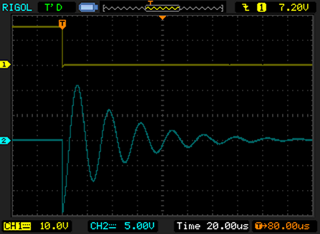

Let's have a look at the sweep rates for published scope photos of Quasimodo oscillatory ringing. It's easy to do this because digital oscilloscopes display the horizontal sweep rate right on the scope image itself. Our eyes tell us:
Please have a look at Fig.13 of the QM design note, to see how to correctly test a center tapped transformer (and/or four other kinds of transformer!) with Quasimodo.
Good luck!
- 2 us/div ...... QM design note Fig 1
- 20 us/div ...... QM design note Fig 3
- 2 us/div ...... QM design note Fig 10
- 2 us/div ...... QM design note Fig 11
- 0.5 us/div ...... QM design note Fig 14
- 10 us/div ...... this diyAudio Quasimodo thread, post #143
- 0.5 us/div ...... this QM thread, post #255
- 20 us/div ...... this QM thread, post #314
- Be sure to set your scope vertical amplifiers, to DC coupled {not AC coupled}
- Be sure to switch OFF your scope's Bandwidth Limit feature
