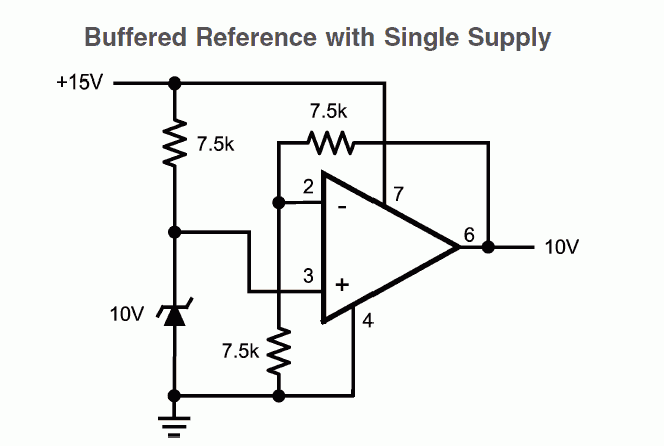

While I respect the Jung super regulator as the current state of the art, I'm interested in a cut down, low current, low cost regulator that somehow still manages to beat an LM317.
Beat, how? Well, lets say "sound better" and leave it at that for the present.
The parts should ideally total below $5 per reg.
One could add a shunt regulator "clean up" circuit after a standard series pre-regulator, but I was wondering if I couldn't just go with something like the circuit below.
Since the voltage reg is only powering one or two op-amps, less than 20mA max current draw, would it be possible to drop the pass transistor and use the reference amplifier as the pass device?
My main concern is opamp choice vs. stability once you tack on the output capacitor. Don't get upset about the noisy Zener reference for the moment, that's easily dealt with.
/Richard

The gain is 2 so the voltage out will become 20 volts. Good idea but you forget the parameter "power supply rejection ratio", PSRR. At higher frequencies noise will go via pin 7, into the opamp and out at the output.
The super regulator concept will have extremely good PSRR = clean voltage when the input voltage is not so clean.

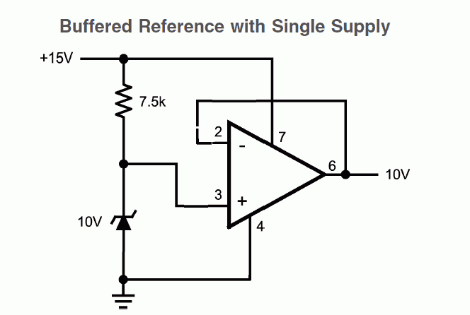

My mistake. I suppose then for unity gain something like the schematic attached. Or, for 10V output, use the original schematic with a 5V Zener.
Good point about the PSRR, I admit the Jung circuit solves this in a very neat way, powering the error amp from the regulated output. However, is the ripple rejection performance of a decent opamp significantly worse than the LM317/337? At 100kHz, the PSRR of some op-amps I looked was about 30dB (perhaps worse here since this circuit doesnt use a split supply?), while the 3 terminal regs varied from 10-40dB depending on if negative/positive or if the adj. cap was used.
If I could get the same noise performance, the the op-amp solution would still be worth looking at since the dynamic performance should be better, no?
/R

This is a good way to power low power circuits.
A thing to consider is that you will propbably will have some capacitance on the supply lines at the circuit to be powered. This must be supported by the opamp. That should not be a problem as long as you keep the cap high enough. A small resistor inside the feedback loop to limit the chargiung current at switch-on would be adviseable.
But, why not use a small-signal transistor as the pass transistor? That should not add more than a few cents to the price and you could retain all the advantages of the super reg, including feeding the opamp from the output voltage.

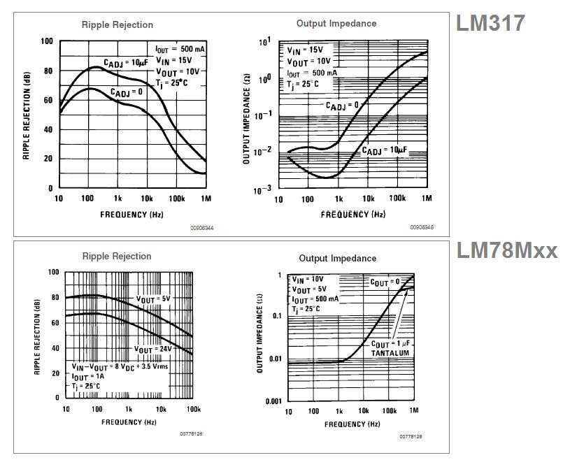

I've been comparing the datasheets (always a bad idea...) of the LM340 (LM78Mxx) and LM317. The output impedance and ripple rejection curves vs. frequency are, with Cadj on the LM317 omitted, essentially the same.
So is the main performance advantage of the LM317 simply due to its optional bypass cap, or is there something I'm missing?
