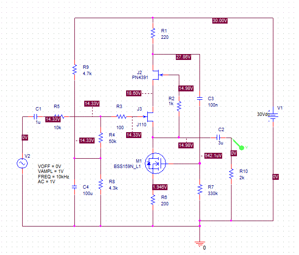

Back to the beginning of this thread - folks played pile-up on the circuit I originally presented because of perceived (but not actual) deficiencies. I took the original circuit and monkeyed with the parts to reflect something I would do 13 years down the line, and played with both the input and load impedances. The results are still not bad.

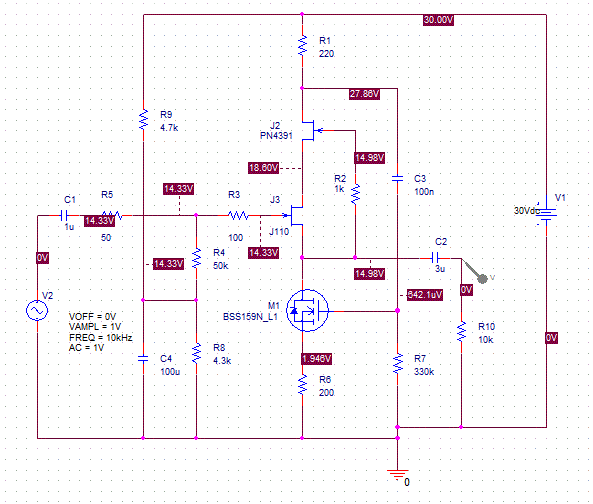

To start with, the original circuit was designed to go in my living room test bed, which has a single +40V supply. I'm not changing that no matter how many people squawk about it. The boards I drop into that enclosure have an onboard 30V discrete shunt regulator (described elsewhere).
The FETWhite circuit originally described was designed to fit in with the above mentioned scheme. I also wanted to avoid using scarce/expensive devices like the 2SK170 and 2SJ74. This is the backdrop for the investigation shown here.

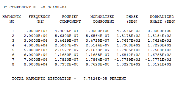

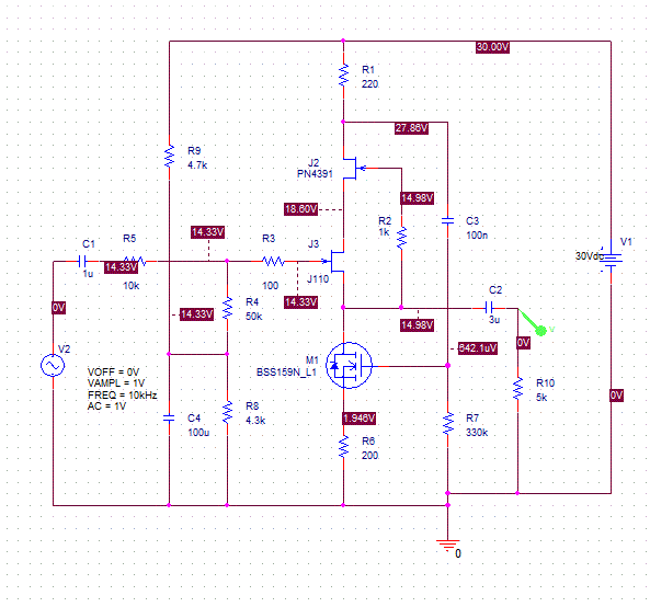

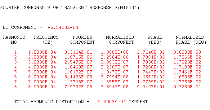

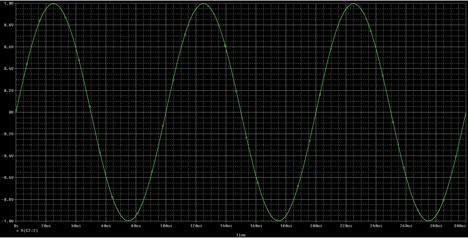

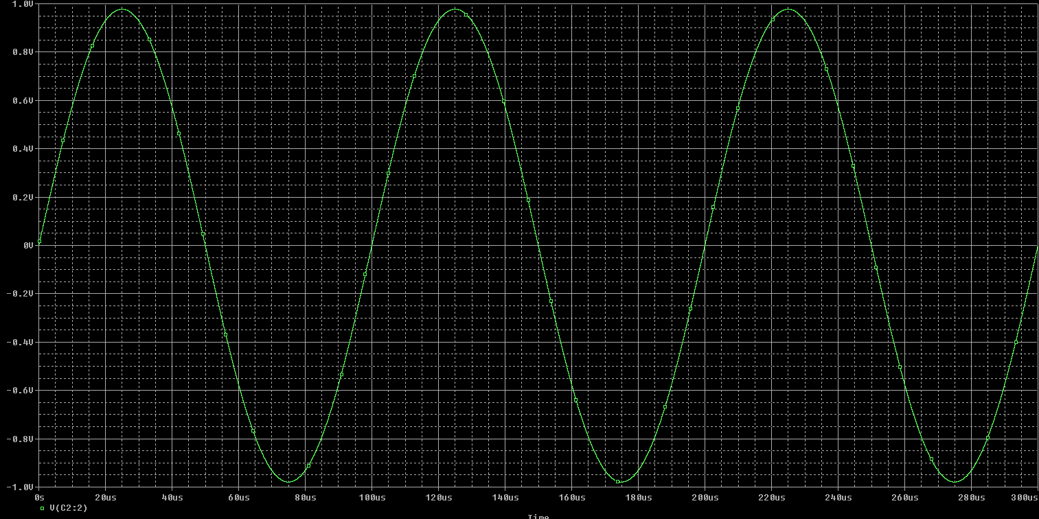

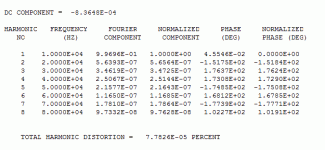

Attached is the starting sim with 50 ohm input impedance and 10k output impedance. Excitation is 1V at 10kHz. A BSS159 is used as a current source load for the follower, and should have higher output impedance than the PN4393 jfet I originally used.
As can be seen, the simulated distortion is quite low. Next up, I'll jack up the source impedance to 1k and I0k, then reduce the load impedance.

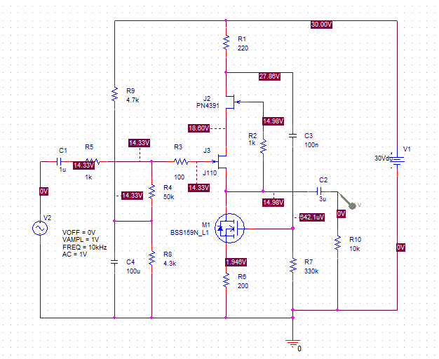

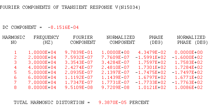

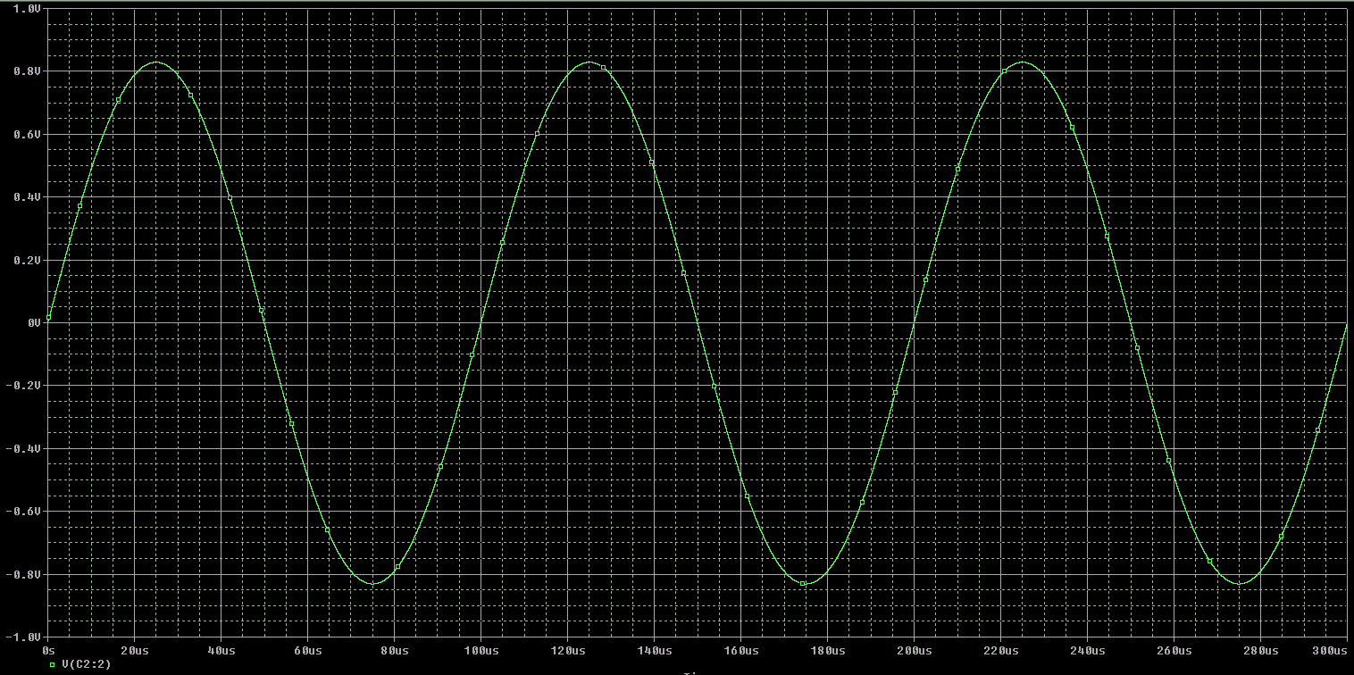

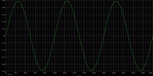

Here's the same circuit with the source impedance jacked up to 1k., with the output loading still at 10k The output is a little lower (voltage divider), and the distortion is a little higher but still quite respectable.

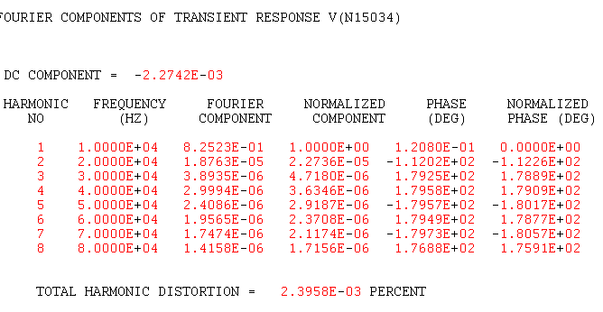

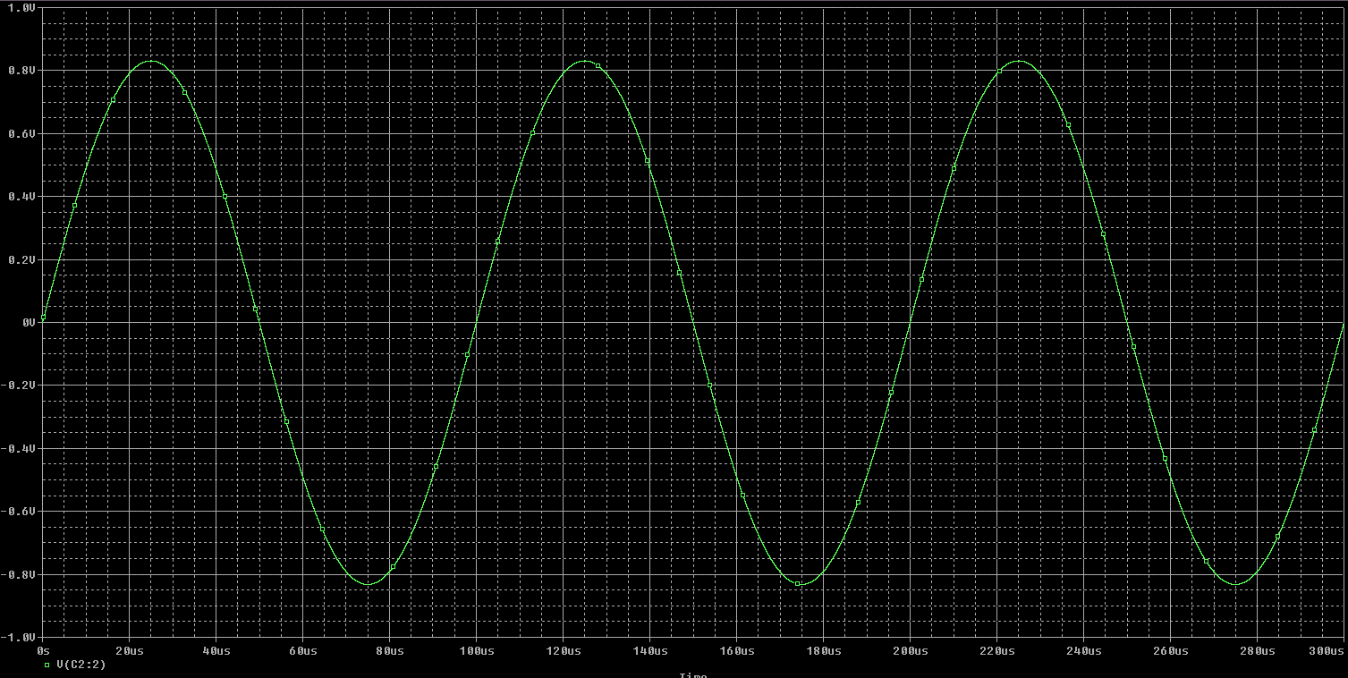

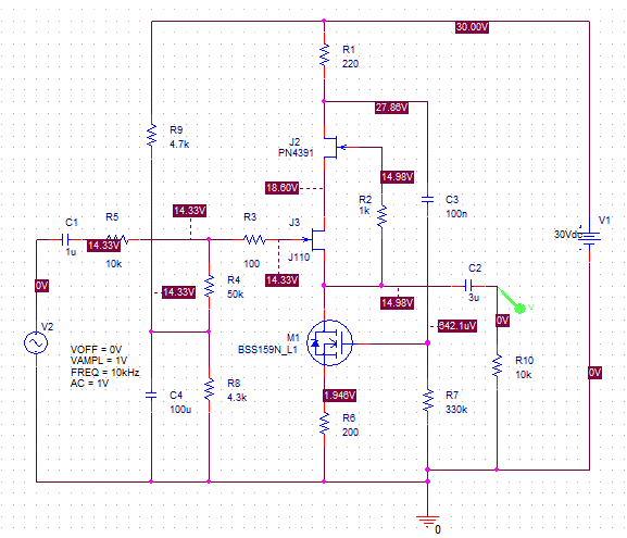

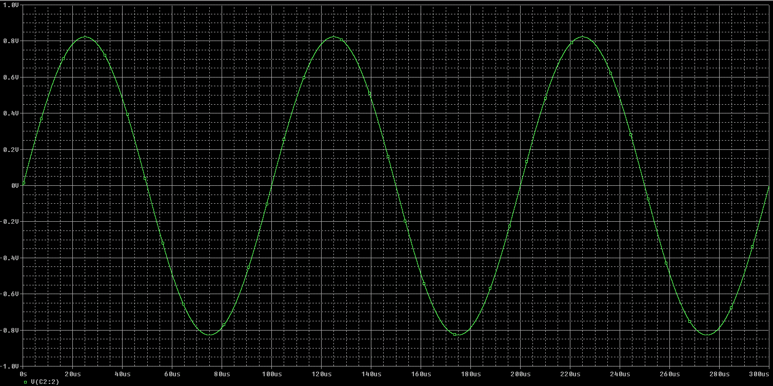

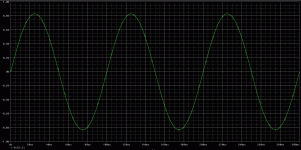

Here are the results with 10k input impedance, with the output load still at 10k. The output is lower yet (no surprise), and the distortion, though higher, is still very reasonable.
Later on, I'll start chipping away at the output load.

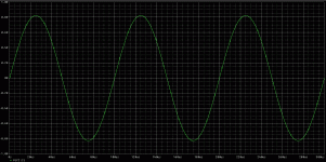

Finally, here's an extreme case with the output load resistance reduced to 2k. This would require in practice increasing the value of the output coupling cap to maintain a decent low frequency response. Distortion is still not bad for a simple source follower circuit.
