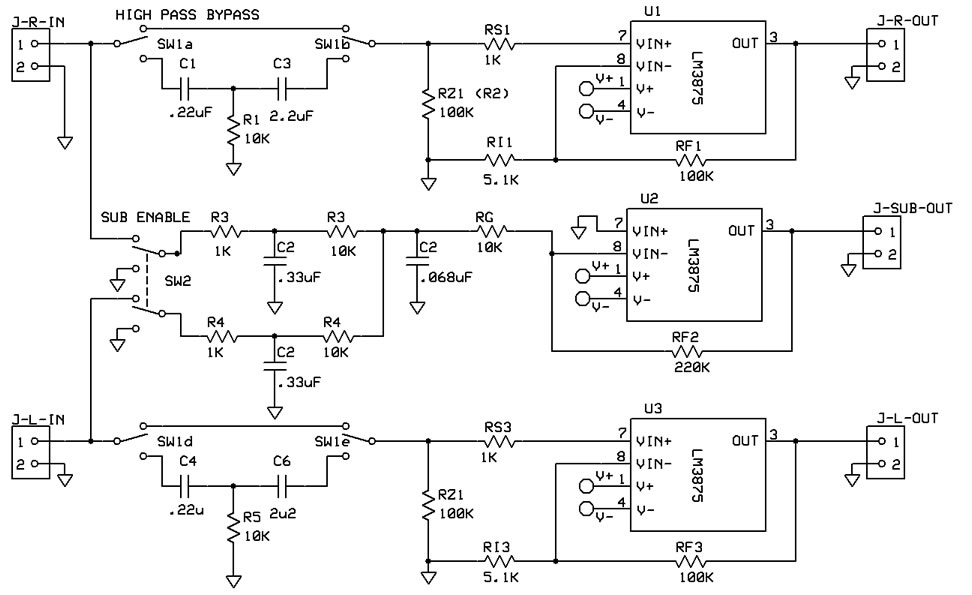

What about something like the attached schematic or 12db version of same?
gx
richie00boy said:
You might find the slopes a bit too shallow on the sub and voices bleed through with that.
I've a sub-woofer controller project on my website if you want to take a look. www.readresearch.co.uk
Thanks Richie,
Nice site and projects. When you say voices you mean that I will hurt my left/right separation? What are the slopes like for your subwoofer controller?

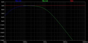

The problem with passive is that it's totally dependent on the amp input impedance. Unfortunately the diagram above won't work once you connect it to any typical amp as it will load down the filters totally screwing them up.
The slope on my controller is 12dB/oct followed by an additional upper 12dB/oct, as annotated on the schematic.
Thanks for the kind comment.
Passive filter give the predicted filter characteristic when loaded with a near infinite impedance and fed from a near zero source impedance.
You may have Rs~100r, but much more likely is Rs>=500r from the DAC.
The summing node is loaded with Zin of the power amp AND the impedance of the other feed in parallel with Zin.
Use opamps, or discrete emitter/source followers to give the correct load and source impedances.
Use an inverting amp to sum the two channels for the 0.1 bass channel.
BTW,
a bit of research may find the corrections necessary for the non ideal loading on your passive filters. Might be a good learning opportunity, but much quicker to make the filters active. Have a look here and in Pass and ESP for some very simple Follower circuits (one transistor).

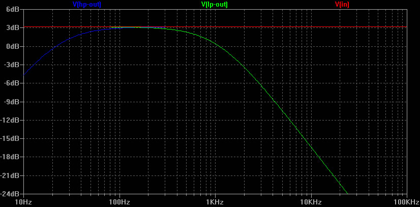

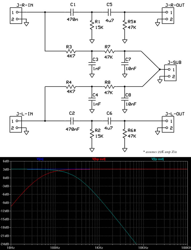

Both posts seem to indicate that impedance will kill a passive filter like this. My First inclination was that I needed op amps but L-R+Buffer is like 3 op-amps per channel+inverting summing opamp for .1+dual 15v power supply and that is a lot complexity for my simple task and my minimalist dream :).
I noticed an error in my HP calculation as I didn't really have the Zin for the amp compensated. Since I am going to put the amps in the box with the filters what if I just recruit the Zin of the amp in the filter as R2 and what if I adjust Zin of the GC amp to 100K this would give R1 as 10K
By the way, the Super DAC 707 has
LT1364C
My First inclination was that I needed op amps but L-R+Buffer is like 3 op-amps per channel+inverting summing opamp for .1+dual 15v power supply and that is a lot complexity for my simple task and my minimalist dream .
A couple of possibilities here. You can run opamps on mono-polar power supply with the addition of a handful of passive components or use a pair of 9V batteries (rechargeable if you like). You can get four opamps in a single DIP which will cover all you need. Pretty simple to wire up really. No PCB needed just put a DIP socket on a small perfboard and wire it all up point to point.
You could also do it with FETs instead of op amps which might sound better but I think that would be a little more complicated to wire up.
As Anon above mentioned ESP has a stereo board that will do this for US$24 and Marchand has mono boards for US$10 with US$0.37 opamps.
I could add LM317/LM339 to my existing power supply and do the trick but I just don't see what is wrong with what I posted before except that the slope for the high pass may not be steep enough.

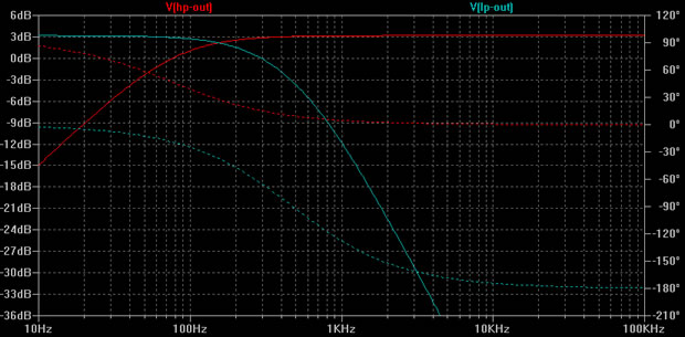

I attached the latest plot.

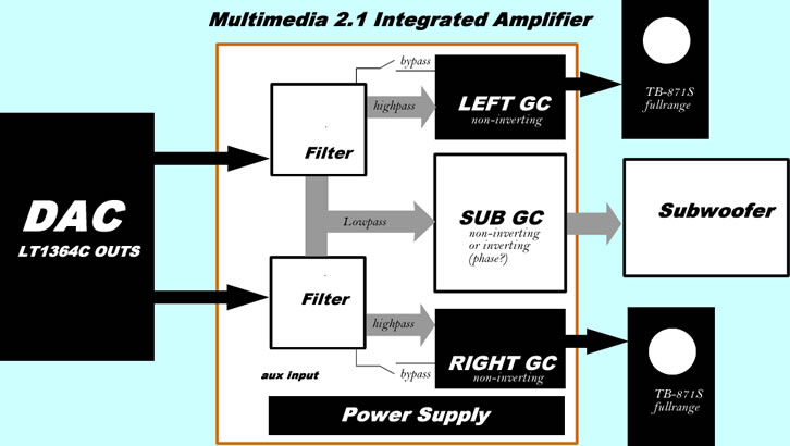

Sorry, mike, I missed this post before. I have been building tube guitar amps for the last several months so I understand about the expensive glass and iron.
see attached plan for my project. I haven't picked a subwoofer yet or box or anything. The black stuff on the diagram I have already or close anyway.

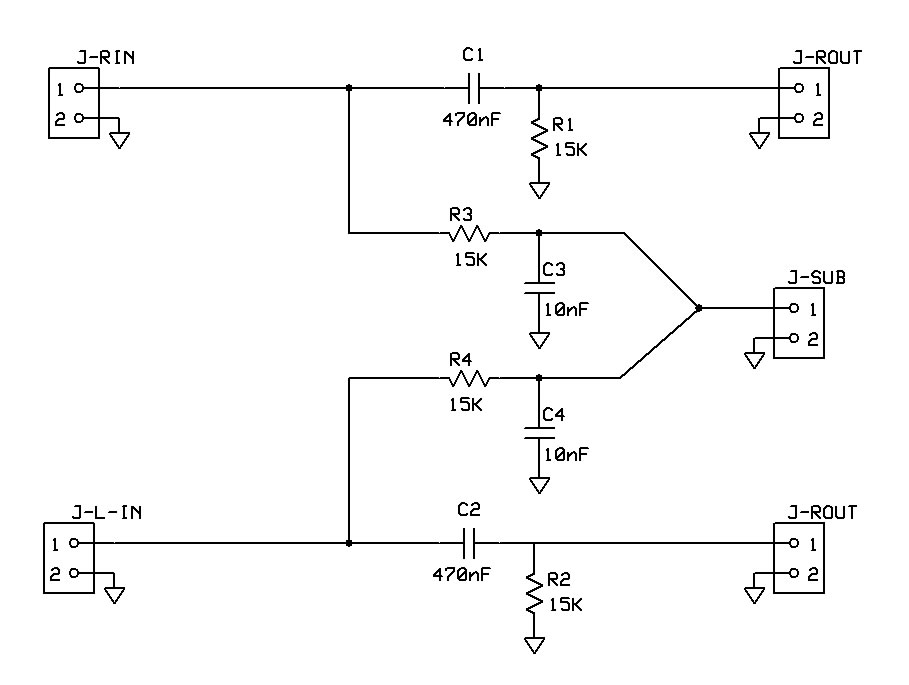

It won't kill it, you just have to very aware that the input & output impedance are part of the circuit. I am getting really good results with a 2nd order PLLXO on the Tysen prototypes -- so good that i'm going to try replacing the active woofer in the Fonken/FonkenWoofTL combo.
dave
