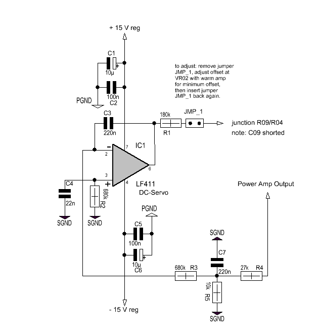

Hi AndrewT,
unfortunately I cannot understand your first sentence...
To the DC-servo:
When shorting C9 you get a higher gain at DC ( 29dB ) and so a slight DC offset might show up at the output, even after careful adjustment of VR2. This is assuming no DC component at the input! Otherwise, this input DC component will be amplified times 28 at the output. Beware!
The SKA has a very symmetric circuit topology, giving no noticeable thump at switch-on. At least my 300D does so.
To remove any hint of DC at the output terminals, with C9 shorted, a DC servo will do a good job. Having a low corner frequency, it will not interact with the music programme signal. If the DC servo is too fast, it will try to "neutralize" the low frequency part of the signal spectrum. Using bi-amping configurations, this might be wanted, to remove any lower freq. out-of-band signal that might damage the midrange or tweeter speakers. In such a case, the integrating and filter capacitors have to be reduced accordingly (C3 and C7 in my circuit), see attached file.
I plan to use the same kind of servo at the output stage of my pre-amp, bringing the DC offset down to zero (almost, just a few tens of micro volts from the offset of the opamp).
Hope this helps you a bit.
stoeffle.

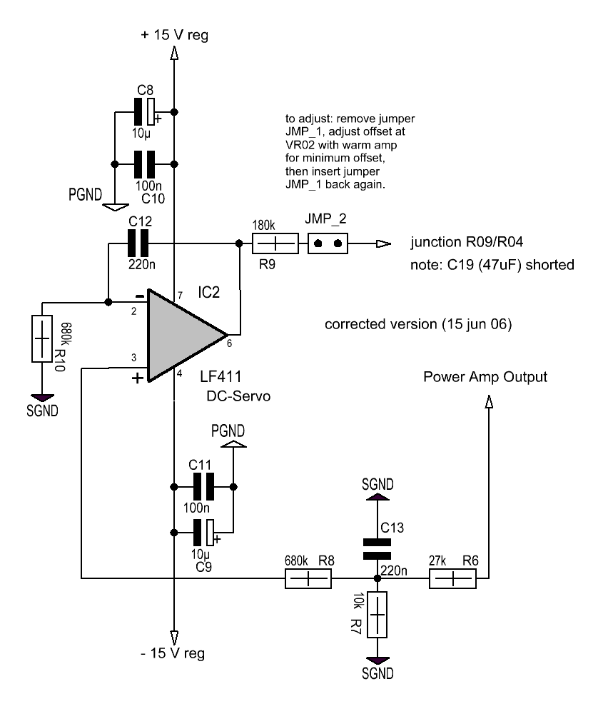

Re: SKA & DC servo ERROR CORRECTION OF SCHEMATIC !
Due to an error on my side (the problem is between the headphones, as pilots say...), I loaded the wrong schematic.
please disregard the one posted yesterday. This one is the corrected one.
Sorry... on my head!
stoeffle

AndrewT said:Hi Stoeffle,
I have seen DC servos with a low pass filter on the input and the low pass feedback around the opamp. Your's is the other type with just the feedback low pass.
Why do it this way?
What are the advantages (besides saving a cap) and disadvantages?
Hi AndrewT,
First of all, op-amps used as DC-servos have to have a high open loop gain (for high precision) as well as minimum offsets (current und voltage). Otherwise we would add DC offset errors...
Usually, for cost reasons, op-amps with these features and low cost have very limited gain-bandwidth producs (= slew rate). Thus, to avoid overloading the op-amp (SR overload), we add a capacitor to form a LP-filter at the input and cut-off the high frequency (= high SR) parts of the signal.
The low-pass at the feedback you mention is the real working part, the integrator. As long as there is a difference at the input terminals, the integrator will ramp up (or down) its output, thus correcting the offset generated by the long tailed pairs at its input stage.
The DC-servo output should inject a correcting current into the node R9 / R14 (and not R04 as printed in my schematic). Its too hot here...
The integrator in my design has a cut-off freq of abou 1 Hz.
You may increase this frequency in SKAs driving midrange speakers or tweeters accordingly. In doing so, your compound (SKA + DC-servo) will react much faster to dc offsets.
stoeffle.

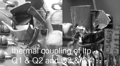

SKA LTP improving thermal stability
Discussing the issue of thermal coupling of the LTPs (Q1&Q2 and Q3&Q4) with Greg Ball, I showed him a pic of my modification.
He suggested to bring it up in this forum.
The difference amplifiers will give a better DC-offset performance when there is a tight thermal coupling between both transistors involved.
Ideally, a double transistor pair would be the ideal part, but these are rather costly. To get the substrate temperatures closer, it is good practice to join the casings with a metal clamp.
I did this with a small stripe of 0.1mm copper foil, to which I added small transversal cuts to be able to twist the excceding length, to get some heat dissipating fins. This in part helps to reduce the problem induced by thermal memory effect (see: http://peufeu.free.fr/audio/memory/ for a good explanation). Inside the coupled parts, I smeared some small amount of heat compound for a good heat transfer. Fixing it with a short piece of copper wire wrapped around or a small cable tie wrapper finishes the work.
A better result can be achieved placing the transistor cases face to face, with their flat sides facing one each other, but this requires either a dangerous twist of the leads or a change in the layout.
stoeffle.

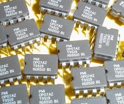

jacco vermeulen said:
People do not seem to mind spending fortunes on exotic capacitors but when it comes to chips even a few quarters is too much.

I wasn't implying to use the opamp i posted. The only one i know of who has this NOS military version opamp is a French retailer that lists it between 15 and 20 Euro.
Those who intend build the GB150 themselves will also find it hard to find a supplier of the BC devices.
An OP07CP costs only $0.50
Fischer produces a TO5 heatsink that can thermally couple a BC duo, SKK510
