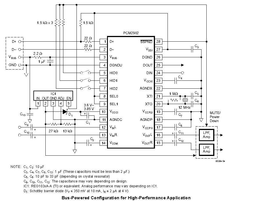

The PCM2902 series can run as a 'standalone' codec chip in USB input/output mode. You don't need to worry about ADC to USB output conversion. That is why I suggested it for a simple interface. There are some codec chips that can do some Digital Signal Processing on board as well but you need to get involved more, like you say with PIC control etc to access the functions.
If you want optical isolation then the S/PDIF with Toslink type optical interface is the standard for that method. You would need a couple of more chips to do that, but the PCM2902 is S/PDIF capable.

PCM2902

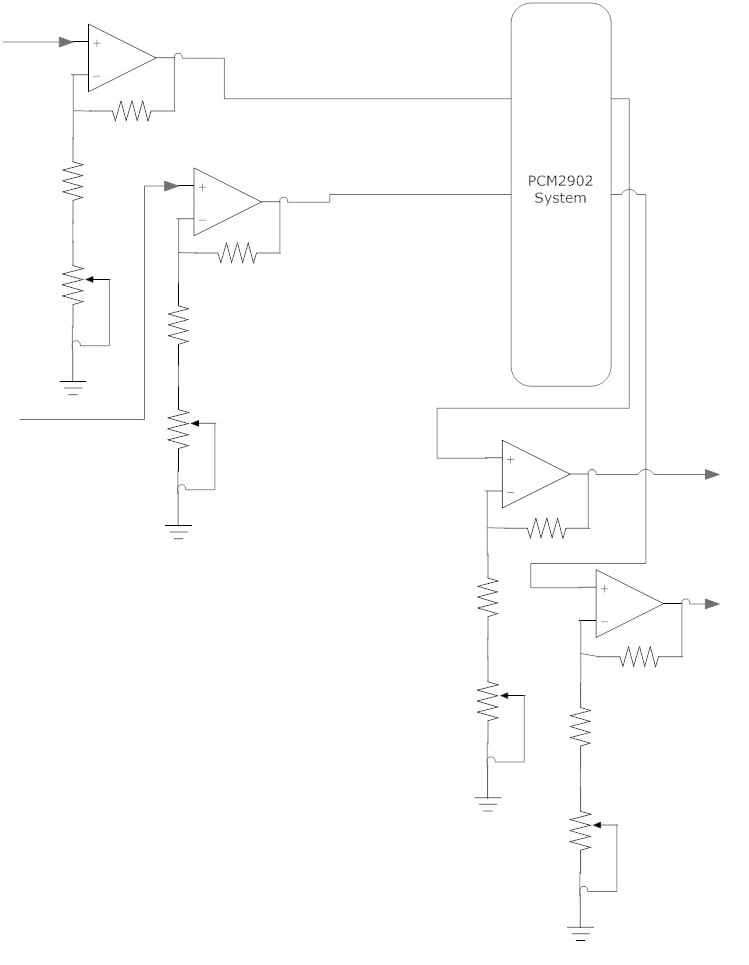

I have copied the PCM2902 ready to use schematic from their manual and connected 2 simple pre amplifiers as well as 2 simple post amplifiers.
The post amplifiers are to be used as pre amplifiers to a pair of amplified speakers / headphones. These can be buffers.
The idea is to have the microphone, the guitar and the PCM2902 with amplifiers on the side where the musician is and some digital cables going to the PC / Digital Recorder. The PC will send the information back through digital cables and play whatever is being recorded through a pair of monitors and / or headphones.
The return may be unused to reduce noise.
All digital should be disconnected from the PC through optocouplers and a separate power supply should be used for the PCM2902 and Amplifiers, not the PC.
For some applications, optocouplers need not be used, the simplified PCM2902 schematic as per the manual may be used and the PCM2902 and Amplifiers can be powered through the USB. I haven't read the power consumption diagram but I am sure this will be well within the limits of USB. This is why they have mede PCM2902.
