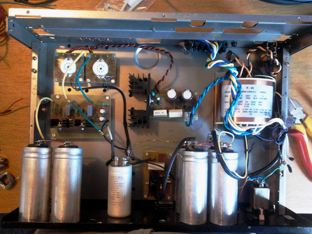

I just finished and tested the power supply.
With a static load of 25ma, ripple is about 2/3 of what was simulated :)
When the rest of the amp is done, I'll test it under dynamic load.

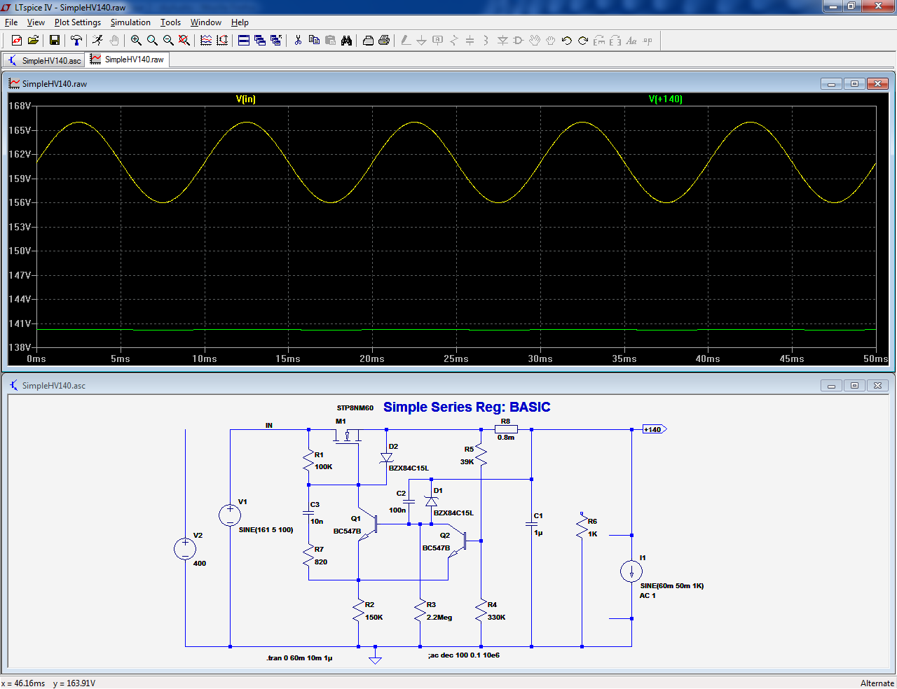

Unfortunately, no: these regulators are intended as adjustable HV regs, the high voltage equivalent of a 78xx regulator, and making them fully variable would pose serious problems and mostly negate their advantage of simplicity/cost/performance mix.
I have described another fully variable supply combined with an original switching preregulator, make a search on this forum.
I also have in my files a fully fledged lab variable supply, but it is a monster having 0 to 700V and 0 to 1A capability, perhaps a bit much compared to what you have in mind.

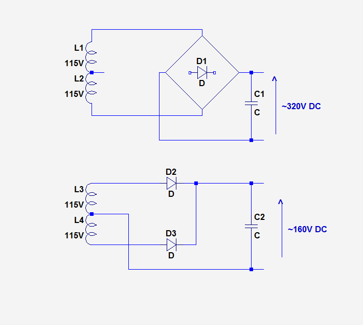

An input of 115V is not exactly plentiful for a 140V regulated DC: it yields ~160V raw DC, if the AC value is exact.
It is sufficient though, and here is an example with the component values adapted.
R1 has been altered too, to take into account the relatively small regulation margin.
If you want to make it adjustable, you can insert a trimmer at the junction of R4 and R5, just as in #14

You have basically two options: use the center tap or not. If you use it, you're on the edge regarding voltage, if you don't, you waste a little more than the power you actually use.
Chose your preferred evil...

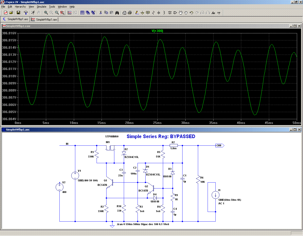

I've been studying your circuits and I believe I understood most of it :) However, one thing that puzzles me still is the compensation parts to the "left". I am talking of this circuit as a reference:
http://www.diyaudio.com/forums/atta...201334-simple-hv-series-regulators-ssrby1.gif
(Bypassed regular version)
I understand that C3 and R10 interact with the mosfet gate charge / capacitance and R1 as well, and I can find empirically values to provide optimum rejection, but I do not really understand how they are supposed to work really and how to calculate them upfront.
Can you, or anyone, shed some light on this?
Otherwise, great circuits, thnx
GR
There is a number of ways to view this network: one is as a shunt compensation in parallel with Q1 which is the VAS, but it can also be seen as a Miller cap viewed from the MOS.
It is connected between ground and gate, but of course the drain and V+ are at the same AC potential as the ground, at least from a loop stability perspective.
For the input ripple, matters are different, which is why it has to be connected to the ground: it not only compensates the regulator but also help rejecting the hf ripple, thus killing two birds with one stone
An interesting attribute of this location for compensation is that there is no additional pole created: the already dominant pole is just reinforced, which means it doesn't have to be as overwhelmingly dominant as if a completely new one had been created

but how do you size the cap & resistor? I found by try & error that apparently the actual values don't matter too much. R1, the mosfet bias resistor plays a much bigger role..
One more question, why do you have to connect the bjts and protection diodes directly to the output node, downstream of R5 (and the "virtual" resistor)? Sorry I am not a psu or HF expert...

Thanks,
You have to estimate the transfer function of the diff amp Q1/Q2 cascaded with M1 in common source (yes, it doesn't look obvious, but that's how it is connected) and make C3 large enough to shift down the curve so that the unity intercept point is in the clean, 6dB/octave section, far from the higher frequency poles; admittedly not an easy task considering that the circuit is somewhat, let's say "involved" and that many secondary effects, including dynamic ones play a role.
You can get a rough idea of a starting point using back-of the-enveloppe calculations, but then it is necessary to use the sim to optimize the circuit.
It does play an important role: it is directly related to the open-loop gain and the low frequency corner
For the protection diode, it doesn't really matter, but for the rest, that is what creates the output impedance compensation: try connecting them the other way round, and you will see a substantial increase of the output impedance
