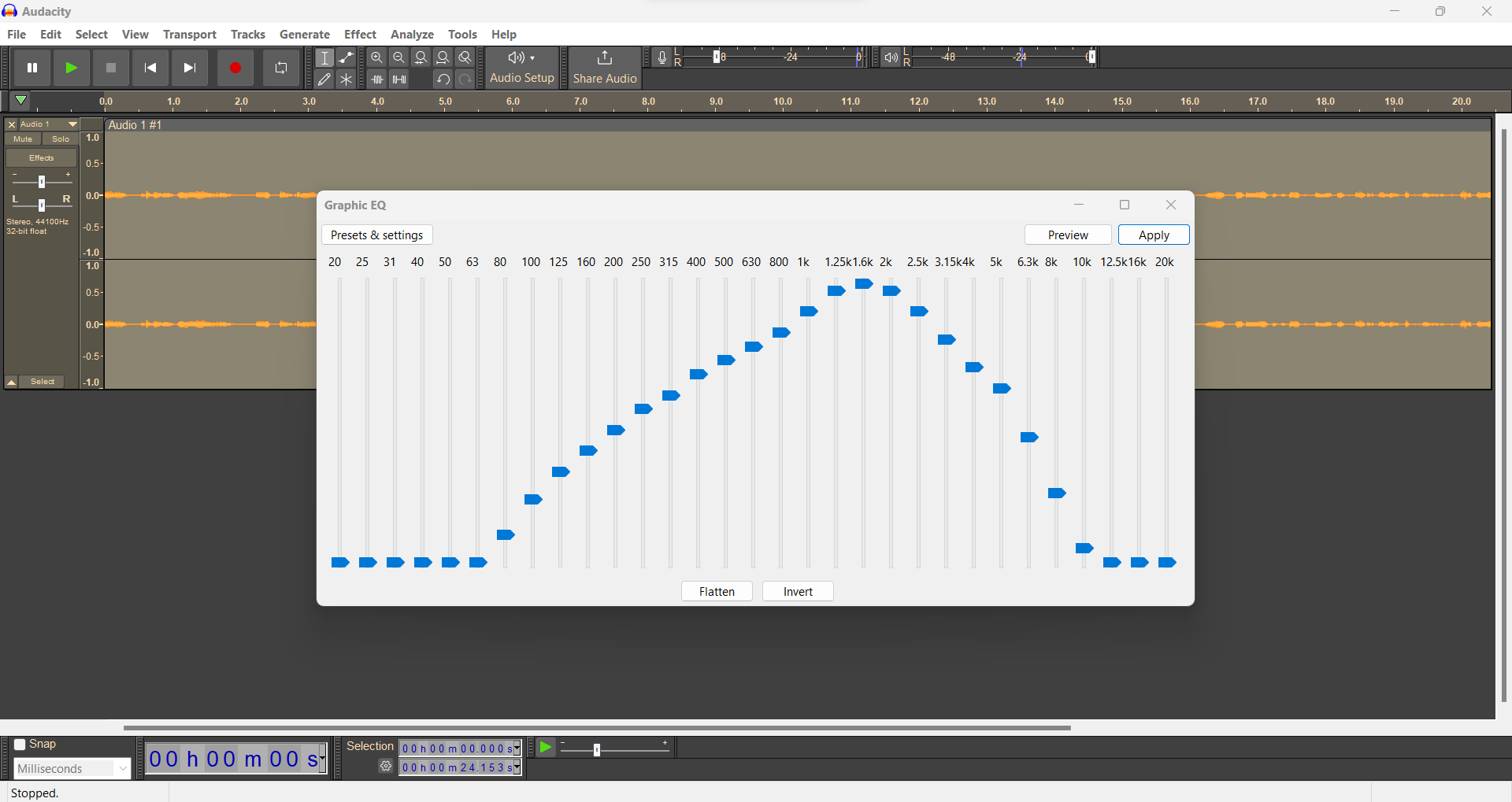

This might give you (or the person) an idea. Two tracks, one original and one modified with the response shown. I just used Audacity to do this. The two 20 second tracks are attached and are MP3 files so should play on anything.
The original was attenuated by around 25db and then the response curve shown applied. Max boost is around +18db at 1.6kHz with everything from the notional centre line cut.
That is really helpful, I am really surprised that the hearing loss goes so low down the frequency range no wonder they lose speech coherence I will ask the chap to do a frequency sweep off YouTube I think there are a number of hearing tests available that will certainly frame the problem for me. I am still keen to include a number of frequency profiles via a dp6t switch so he can select which he prefers. I will be ordering parts for this in the next few days and I will let you know how I get on. Many thanks for the informationVery much so.

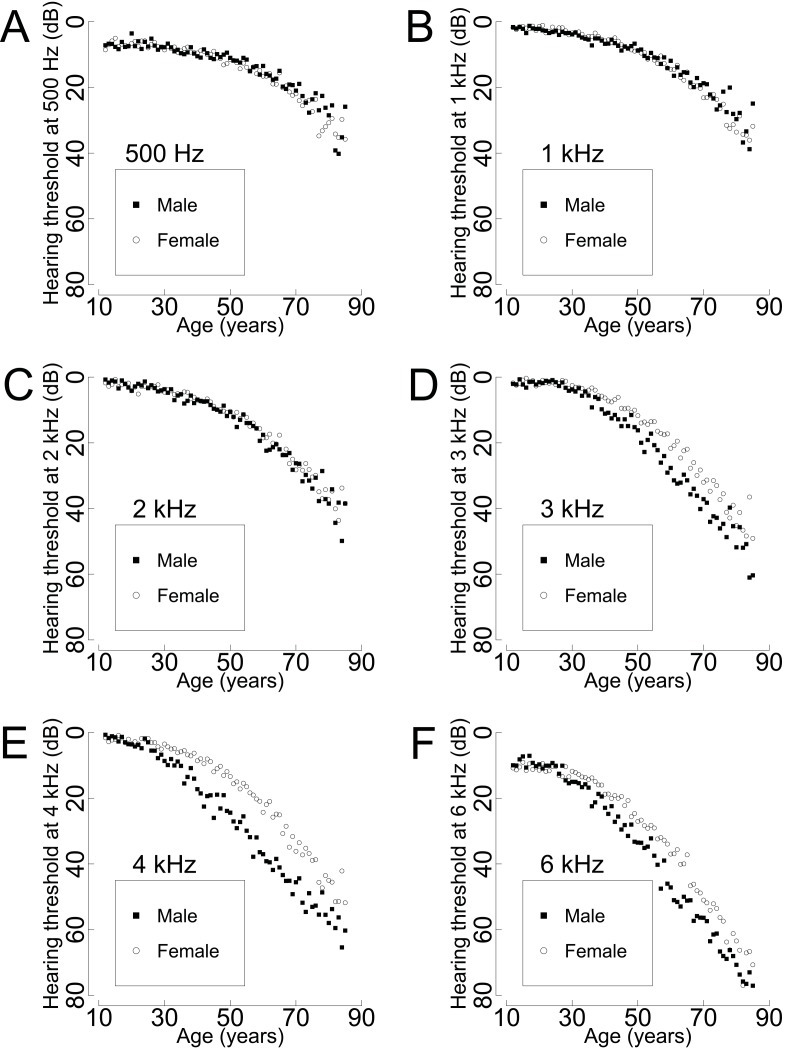

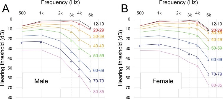

This might be useful, super easy to use, you just click the different frequencies and select a level that makes each sound the same as the reference 1kHz:
http://www.phys.unsw.edu.au/jw/hearing.html
These give an idea of normal age related hearing loss.
