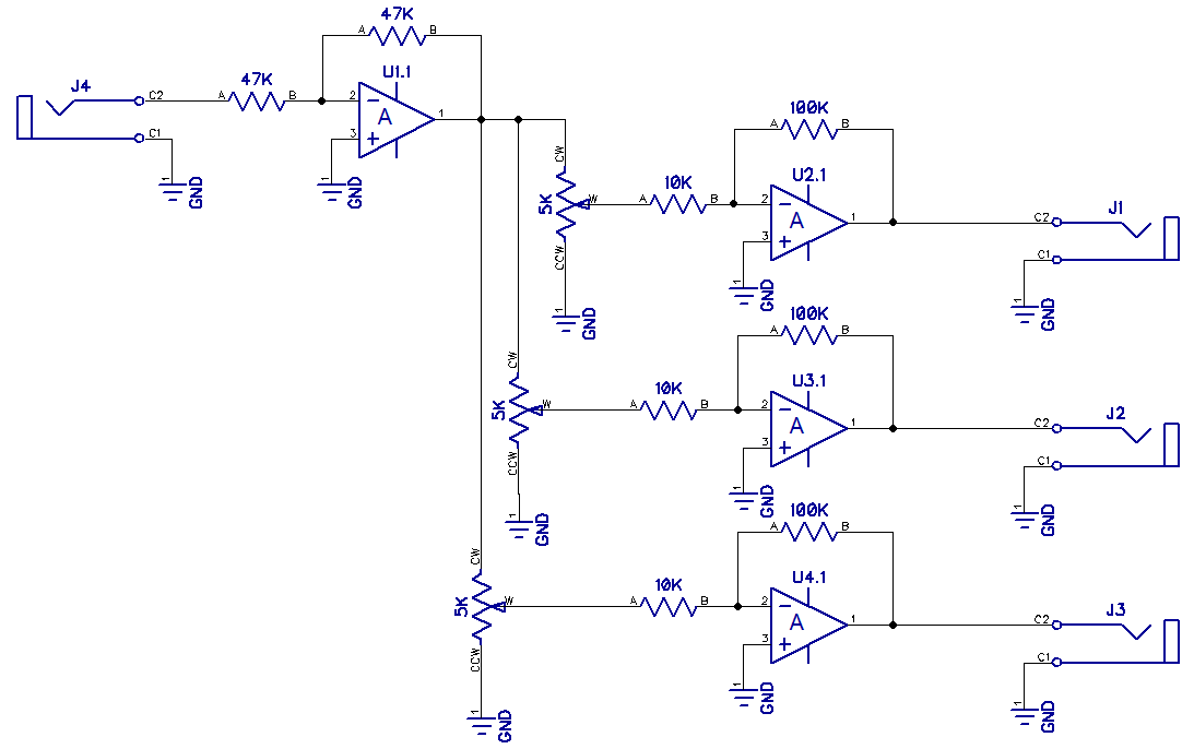

Howdy everyone,
So, I built a simple little headphone distribution amplifier. It's based around two OPA4227's (a lovely chip, incidentally - why do stereo opamps put V+ on the opposite side to Pin 1?). I could knock up a full schematic if anyone wanted it, but it's a pretty standard sort of topology, consisting of:
- An inverting buffer
- Output split to two volume pots, each of which feeds
- An inverting gain stage with a gain of 10
- And finally, the two outputs.
The gain stage needs to be inverting so the volume pots don't interact with each other. The buffer is thus made inverting to restore the original phase.
Those counting will find that I have two opamps remaining, so each of the two outputs was given its own actively driven ground "channel".

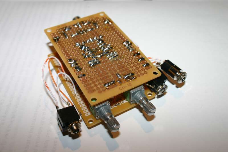

The power supply section is provided by a TLE2426 along with a 470uF capacitor from each rail to the virtual ground.

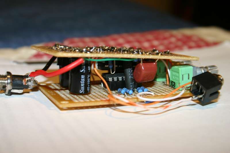

The "sandwich" construction I employed makes it hard to see what's going on, but here's a pic down the side that gives a bit more of an idea.
