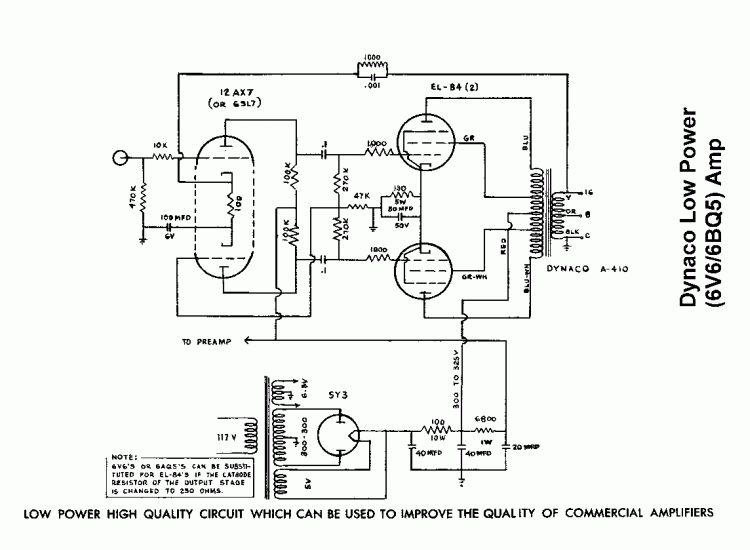

andyjevans said:The one you refer to (dynaco Low Powered) has a 100R cathode R which is in common for both triodes and is decoupled with a 100µF cap.>>
I see 100R between the cathode 1 and cathode 2, with cathode 2 taken to ground through the 100uF cap, so where's the bias resistor for the second section, and in any case wouldn't we expect round 1K?
The DC bias path is via the 1K feedback resistor and the secondary winding of the output transformer to ground.
Can you see it now?

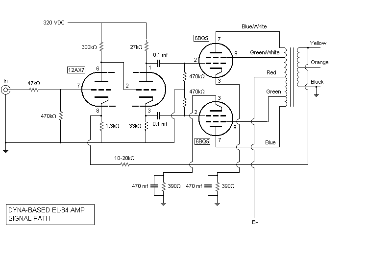

Apropos the concertina in Dyna-based EL84 amp above, why 27k and 33k? I've only seen equal resistors in concertinas? What's the intention? Cheers, Andy
While we're on 'puzzled of UK' why does the concertina in the previous schematic have unequal resistors - first time I've seen that. What's the idea?
Can you see it now?
[/B]
The DC path for both triode sections is common to the 1K resistor and the transformer. The 100 ohm resistor is just in series with it to provide some AC decoupling for the cathode of triode #2 with the cap to ground. This also give a different amount of feedback to the two triode sections.
This type of feedback circuit is very common with equipment that is as old as I am. Back in the old days designers made an effort to get the most out of the circuit without adding more parts but by making what was there multitask a bit.
