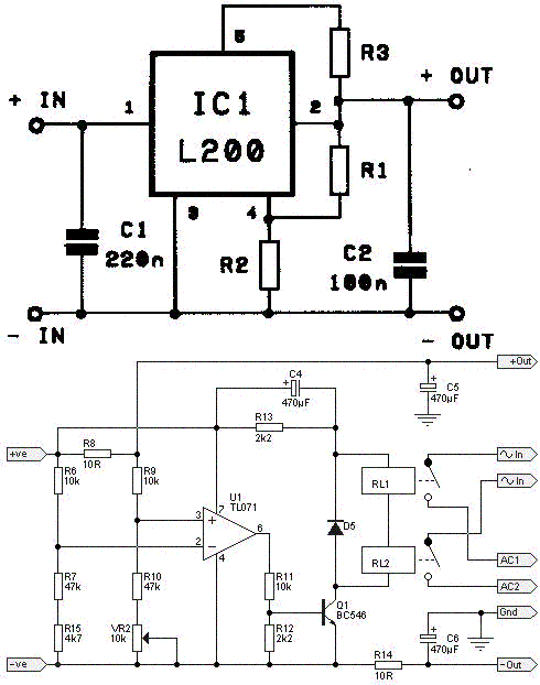

i have built a gainclone amp to run off +/-12v, to go in my car, when i get one.
in the mean time, i want to run the amp off 2 12v car batteries. i want to build a simple dual charger, with circuitry to automatically turn the chrager on and off.
i found these circuits, the first is a circuit using the L200 variable voltage regulator, rated at 2A. is this suitable for car batteries?
the second is a circuit by rod elliot which switches the chragher on and off. does anyone have a better/simpler circuit?
my last question concerns the power supply. i have a dual secondary, 25v, 60VA toroid. the ~35vDC i should get from this is ok for the L200, but the heat dessipation will be huge. i was thinking of putting the secondaries in parrallel to get ~17.5v, which is about what i need. this will only leave me with one supply, between the 2 chargers, which means that the 2 batteries have to be seperated from the aplifier before chrarging. whcih method should i use?

Please note that car batteries are VERY dangerious. This is not something to play with.
1) Incorrect charging of a Led Acid battery may cause it to explode. Boom. Note what flies out of the battery = ACID.
2) Car batteries give off hydrogen gas when charging. Yes, you have a potential Hindenberg here, just add one small spark.
3) The acid which can easly leak out of the tops can disolve your clothes (and skin).
If you must use batteries, use (either) "sealed Lead Acid" or "gel cell" type batteries with the correct charger for that type of battery. Use of the wrong charger can ruin the batteries or worse.

i realise how dangerous car batteries are, but as i am going to have to buy two when i put the amp in my car, i though i would buy them now, and use them, rather than building a huge power supply. a PSU would cost ~£100, and i dont have this money. i have ~£50, which will get me 2 car batteries.
do you think i should buy a charger (or two), instead of making one, or are you 100% against the use of car batteries?

Leave the two batteries in series and charge them to a total of 28.4 volts. (14.2+14.2 volts). 35v regulated down 28.4v is a bit nicer for your regulator than down to 14.2v.Matttcattt said:I have a dual secondary, 25v, 60VA toroid. the ~35vDC i should get from this is ok for the L200, but the heat dissipation will be huge. i was thinking of putting the secondaries in parrallel to get ~17.5v, which is about what i need. this will only leave me with one supply, between the 2 chargers, which means that the 2 batteries have to be seperated from the aplifier before chrarging. whcih method should i use?
BTW, car batteries in particular the low maintenance kind have a somewhat different chemistry than the sealed and gel cell type e.g. they have more antimony in the lead grid to lower water loss. Translates into higher charging voltage. Sealed and gel types usually charge at 13.65 volts.
is it safe/a good idea to chrage both in series? i had not though of this. thanks for the idea...
If the car battery has a capacity of 40 ampere hours (fairly common size for ~3 litre engine) then 2 amps will charge it in about 20 hours.
Actually, it's not a good idea to deep discharge car batteries because the lead paste in the squares of the pure lead grid swells up and when it contracts upon recharge it pulls away from the grid and ceases to make electrical contact so the battery capacity gradually decreases till it fails. OTOH, car batteries are dirt cheap compared to deep cycle ones so just do whatever you like and big deal!
Circlotron said:If the car battery has a capacity of 40 ampere hours (fairly common size for ~3 litre engine) then 2 amps will charge it in about 20 hours.
so a 1A charger will charge 1 amp in 1 hour? 20 hours is a long time but any current will charge them in theory? or do i need a certain amount as a minimum?

1) you can use 2 IDENTICAL car batteries BUT remember they won't last long if you discharge them deeply; if you do this, at least charge them as soon as possible (they don't like to be kept discharged!)
2) Don't build a charger; building one is surely not so easy as someone told you! Battery chemistry is a complex thing, be wise!
I give you a small example: you set the voltage regulator at 28.4V but you can't control the intensity of current (Ampere) your battery can draw (depends by battery and state of charge) while charging; you can easily burn out everything.
buy a car battery charger (even a slow one is OK and it's very useful) and charge as the manual recommends;
3) For safety reason the only way to proceed is to use ALWAYS the 2 batteries as 1 only battery; I mean they should be charged/discharged at exactly the same time/amount; this is because you want to have the 2 batteries always with the same characteristics. I suggest charging them in parallel simply beacuse commercial chargers are usually rated at 12V (the charger will "see" twice the capacity in Ah of the single battery).
4) Be extremely careful using these batteries: do you know that a single car battery can easily give out ~ 400 A of current if it is short-circuited?? you know how much amout it is? So always double check and secure all wires and connections and, if possible, unplug the batteries and cover the connectors if nobody could look at them.

1) i have been told this by everyone. i dont want to risk damaging them, so i am not going to dischrage them anywhere near fully.
2) i have looked at the price of car battery chargers, and i have desided it would be easier and safer to buy one.
3) i will be ok to charge them in parrallel?
4) yes, i know the short-term output of a car battery. i have seen a spanner melted by touching both terminals of a battery.
5) i am going to put the two batteries in my car (when i get one). i will have to take them out to charge them though.
