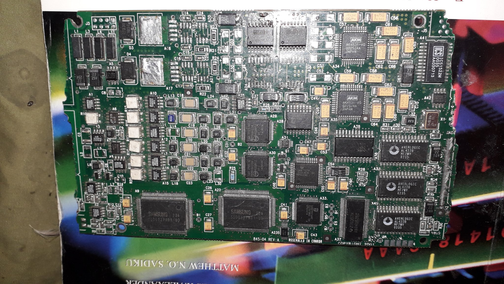

Built this with drv134 back in 2012...Really cool amp at the time.I had some akg 600 ohms headphones back then.I might want do it again as i still have some smd drv134 chips from a scraped sound card.

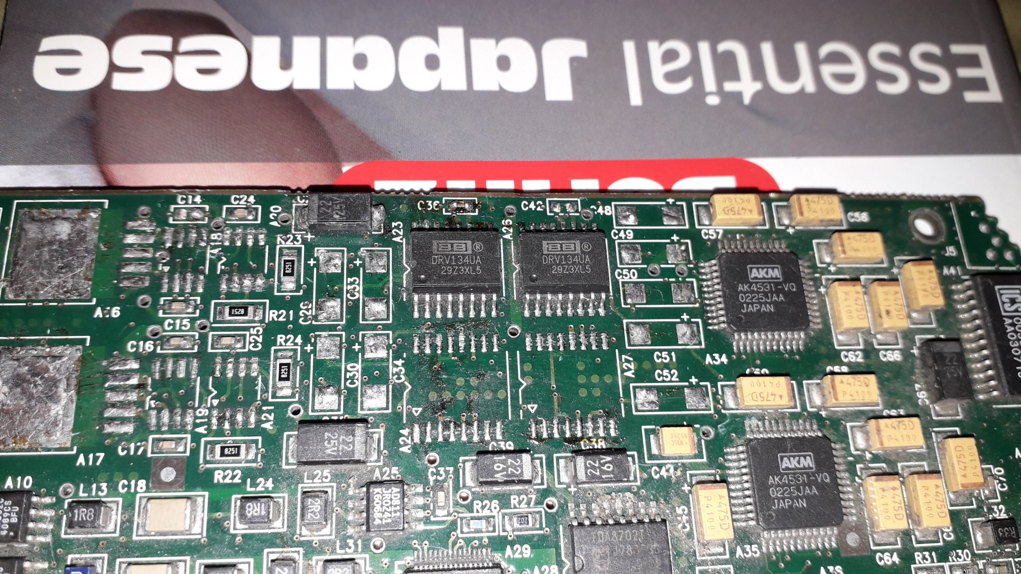

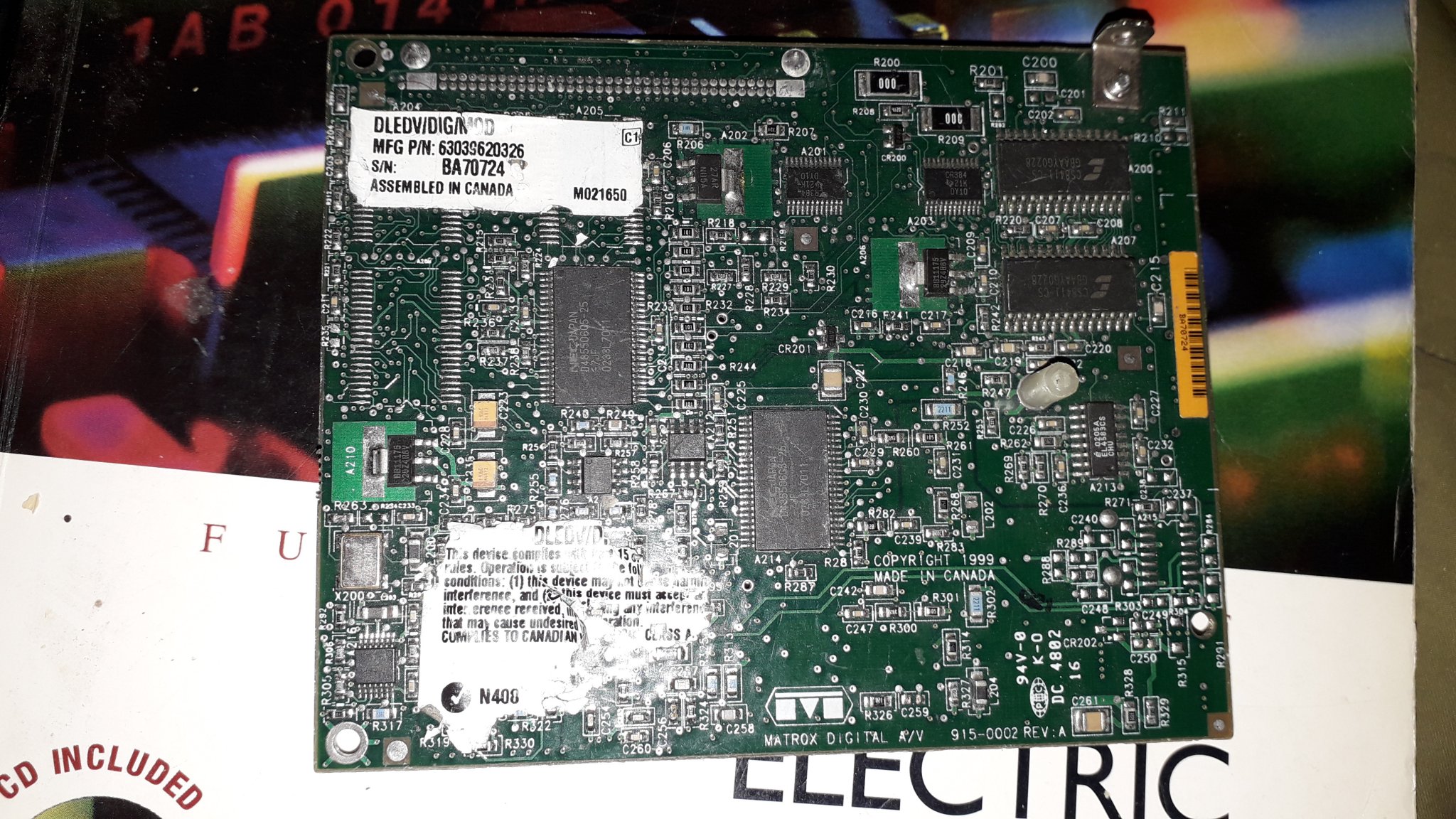

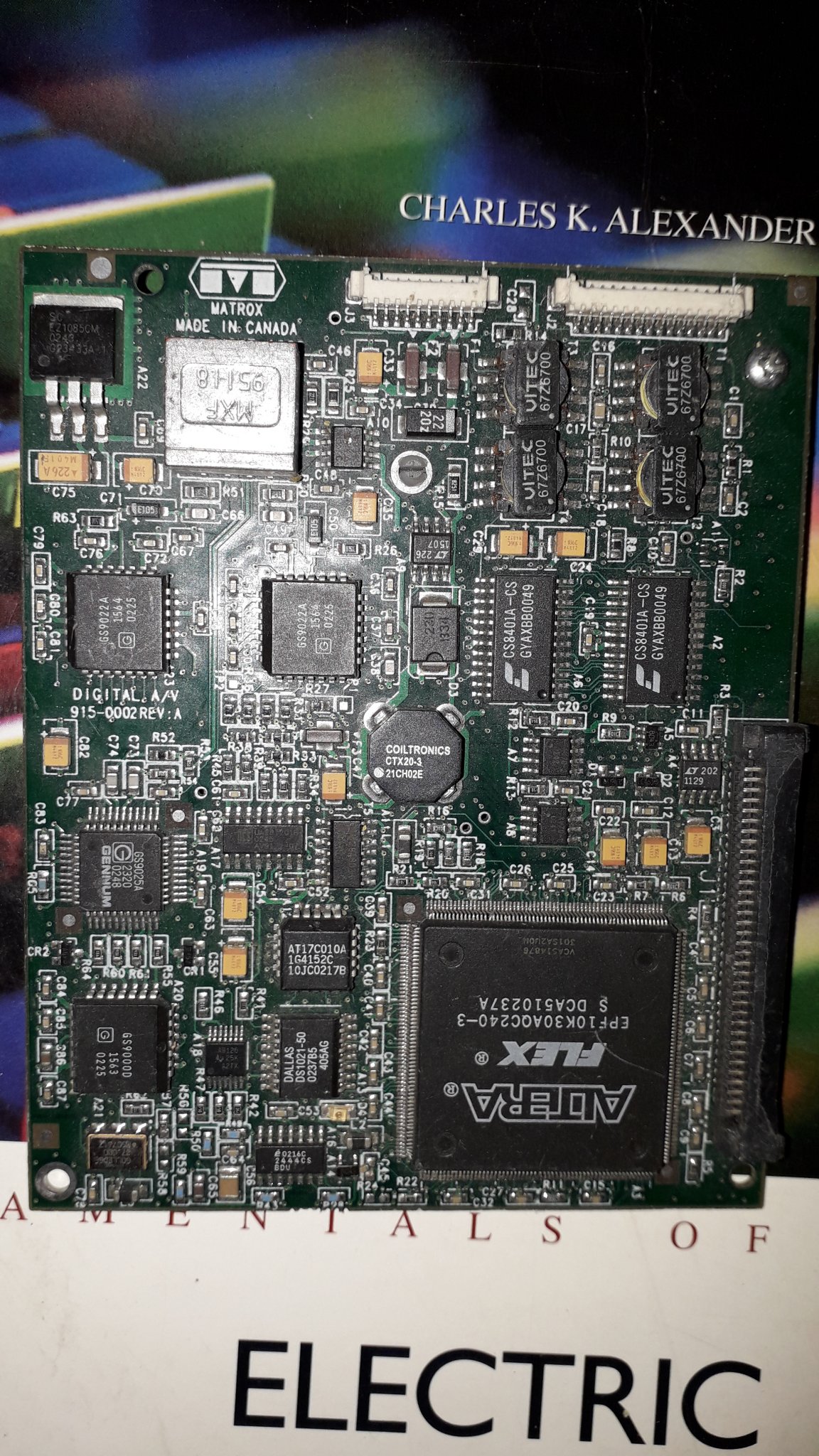

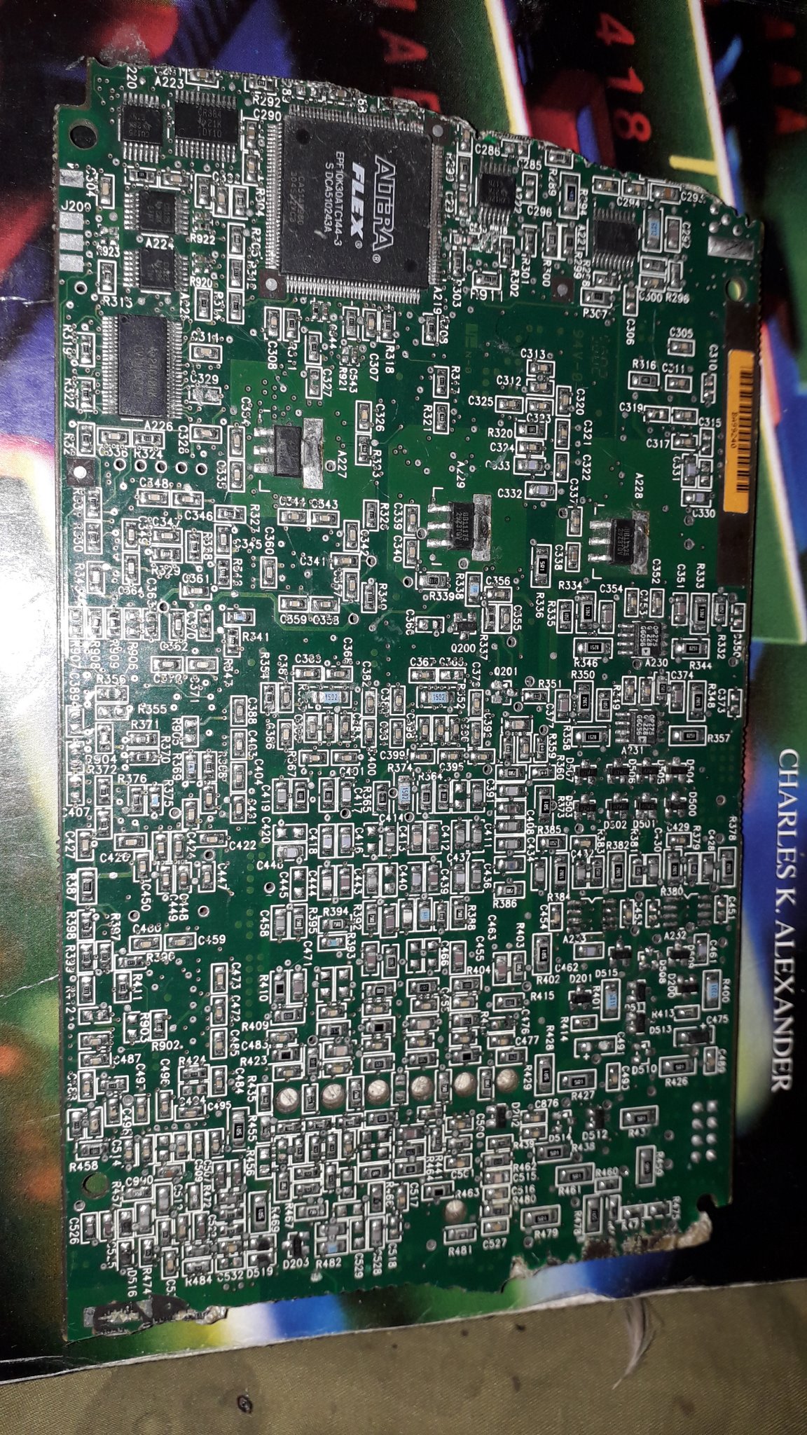

I can't exactly remember what it was, but certainly no soundblaster...It was part of a professional two compound video + sound editing tv station rendering card, basically 2 cards of 30/10 cm size .I will look for the whole thing and tell you if i find it.I think it was something canadian...
Thanks, I didn't think that it was, based on some of the chips I saw in your picture. I was just curious, so no hurry.
Account Closed
Joined 2010
This was just half of the audio board which had some of the video processing on it too...ad811 , ad 828 op275 op-amps, ssm line drivers snd receivers...top of the line 2001 soundcard.the removed components were just some voltage regulators , two drv134 drivers and some ssm line receivers i used in a headphones amp made in 2012 that i gave later to a friend in 2015.
