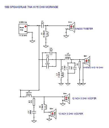

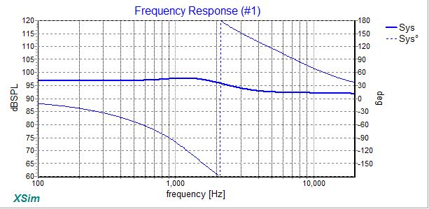

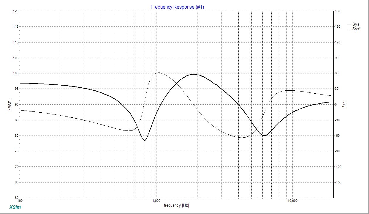

I've done a sim for a 1980 Speakerlab 7WA DIY kit. There's no zma or frd files. The plotted FR shows some severe dips at the xo points. Shouldn't the FR's be summed at the xo points for a smoother response? The schematic matches what the Speakerlab engineers worked out back in the day.
Let me know what you think.
