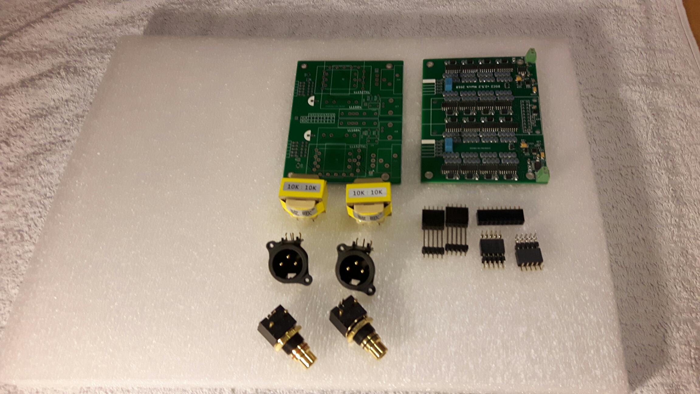

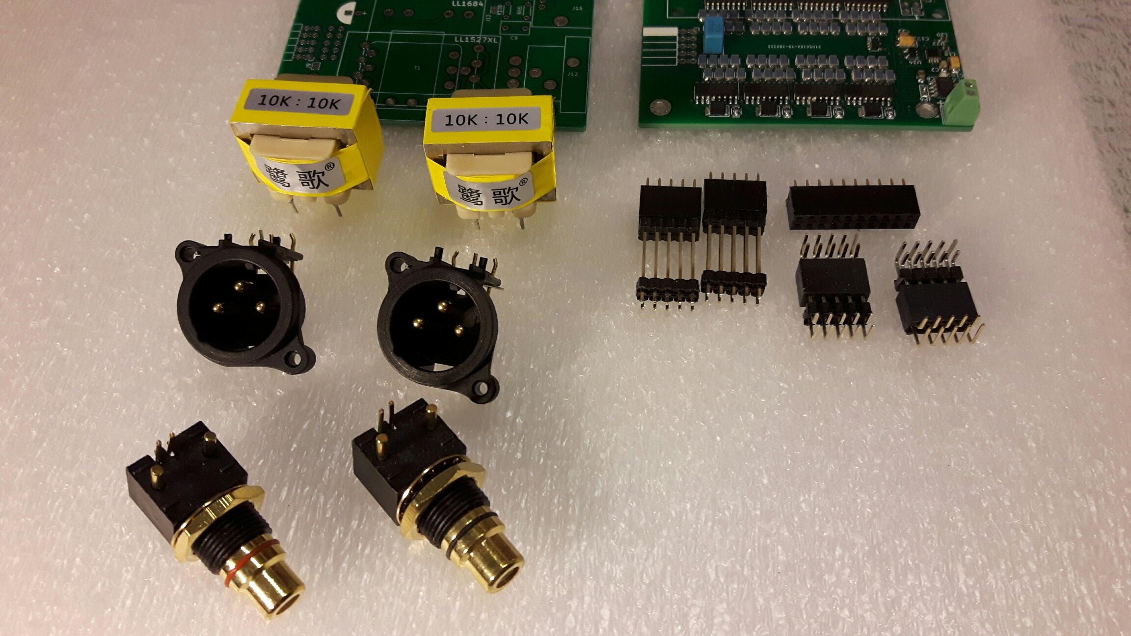

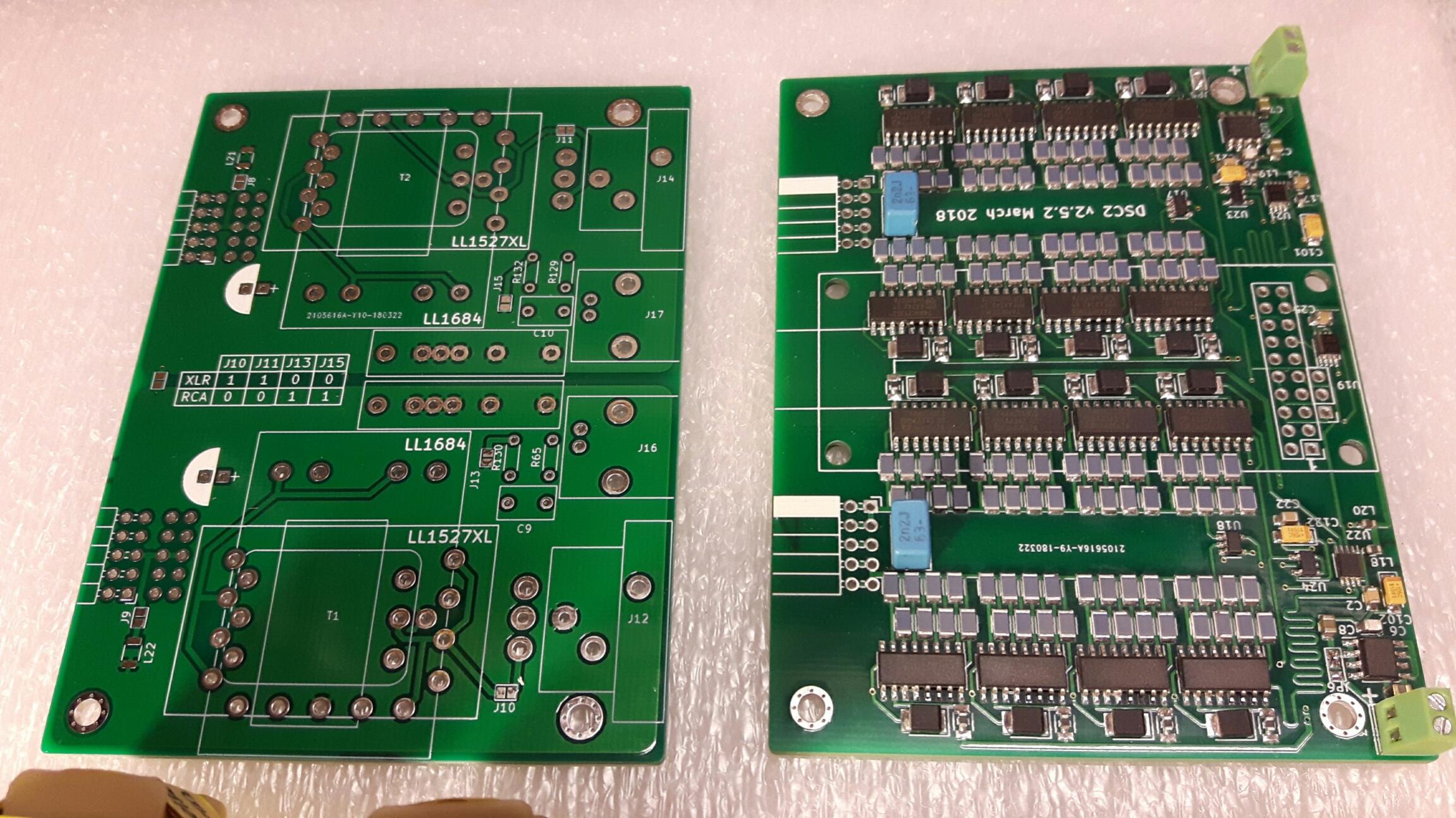

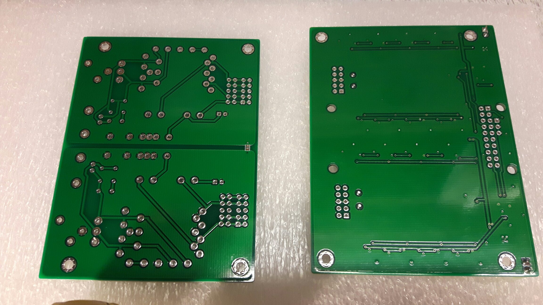

For sale DSCV2.5.2 complete
For sale DSCV2.5.2 built by Pavel, unsoldered end-stage, with original Chinese transformers. It is in the orginal state as delivered by Vit. Located in Europe. I am selling due to time constraints.
