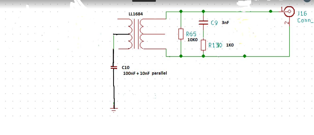

Vit, can I just confirm that the attached sketch is correct for the recommended output stage configuration when using Lundahl LL1684 transformers. Thanks.

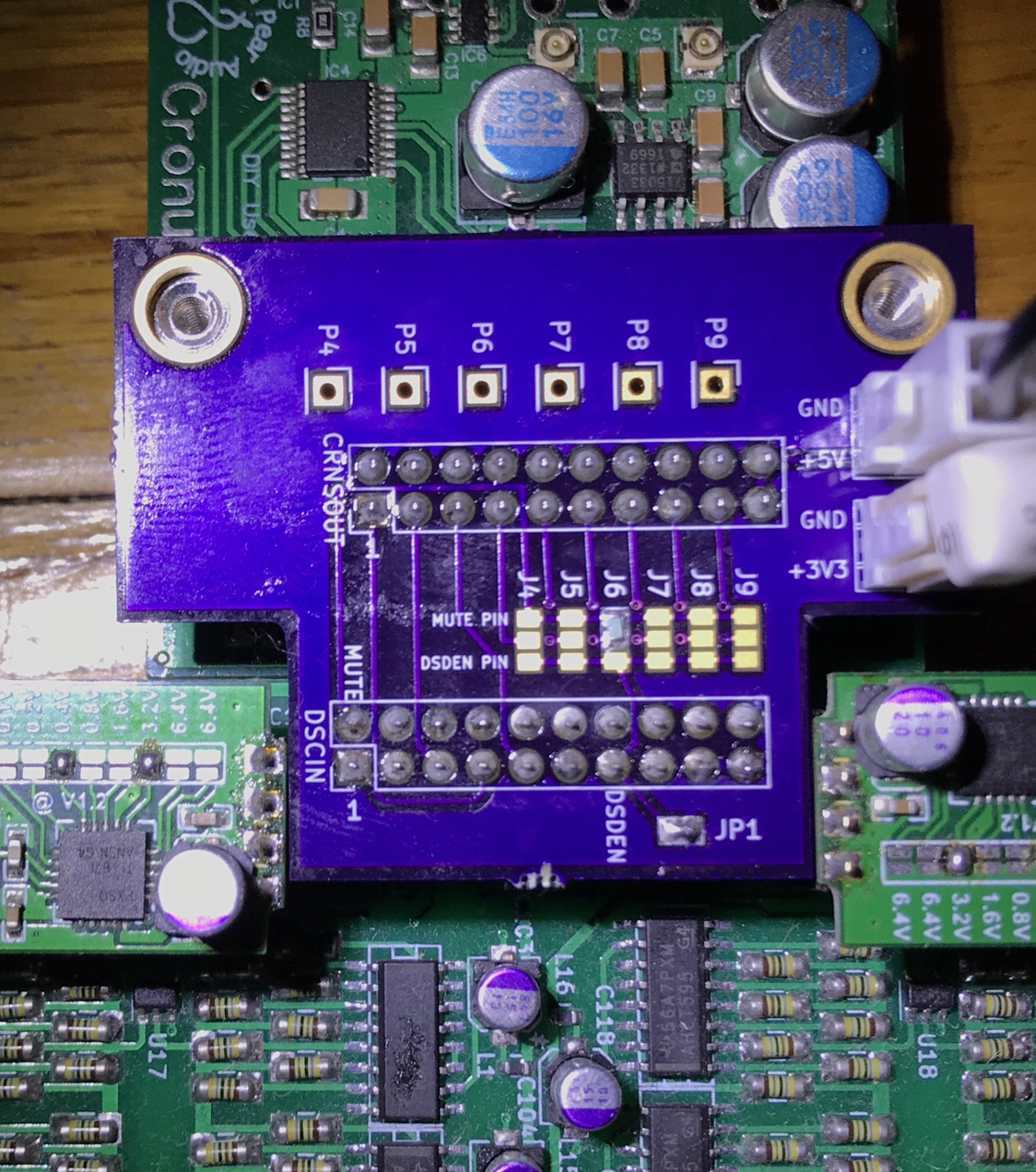

I also ordered 6 of those at OSHPARK:
Cronus - DSC1/2 [Amanero] Header adapter
When I receive and test them and all works fine, I can send the excess to members here.
This is my first PCB project, so comments are more than welcome.
Received the PCBs today and hooked one up. Works like a charm.
I even feel it improved SQ. But that is in the subjectivity area.
Nevertheless- quite happy!
I am on going to build the DSC2 with pre-amp stage.
Thanx
