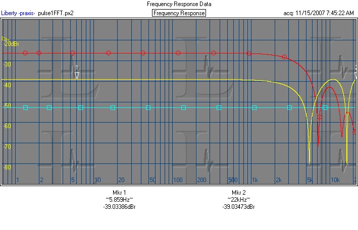

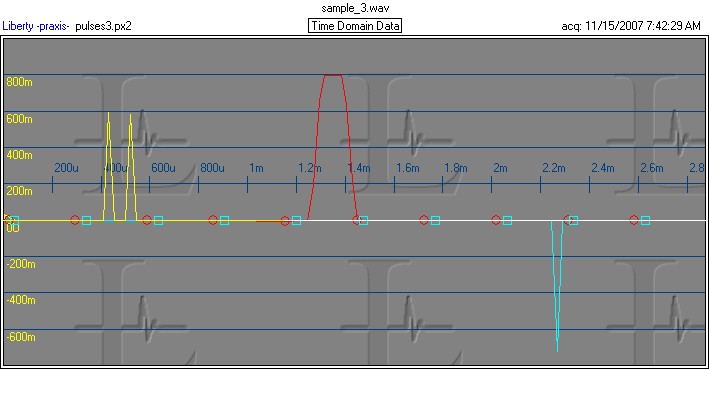

Just to show what is audible. Try the attached file. It contains 3 impulses, in left channel. 1st contains 2 samples. 2nd contains 8 samples. 3rd contains just only one sample. All of them are audible. try your impulse response.
OK, Here are plots of your 3 'impulses'
-- Time domain (I zoomed in on each and overlayed so detail can be seen:
And here are the spectra of the three 'impulses' (frequency domain), overlayed.
1) the wav file is sampled at 44.1kHz
2) the energy at low frequencies is as strong or stronger than at highest frequencies.
Why would you expect any of these to NOT be audible? There is every reason in the world why they should be. I guess I'm not seeing your point.
Everything has already been applied. This is the analog output spectrum.
Sensitivity curve of ear applied too? Not of my ear, at least! I can't hear ANYTHING at 20kHz at any level I can produce with 100W and a horn tweeter.
you want to be careful when you say rolloff of the ear.
Why? Do you mean that the ear's sensitivity isn't rolled off at high frequencies??
