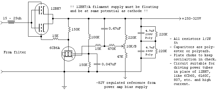

Here's my tube reg (based on the one by Steve Bench). No shunt ones on "paper" though.

Why 2 bx's parallel, to lower the impedance?
I will use one EL84 for the whole Stereo pre-amp, the space is limited, transformer also (2 * 8V AC 1.5A and HT) Don't want to change everything.

Hi Tubee,
tubee said:
Thanks for the regulator scheme Geek.
Nope, just extra plate dissipation. You could use a 6AQ5 or 6BQ5 in there tied triode, or tied pentode with extra filtering on g2 for superb ripple reduction.
I just had a box of 12BH7's, but few little power pentodes at the time ;)
If you don't have a zener regulated bias supply, just drop your zener or VR tube in the 6CB6A cathode and ground the divider resistor.
One caveat - use 6CB6A over 6CB6 - warmup time of the "A" is faster and you won't have a few seconds of full unregulated B+ on your circuit like you would with the 6CB6.

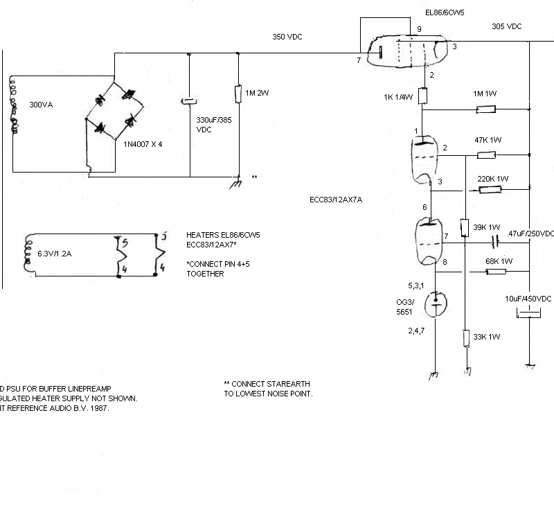

A few years ago i found somewhere on the internet a shunt with a EL84, i made a drawing of it on paper. Yesterday i found the drawing again, redrawed it on the pc. Don't know from wich site it is, and don't know the part values either. Maybe with a tube-simulator the right parts could be determined. The shunt is regulating after a resistor in series with supply line, with a cap ofcourse.
  • el84 shuntsupply.pdf
