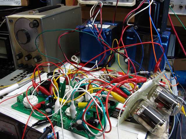

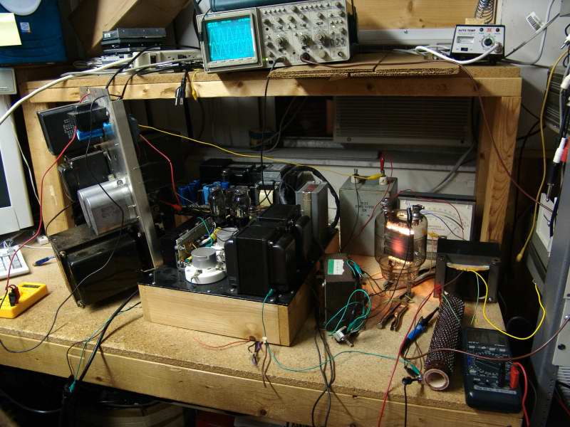

!!!! DUAL DRIVE IS ALIVE !!!!
After blasting the screens out of a pair of 6BQ6GT's nearly 5 years ago I believed that driving only the screen grids in a demanding application would blow them up. Experiments proved this to be true.
A few years ago I made a little test amp that showed driving G1 and G2 simultaneously might cure this failure mechanism. After several years of dreaming and drawing paper amps, I have finally seen the light......uh absence of light...That's right MIND BLOWING POWER flowing with nothing glowing????? Could this be right, Kaptain Kilowatt is hungry, hasn't been fed in years and nothing gets blown up. Well, I did melt the solder on a resistor a few nights ago. SO, here's the deal.
I wired my driver board up to a pair of 6CB5's. I put all the good OPT's far away from this thing, and connected up a sacrificial test transformer that I got for $16. I connected the 16 ohm secondary to a Dale Precision 1% 8 ohm resistor......
I turned up the drive until clipping just appeared. Distortion was 4%.Power Output was 180 watts The amp ran at this level for several minutes. Then I turned the audio generator up 10 db beyond clipping. No smoke, no glowing grids, just 299.9 watts.

Would be interesting to measure the grid2 current at the max power levels and the peak g2 volts, and the minimum plate to cathode volts at max current. Is g1 setting at zero volts bias, or something negative?
It was late last night and I neglected to write down some important numbers. Sadly I won't have much time to play with this for about 2 weeks. Some important stuff that I did write down:
For initial power up I set the bias to well below cutoff (both grids negative). There is one pot for each output tube that moves both grids together. I turned it up until there was 5 mA per tube and applied signal. Crossover distortion was visible at low power. I applied enough signal to get 1 watt output and tweaked all the pots on the board to get minimum distortion. It was about 0.5% at an idle current of 15 mA per tube. Distortion at 180 watts was 4.79%.
The schematic of the driver board is here. It uses 3 power supplies not counting the 6.3 Vac. As it is now, each is connected to a variable bench supply. The connector in the upper right on the schematic is B+/-. Pin 1 is connected to a negative voltage source, currently set to -80 volts. Pin2 is ground, Pin 3 is the B+ supply to the drivers and screen mosfets. It is set to +350 volts. Just to the left of it is the B++ connector, it goes to Kaptain Kilowatt which is set on 600 volts.
The output stage is not shown but is real simple. Pin 1 of each OUT connector goes directly to the screen grid of the output tubes. A 10 K resistor goes from G2 to G1 and a 2.5K resistor goes from G1 to the B- supply (currently -80 volts). There is a 10 ohm resistor fron the cathode to ground, and an OPT from each plate to B++. The OPT measures 50 ohms DCR in one side, and 60 ohms in the other.
This itteration idles with G1 at -30 volts and G2 at 150 volts. At 180 watts output G1 swings from -60 volts to 0 volts and G2 swings from 0 volts to +300 volts.
The idle current for the +350 volt supply is about 80 mA. About 50 mA of this is also flowing through the -80 volt supply. When the amp is cranked to 300 watts of square wave output, the 350 volt supply reads about 140 mA. I didn't check the negative supply. Some of this is eaten by the driver tubes, but I'm guessing a lot of it still goes into the screen grids.
The B++ supply feeds the driver plates and the output tube plates. Its meters read 600 volts and around 450 mA at 180 watts output. The drivers eat about 20 mA each.
There is a voltmeter across the 10 ohm resistor in each cathode. They just over range (LCD goes blank) on the 2 volt scale at 180 watts. This looks like about 400 mA of combined tube current at about 590 volts. This looks like about 76% efficiency. It's probably a little better since screen current is being measured too.
No attempt was made to optimze anything, or even turn any knobs. Clearly there is more to be done, but it is a good start so far.
My test apparatus will look a bit prettier,
Hey, this is one of my better looking prototypes. It's going to wind up in the trash when the real amp gets built, so.....
I added a picture of another one of my prototypes. Yes there is a working HiFi amp built with clip leads and a dead SSE board.

Frankentube is the big one in the background, the mighty 833A. That's a 12AU7 in the front. It was originally designed for AM broadcast transmitters. I put together a little prototype guitar amp using one in SE. Check out the hose clamp and vise grip tube socket! It cranked out 200 very loud watts from 1500 volts, which flows through the yellow Radio Shack clip lead! This amp existed for about 10 days 6 years ago. It survived my guitar playing for several hours only blowing the 15 amp bench breaker twice. I still have a few tubes and an OPT and PT for that guitar amp, but would I ever use it?????
Tony has been waiting patiently for a long time for me to test the "little tube" in the foreground. I will get to them.....

I powered the amp up and tried turning knobs on the power supplies. Increasing the negative voltage supply lowers the voltage on G1 in the 6CB5's this allows more drive before grid current happens, which allows more power, but causes G2 to be driven higher......which causes the dreaded screen grid glow of death. Glow comes on quickly and BRIGHT. This is how I blew up a 6BQ6GT, so I was being very cautious. The edge is 215 watts, at which point the distortion is about 4%, but glow appears rather quickly at 220 watts. During the experiment I smelled something burning so I killed power. It turned out to be the load resistor. The OPT was hot from conducted heat. Time to get the big resistor. I tried other combinations of power supply voltages, but haven't yet ventured beyond 600 volts of B++, but 215 watts seems to be the limit.
So it's still possible to melt a screen grid, but come on, 200+ watts from a pair of $2 tubes.....Maybe I will just set the B+ to a safe value of 275 to 300 volts and call it a 150 watt amp. The big Edcors going into the final amp are only rated for 100 watts. Kaptain Kilowatt goes to 650 volts, so maybe I need to turn that knob????
