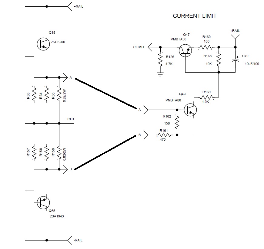

Listen I am using a micro. With it you can do what ever you want. You can shut down the amplifier with any abnormality you want. You can shut down the AC for high heat sink temperature, high voltage speaker output, high current in the Speaker, speaker shorts ,visual or audible alarms etc etc etc etc. I am not trying to force you to use it. I am trying to let other diyAudio members that the used of a micro can help them a lot in their design.
This is an example.
You sense the current in the emitter resistor to turn-on Q49.
Q49 pull down Q47 that goes on conduction.
If Q47 is powered by +Vrail, you have a 0 --> Vrail signal
If you power Q47 with +15V, you will have a 0 ---> 15V signal
Q49 will turn on with about 0.7V of Vbe. So the R161/R162 will be calculate for you rated maximum current and emitter resistor.
For example, if you want a protection at 10A, with 0.1 emitter resistor, it will be a 2V dropout on AB points.
So, to reduce 2V to 0.7V you've to calculate R161 and R162. If you get R161 in fixed value (for example, as the draw, 470ohm) the formula is:
0.7V = 2V * R162 / ( R162+R161)
so you have to invert the formula to have R162 =

for multiple output transistor, the schema is similar but the current sense is made in each complementary pair (in my schema there's only 1 complementary pair) via 22ohm resistor.
1000W at 4ohm are 15.8A (i think that the 1000W are RMS, so current is RMS). 15.8Arms are 22-23A peak.
So, for 12 pairs you've to divide by 12, so less that 2A each pair.
2A in 0.47ohm resistor create a voltage drop of 0,94V.
So you've to reduce, with R162, the voltage from 0,94V to 0,65-0,7V
..and you've an overcurrent protection.

The transistor (Q49) will start to turn on when it's Vbe rises to ~ 400mVbe.
That turn on point should not interfere with the passing of a valid audio signal.
If it turns on earlier than not interfering with a valid audio signal then you are not passing the music you are supposed to hear. The current limiter has then failed in it's primary purpose - to let you hear the music.
To stop you blowing up the amplifier is not the primary purpose. Otherwise you could simply never turn the amplifier on. Music is the primary purpose.
