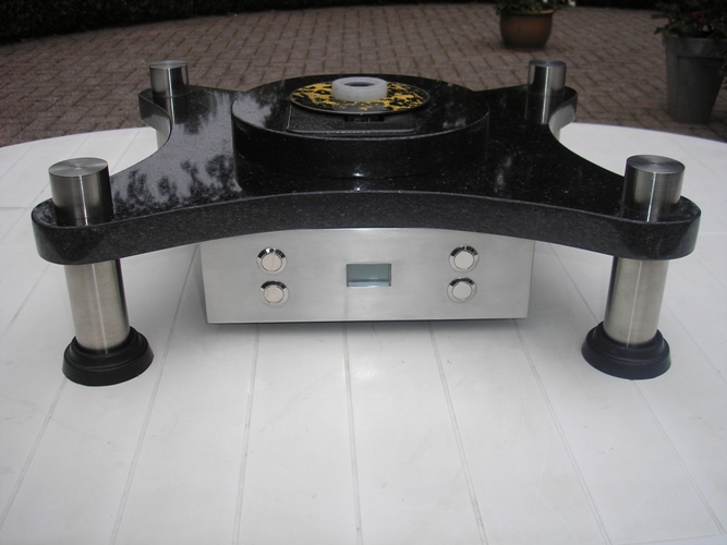

Here you have my Shigaclone.
Rudy

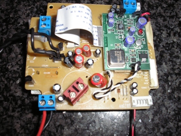

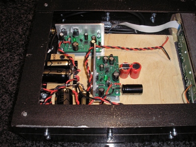

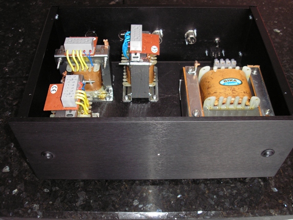

This is the power supply for the shigaclone and the DDDAC.
OPEN-CHASSIS TRANSFORMATOR 100VA 2 x 9V 5 volt for the Shigaclone board
OPEN-CHASSIS TRANSFORMATOR 100VA 2 x 12V 8 volt for the trichord clock 4
OPEN-CHASSIS TRANSFORMATOR 100VA 2 x 12V 8 volt for the 2 CD motor
OPEN-CHASSIS TRANSFORMATOR 500VA 2 x 12V 12 volt for the DDDAC.
1 ALWSR+ B&T ALWSR +5v Built & Tested Regulator - Shigaclone Board
1 ALWSR+ B&T ALWSR +8v Built & Tested Regulator - Trichord clock 4

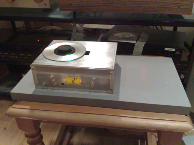

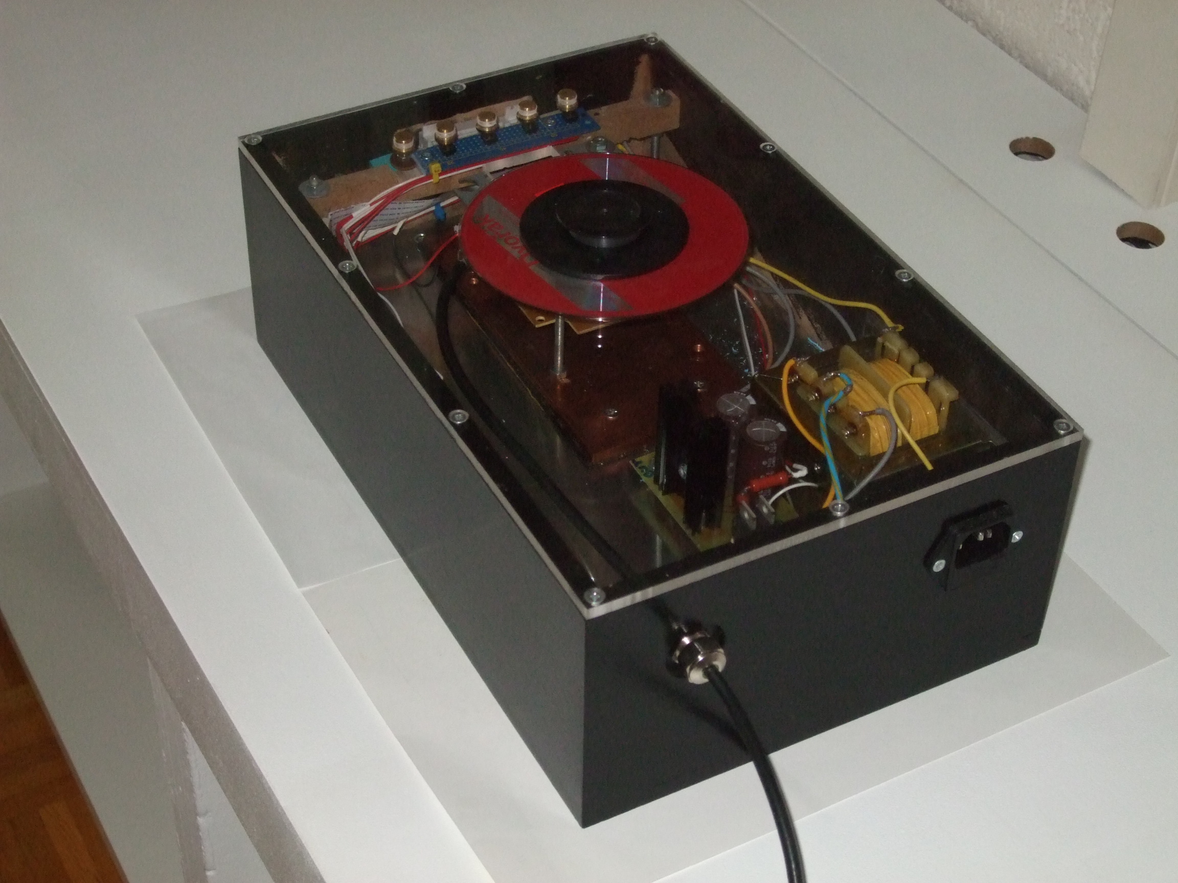

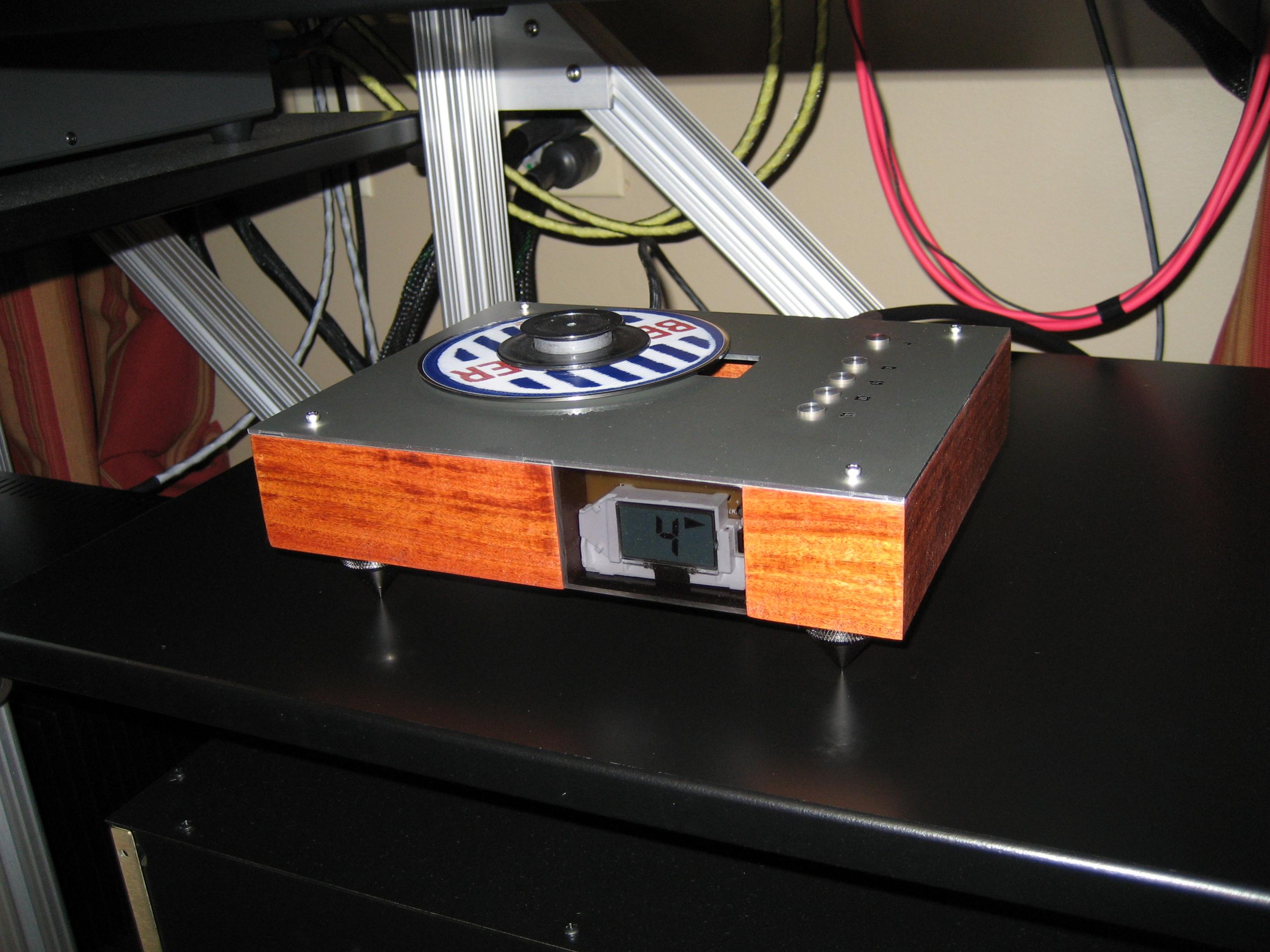

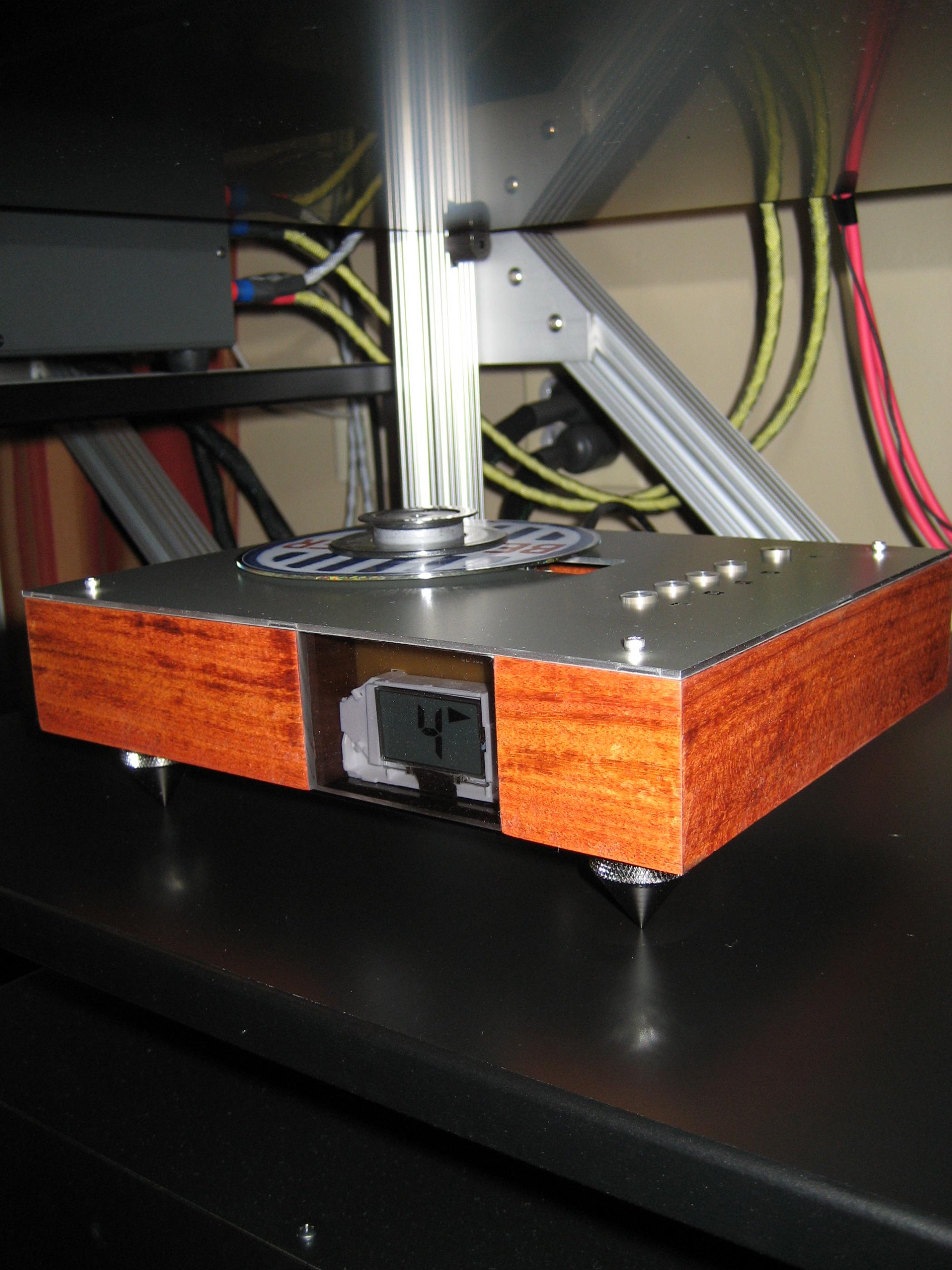

Hello all,
After lurking a long while, I've finally started working on a Shigaclone following Peter's advice. Here's the result. Not as beautiful as some of the masterpieces, but decent for me and singing from the first time !
There's room for improvement. The clear acrylic needs to be matted. The NC door switch needs a better one. The caps are Elna Silmic II, since I couln't find BG for a decent price.
Thank Peter and all the contributors. The shigaclone is a real pleasure.
Stephen
