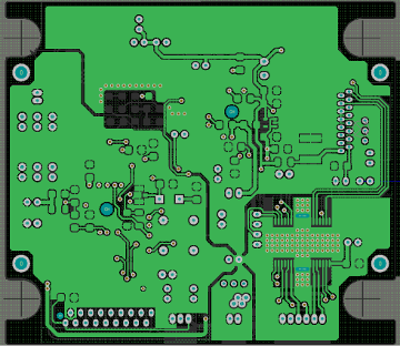

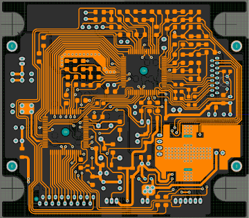

Do I see a shield near LA9242 pin 41?
Yes, it is a shield plane between LA9242 pin40 and pin41.

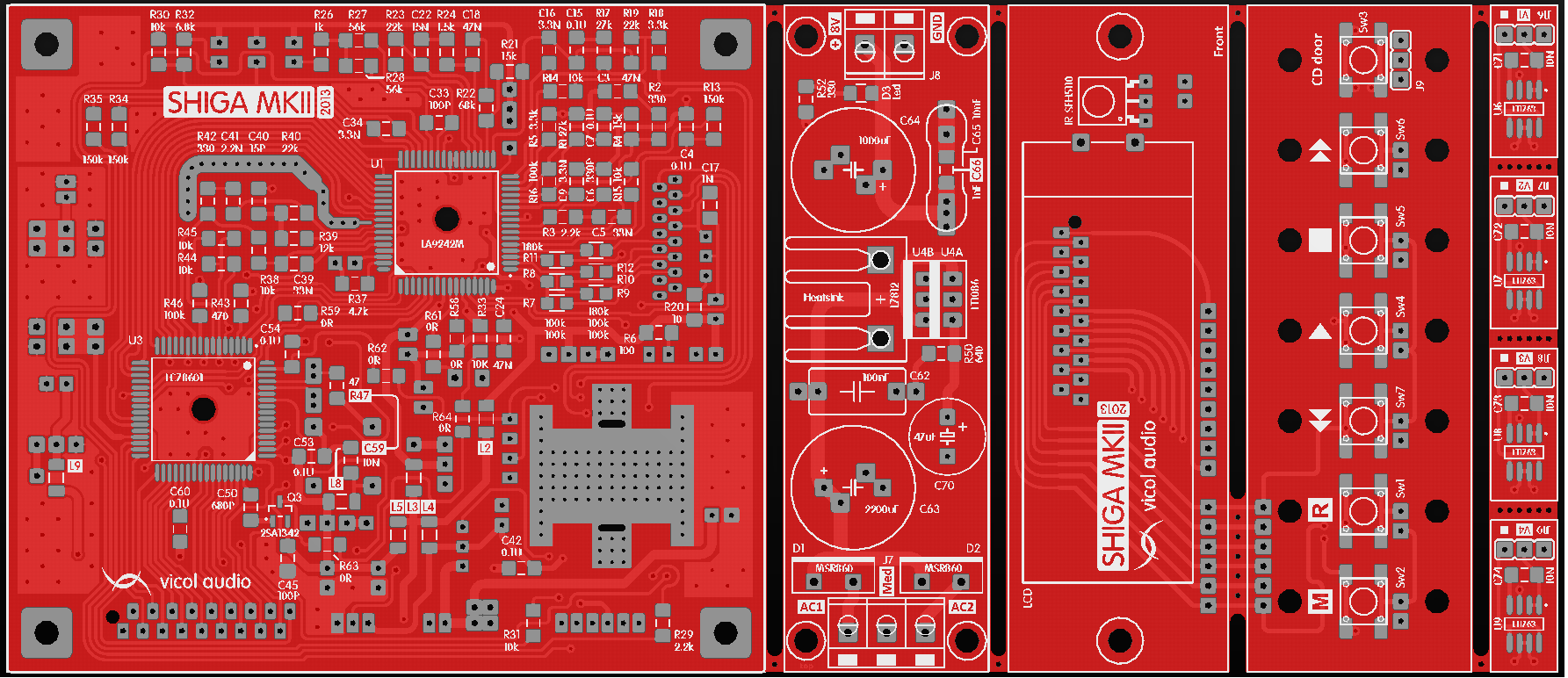

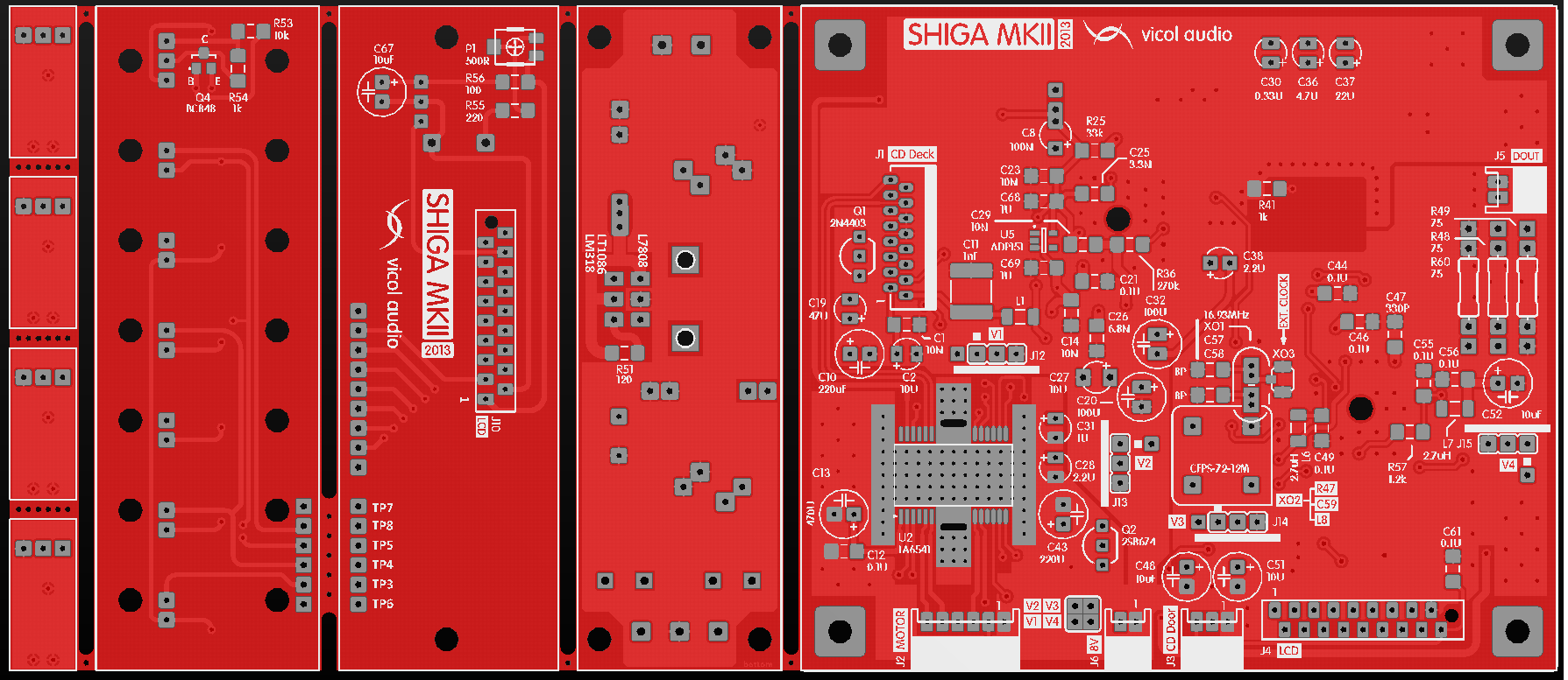

Tony,
Main regulator is using 7808/1086 as in previous version. We have added an extra decoupling cap for 1086. Display board is almost the same, there are only layout modifications. Tiny boards are optional low noise regulators for each critical section.
These regulators can be easily replaced with any other reg capable to deliver at least 150mA.
tibi

Tibi, ADP151 is for Vref? 2N4403 is a substitute for 2SA608NF?
Regards
Yes, ADP151 is for 2.5V reference and 2N4403 is one of the lowest noise transistor available on market.
