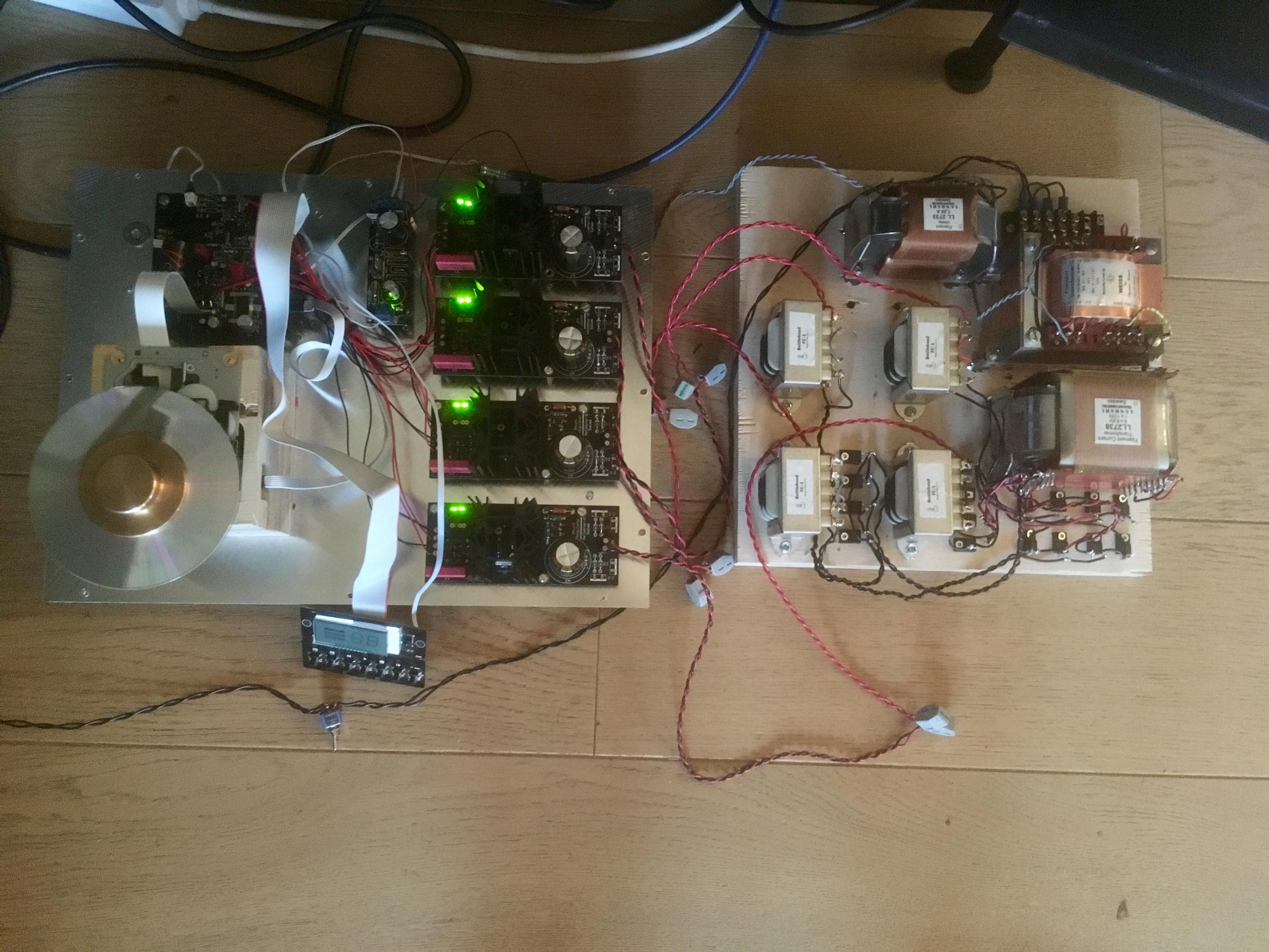

My Shiga is running with lc supplies
For 4 reflektor D , and for the original psu. Maybe I'll try the new Salas BIb for the 8 V later and another clock

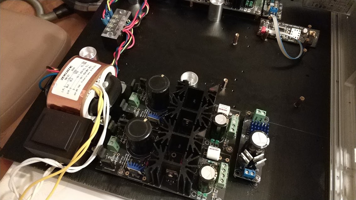

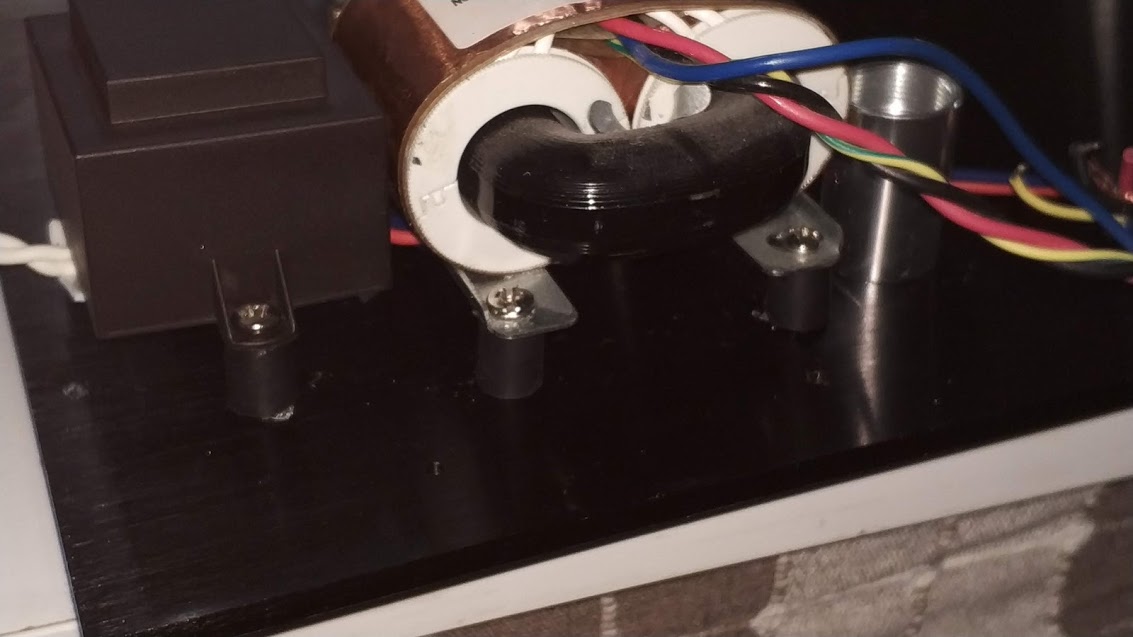

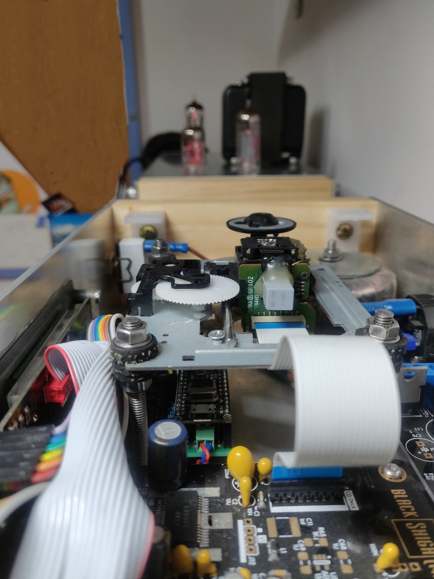

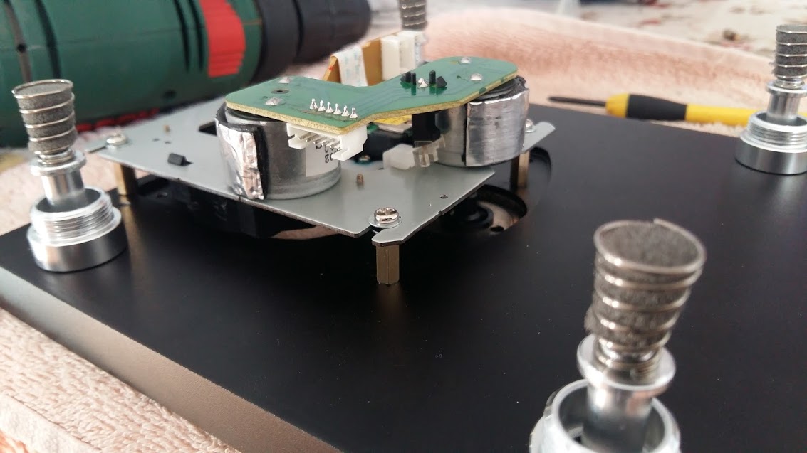

Mechanics placed on a woodblock, would like to get some inputs on the best way to mount it.

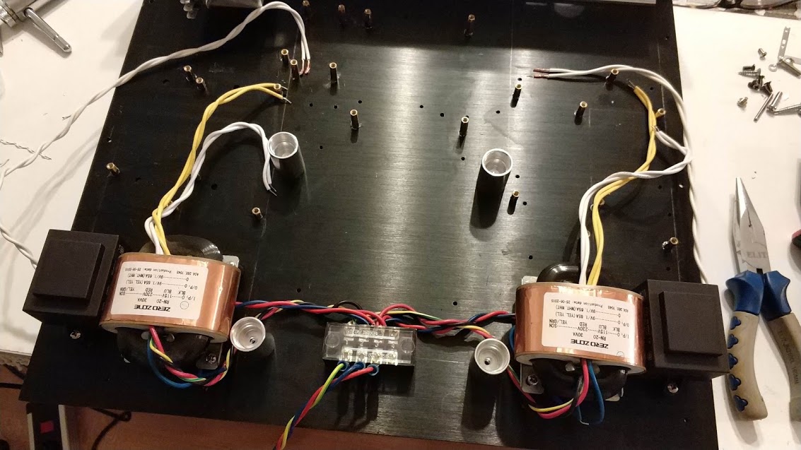

I like your combo of transformers.
Many thanks for feedback !

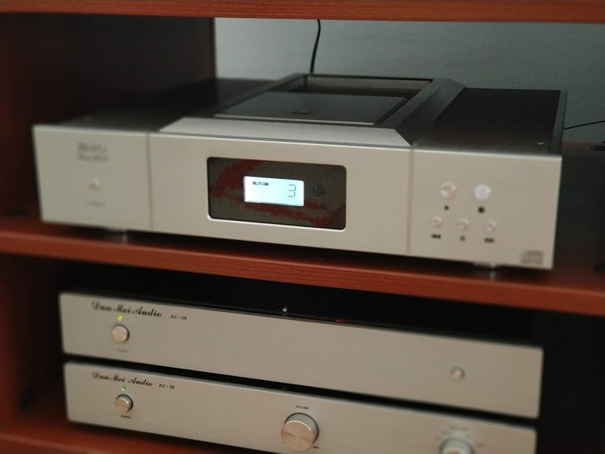

Hello guys.Here's my version of Shiga MkII Black which I have finished today.
I used this case 田雨音響—CDM3、CDM4 轉盤機箱 that I brought from China where I was on a tour with my orchestra.
The case is spacious and solid with antishock table for cd mech,perfect for the full D-Reflektorized version.
Looks very good and sounds great.
Greetings
Impresive work, Nicolae !
Hope sounds on pair with your orchestra.
Tibi
Thank you,TibiImpresive work, Nicolae !
Tibi

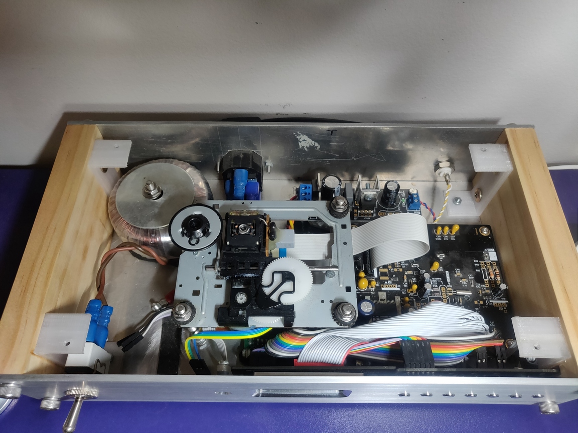

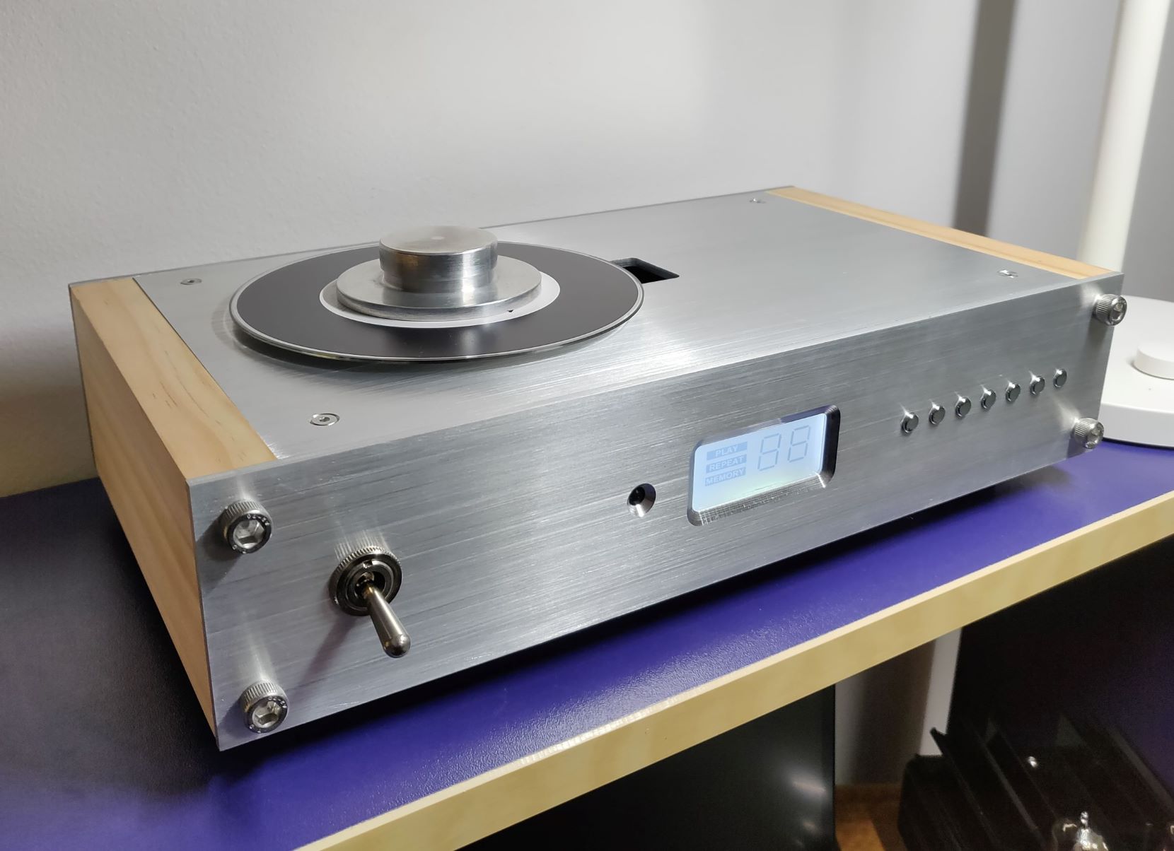

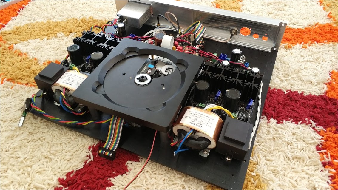

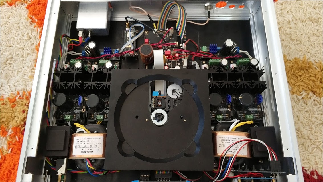

After two years I've finally completed my build. While I've had it playing for nearly a year now, it's great to have the enclosure finished too. Thanks for your help in the beginning stages, Tibi.

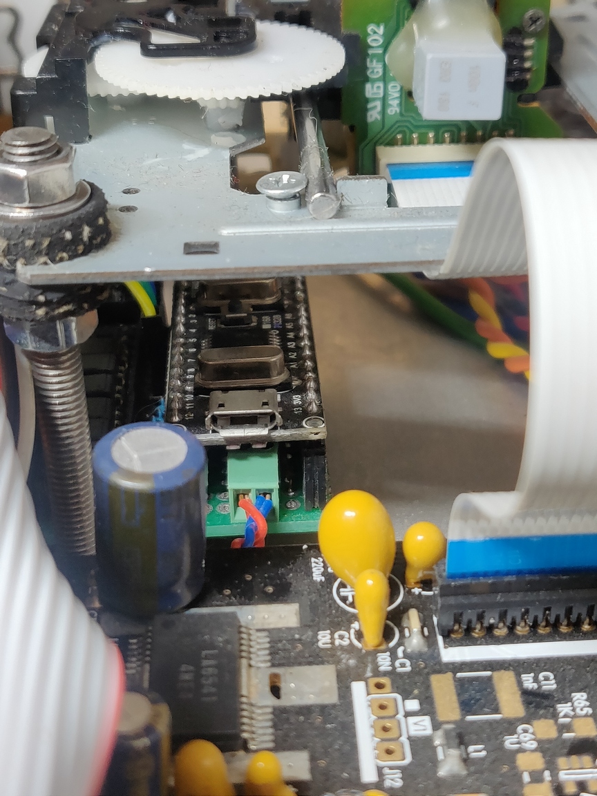

Remote control is by an Apple remote with the IR signals decoded by an Arduino Nano. The Arduino outputs are linked to the button PCB through optocouplers.
Thank you!

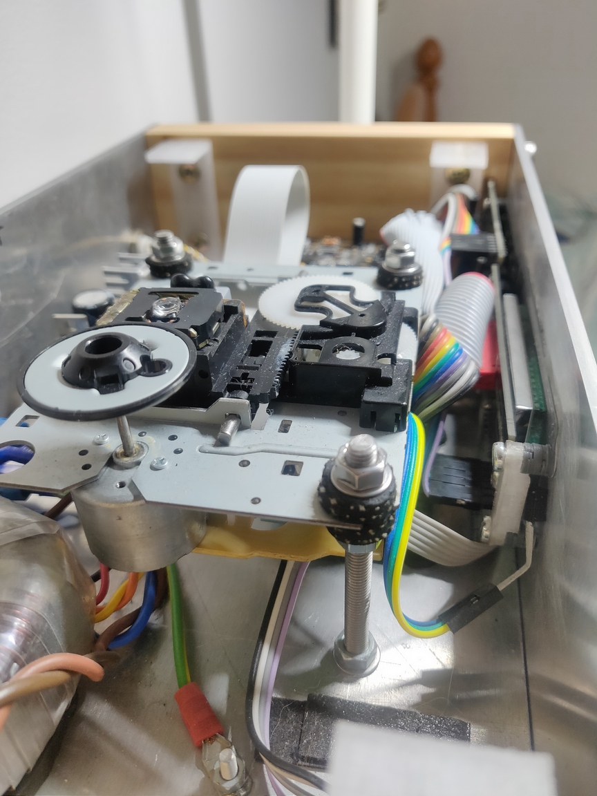

It turned out much tighter than I expected, especially around the display and buttons. The mech is held up by bolts through the base. You can just see the arduino under the mech, along with the perfboard I used for the additional circuitry.
I used my 3D printer to make mounting frames for each PCB, that were then glued to the aluminium. As for the aluminium, I had the front made by Front Panel Express, the lid done at my local laser cutting business, and the others cut by hand. The 3D printer also came in handy for the brackets to hold it all together.
Bonus out of focus image of my recently completed Bijou headphone amp. It's in an identically sized enclosure to the Shiga, so they look great side by side (if I say so myself).
