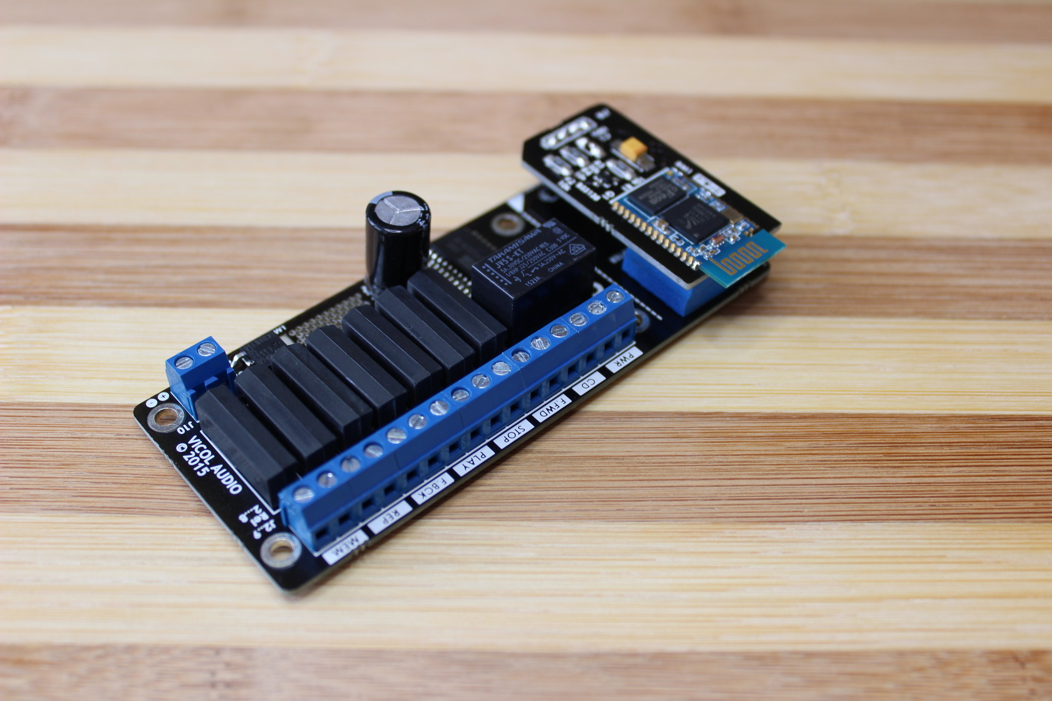

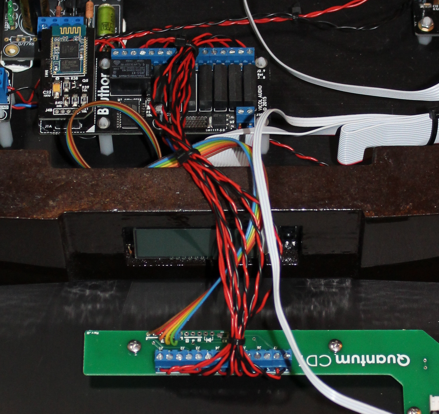

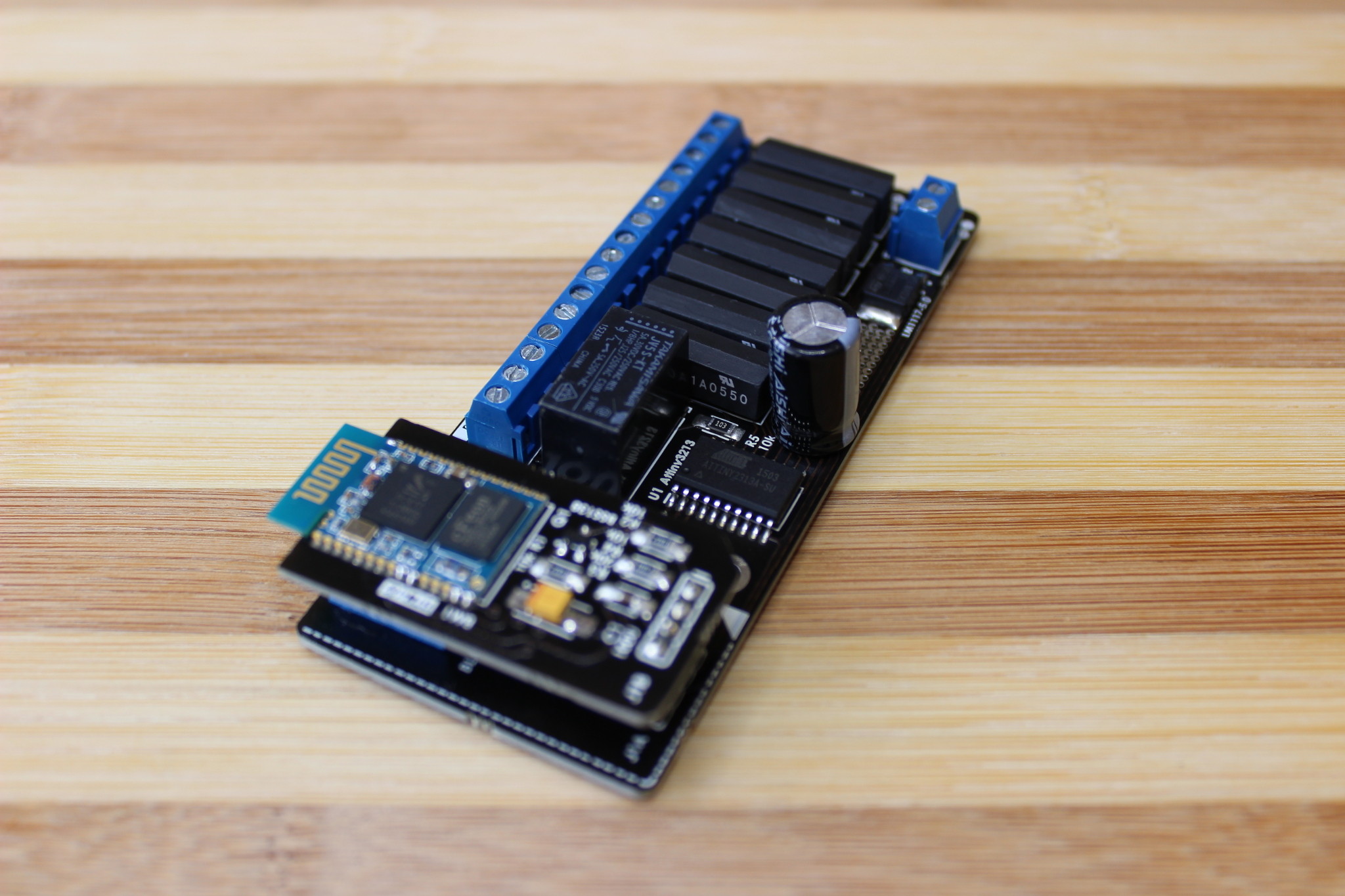

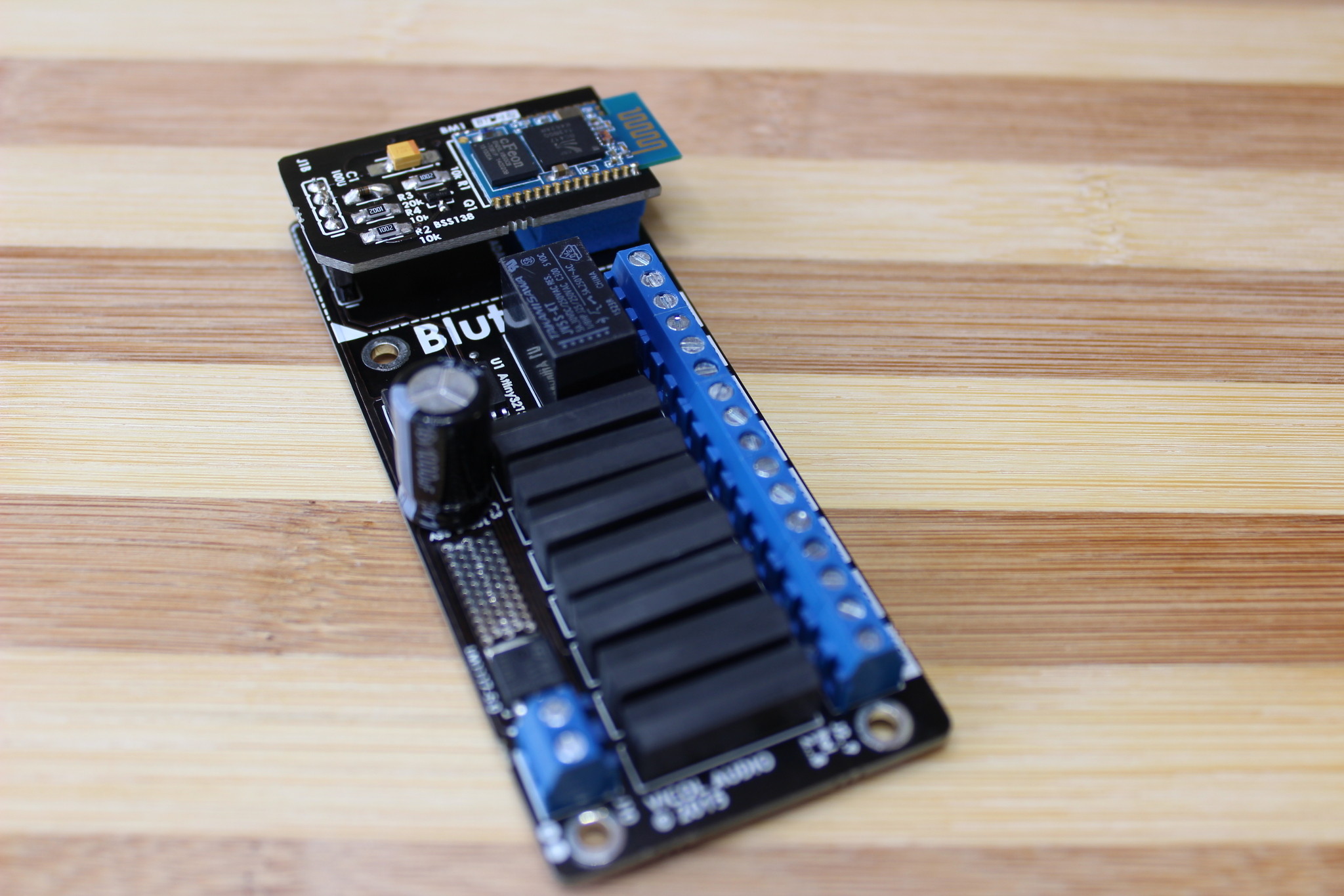

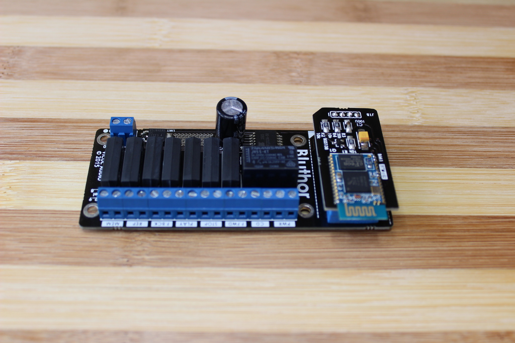

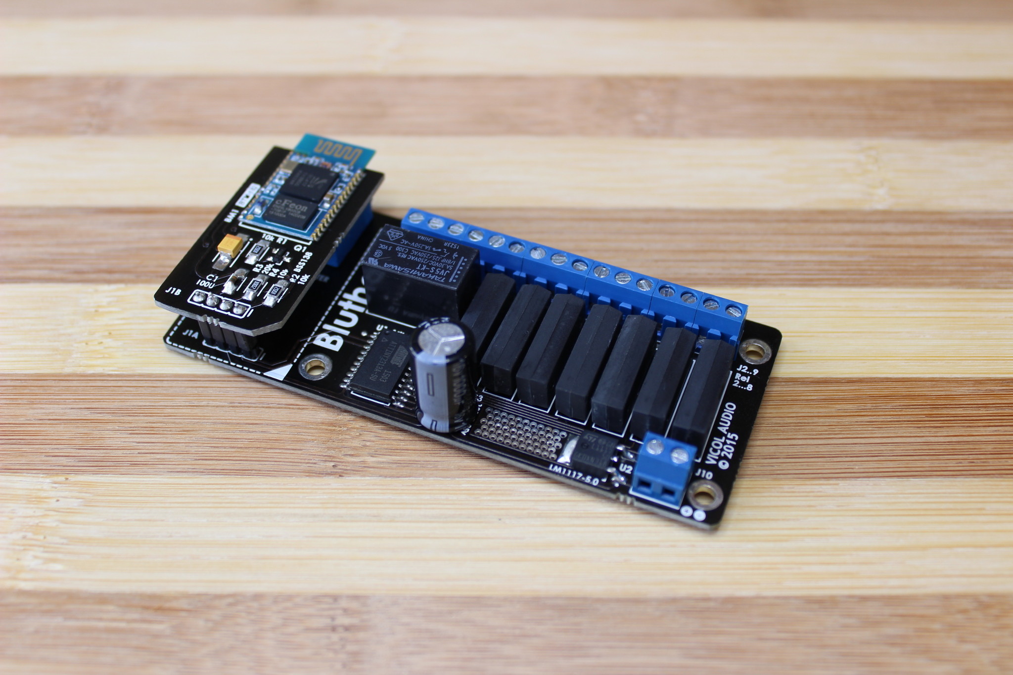

BluThor installation is quite simple. Here is how was done in Quantum.
BluThor have one REED relay for each button. REED relays are commanded by an ATmel.
Power on/off is done trough a more powerfull relay able to sustain 5A @250Vac.
BluThor may be installed in any CD player that make use of push buttons for play, stop, etc.
An old CD player without remote may gain remote control via blutooth with BluThor.
Tibi

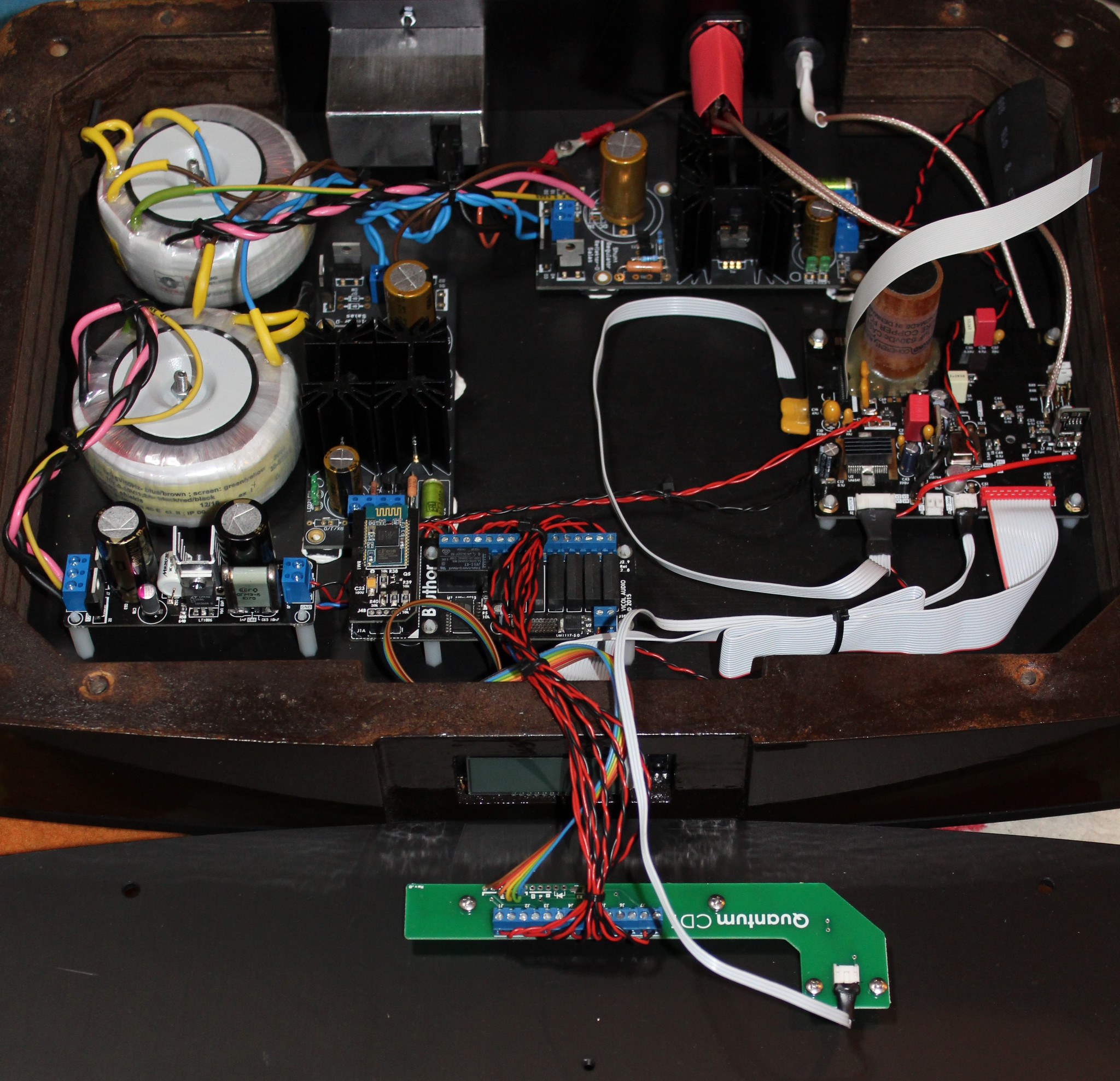

Heat sink for LA6541
Hello Tibi,
I saw on the photos that you use the LA6541 with heat sink in the Quantum CD.
When I asked you a year ago the answer was that no heatsink is necessary with the Shiga MK2.
But I assume that it will bring a benefit, otherwise you would not use it - longer lifetime ?
Best regards
Christoph
Hello Tibi,
Best regards
Christoph
Hello Christoph,
No heatsink is necessary. PCB was designed to disipate LA6541 heat.
Quantum is a closed enclosure with no ventilation.
Qrgds,
Tibi
