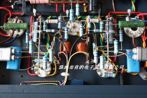

Hope the schematics are of use.
Interesting schematic, a lot of gain. What's the bias voltage of the input stage?
Seems one set of diodes on the power supply are drawn reversed, unless you heard an initial pop when you first powered it on ;-)
Regards, KM
The amp only very occasionally pops when switched on (metal toggle switch), it is not that much of a pop really. I do not know the bias voltage of the input stages. I am reluctant to start checking thinks like that on a live circuit as I have no electrical training at all. Upgrading caps is one thing, but a live circuit is something only the trained should "mess" with. I have visited hospital enough over the past 3 years. I have learnt a bit from reading and trying to figure it out and replaced a few caps and a couple of resistors but i am not trained. In the actual amp there is only one diode on the power circuit. This is what I mean in my earlier post, the schematic and what the amp looks like in real life and not exactly the same.
What is the physical/audible effect of the amp having a lot of gain on the input stage?
It means it will overdrive the output stage before reaching full volume, giving you the illusion that the amp sounds bad above a certain point. In reality the amp is at full output at a lower volume setting. Typically, you would design the amp to start clipping at full, "line level" input. Sometimes it is not convenient to do this or the original designer had different goals.
This is all a lot of guesswork, so some measurements are in order. At the risk of commenting on a problem that has already been solved:
With that circuit (SE KT88) and even with the small Klipsch speakers, decent sound levels for rock/metal should be possible before significant distortion is noticed. For comparison: I have speakers that are comparable in sensitivity but that are also badly worn, with their paper drivers being partly consumed by many generations of silverfish, and I witness the same sort of distortion phenomena as outlined in this topic. However, this is with a badly dimensioned amplifier that is capable of producing about 1.5 wpc when it's running at maybe 0.5 wpc max. The speakers are not the bottleneck in my case; I know the amp will start to distort badly at the cited power level due to bad design of all stages.
It seems to me something's not in order in the case of bottletop, and the amp is the first thing I'd suspect. Incidentally, it's also the easiest thing to take measurements of, so it'd be the place to start. Bottletop, if you feel unqualified measuring this amp, please follow the advice that others have already given and either take the amp to someone nearby who has a pair of speakers of known and proven quality, or (better yet) take the amp to a qualified technician or repairman and have them evaluate it. Preferably pick someone with experience with vacuum tubes. If you decide to do measurements yourself nonetheless, be aware that for this problem, a scope as well as a sine wave generator would be very nice to have around.
Mastodon, Yes much guess work. If I could be more helpful then I would. I agree with you and have been thinking the same thing during lunch. I am starting to get well out of my depth here as can be seen from the questions I am asking. There is an engineer in Mansfield who has a scope, is a sound engineer and repair/upgrades tube amps. I think I will take it to him to get a better idea. As regards to friends with speakers. This is tricky as no one I know as is into tube gear or even knows what a capacitor is or a valve. My friends use ipobs and docking stations or listen to music via their PC. Not that is wrong or anything. Need to take my amp to a professional.

You can probably take the diode out of your list. If it wasn't installed correctly, bad things would have happened. As far as only having one instead of two, they probably just used an uprated part to eliminate the need for two.
Personally, based on what you've said and how it related to my experience, I think your amp is clipping and it is really coming out harshly from those horns. I don't think I came out and said that clearly in my original post.
I feel like maybe you are moving to the next level and need to build your own amp. This DIY Audio, afterall...
I would also agree (w/Russ) that you probably have some amplifier issues. The input amp is pretty much a carbon-copy of the values used in the SP3 phono stage. High gain and in your case driving a 12AU7. I would guesstimate you have ~60dB of voltage gain before the KT88. You also have a low biasing (voltage and current) of the input stage and lot of feedback. I would probably replace the input/driver stage entirely.

KM, thank you; very helpful of you. I will take this on board. If I was going to replace the input stage, what would you recommend replacing it with? Something with no negative feedback? I have got my amp booked in with the engineer in Mansfield (next Thursday). He said he would be able to pin point the problem but fixing the problem is something else as he is snowed under with work.
Lots of designs for zero-feedback, but would not go that way with a pentode or beam power tube. You'll need some feedback to clean it up. Perhaps time for a DHT-based SET...
Your amp has a lot of parts underneath... reworking it is time consuming, would recommend putting the effort and funding towards a nice DIY build and move forward.

KM- Yes, I have often thought there is quite a number of parts in my amp when I have seem other amps wiring. I don't mind spending time re-working my amp. But the question is will I end up with am amp that hums. The power tx seems quiet. IE you have to have your ear on it to hear any hum. Again showing my lack of knowledge, does negative feedback stop the tx from humming or does it dampen/stop the hum being "picked up" in the circuit? I had a look at the MEG amps. I like the lay out and the simple looking design. They have gone from eBay, but here is an image of the 300b se model. I would like to perhaps makes something like this but I am not sure about using 300b tubs as they are well pricy and there is not that much option for tube rolling due to the rarity/price of these nos tubes. I think a kt88 based amp is a bit more flexible.
