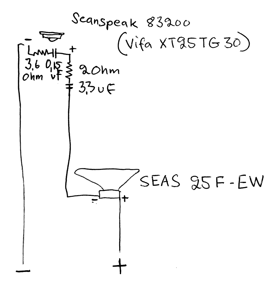

So what do I not understand? First, I know that if you dont know what you are doing, dont do it. And beginners should build proven designs etc. And yes, I admit, it all serves me right - however...
I attempted to build a two- way with a (sort of) series crossover. Actually, its not really a crossover, since the woofer, a SEAS 25F - EW ( the same that used to sit in Dynaco A25 - a woofer with nice natural roll-off and proven to work in a two way without an XO ) Anyway the woofer is connected in series witha a Scanspeak 83200 ( identical to Vifa XT25TG30) via a 3.3 uF capacitor and a 2 Ohm resistor. The tweeter also has a Zobel ( 0.15 uF and 3.6 Ohm ) ( the reason for the series connection is a matter of impedance, they are both nominally 4 Ohms and I intend to run this two-way in parallell with a Diatone p-610 8 Ohm full range. If this is a stupid idea or not can be discussed, but that is not the issue here) Anyway, as soon as I connect the tweeter the bass totally disappears. The woofer runs fine by itself, but as soon as the tweeter connects the woofer is barely audible. As I have stated, I am a beginner and my understanding of things is limited. At first I couldnt understand at all. Then I started to think in terms of the circuit. Signal goes from + on speaker terminal to + on woofer, out thru - and thru the cap and resistor to + oo tweeter and back to - on speaker terminal. That meant, I thought, that the bass filters off in the tweeter cap before completion of the circuit in the speaker terminal ground. Then I realized that if that was to be true, series crossovers wouldnt be a possibility at all. I have also seen that the series XO schematics I have found starts on the + of the tweeter. Could that be the problem? Should the circuit start on speaker terminal + to cap and resistor and then + on tweeter, then from - on the tweeter to + on the woofer and finally from - on the woofer to - on the speaker terminal? But then the whole signal would most definately have its bass filtered off by the tweeter cap?
I understand that I made this mess myself and dont deserve any help - but if somebody could tell me what I did wrong, I would most certainely be forever grateful. I include a picture of my wiring...

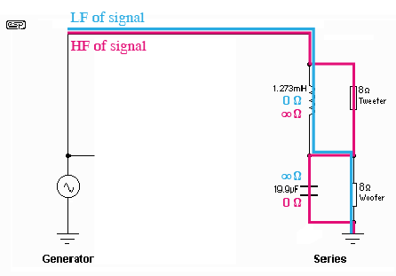

Start by wiring this parallel. The impedance doesn't drop except where the two drivers are carrying the same frequencies. This is most important to note down in the lower frequencies which doesn't happen when you have a high pass on the tweeter. When run parallel, the overlap will only happen starting just below the XO frequency and up. That won't hurt your amp as your bass driver has a rising impedance with frequency. Try it with just the cap and resistor first, no zobel.
For doing a series XO, you'll want a cap shunting the woofer and a coil shunting the tweeter, while the two drivers are wired in series.
Nah, put an inductor across the tweeter.
If the tweeter needs a series resistor to make it quieter, put make sure that's between the tweeter and the inductor.
Capacitor goes in parallel with the woofer.
Inductors pass bass, caps pass treble.
So the inductor must provide a path for the bass to get to the woofer, and the cap must provide a path for treble to get to the tweeter.

OK, for doing a basic series XO you follow the last part of my post.
Remember this: In a series XO the drivers are in series and the components are in parallel with the drivers. In a parallel XO the drivers are in parallel and the components are in series with the drivers. There are other components involved but those are the basics of the two XO's.
The reason yours doesn't work is that you have the drivers in series but you also have the 2Ω resistor and 3.3 µfd cap in series so your bass drivers is not getting any lows, you cut them off with the cap.

First of all, thanks for the help, both of you. So I was right in thinking that the cap took away the lows. And I dont mind skipping the zobel. But if all I want is protecting the tweeter from damaging lows ( both for the tweeter and the sound itself ) but want the woofer to run in full fredom - so to speak - and also to attenuate the tweeter a bit, where do I put those components in a series connection? And should the circuit run in another way than now? And lastly, in a series two-way, is it imperative (which I am guessing from your posts) to have an inductor in the circuit to pass the lows to the woofer. I suppose that inductor then must have the ability to pass lows below the lowest frequency of the woofer ( or the box design...)

Probably best to run the drivers in parallel but with the 3.3µfd cap and 2Ω resistor in series with the tweeter, the woofer doesn't reach that high, you have a cap that is too small and will cut off the lows way too high. There will be a big hole in the frequency response.

Hold on a minute here, a series crossover here is still going to result in a 4Ω nominal speaker, so this isn't helping you with your goal of an 8Ω+ speaker in the first place.
well yes, and adding that wire gives me a parallel connection. and this it what I will do. I´m not sure I understand the post stating that I would still have 4 ohms with the series, I was under the impression - all other factors excluded - that parallell = half the impedance, series = double the impedance? but I do know that frequency-range of the drivers changes matters. anyway, I can see that I totally missed the fact that series xo is a completely different animal. for now I will go for the parallel connection since that is the components that I calculated with and have...and then I will have to go back to the schoolbench and learn some more about designparameters of the series xo.
Yes, but there is a major "other factor": the crossover. In a parallel crossover with 4Ω drivers, you get a 4Ω nominal speaker, not a 2Ω, right? That's because the HF crossover makes the tweeter approximately infinite impedance at low frequencies, and the LF crossover makes the woofer approximately infinite impedance at high frequencies. In a series XO, it's the same kind of situation:I´m not sure I understand the post stating that I would still have 4 ohms with the series, I was under the impression - all other factors excluded - that parallell = half the impedance, series = double the impedance?

The main difference between parallel and series is that series xo is one circuit and a parallel is 2 circuits for 2-way, three circuits for 3-way etc.
In a parallel filter you can have completely different xo points. That's not possible with the series xo. You also can't bi-amp speaker with series xo
