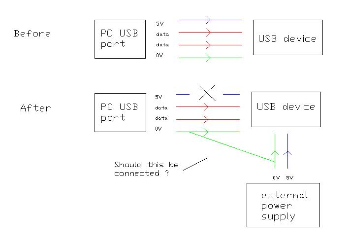

I am thinking of adding a separate power supply to a USB powered device. Do I have to connect the ground(i.e. 0V) of the new power supply to the ground of the supply coming from the PC ?
The signal will come from the PC USB port, the power supply from the PC USB port will be severed & replaced with a external power supply. The ground of the new external power supply (the 0V) will be tied to the ground of the USB port supply. Is this OK?
Thanks.

Hi Joe
I'm no expert on this but would think that the PC, soundcard and external psu would need to have their grounds connected at some point in order to share the same 0V.
In a CDP with separate audio/dac board and decoder board, the 0V are connected from one board to the other. This is often done using the screen of the signal cable.
Does the 0V provide a screen in the USB cable?
Maybe a computer guru can help.

joeling : don't worry too much and connect them. That's what we did on this little dac : http://www.mellowparenting.demon.co.uk/guzzler/usbdac.html and it doesn't seem to create much problem, the noise level is at -95db.

But the earths wold still have to be connected and it is on the earth that all the dirt is ;-)
