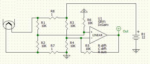

I am using toroidal PP transformers so equalizing the current is important. To achieve that I would need some effective way of monitoring the current the drawn by each tube at the same time. That could be accomplished with 4 panel meters with a 0-200mA range.
Also, unfortunately all tube are powered off the same filament transformer (12.6 CT).
To measure the current I have thought of a couple of methods:
you should be able to get a signal proportional for the cathode current using a diffirential amplifier on an OPAMP as attached. All resistors shouls be precise, 0.1% should be enough.
The circuit allows to use the common 12V power supply for heating for all tubes. The common node input voltage for the OPAMP here is 6V which should be Ok for most circumstances.
Most important, the circuits returns the true signal about the cathode current and can be used in feedback nets. A good portion of the alternating cathode current goes through 12V power supply. You will not know about it unless you use current sence resistors in both cathode pins.

You can use your large transformer, and yet control and monitor the individual cathode currents: Rk1, .... ,n set the bias current and allow the monitoring via a simple bridge arrangement and a voltmeter.
Note that the resistors do not need to be particularly well matched, and the scheme works indifferently for any grounding arrangement of the heater winding

Looks very nice and I see where you are going (or at least I think I do ) but I am drawing 10.5A continuously. Isn't that a problem given your choice of resistors in the schematic?

Your cathode current is probably not 10.5A, unless you make a really big amplifier.Looks very nice and I see where you are going (or at least I think I do ) but I am drawing 10.5A continuously. Isn't that a problem given your choice of resistors in the schematic?
If the 10.5A is the heater current, it will see the ~260mΩ reactance of the 10,000µF cap, which is still too much if a single tube draws that current, but is probably acceptable if it is shared by a number of tubes.
Anyway, you can increase the caps value almost indefinitely: modern, very low voltage E-caps are quite compact
