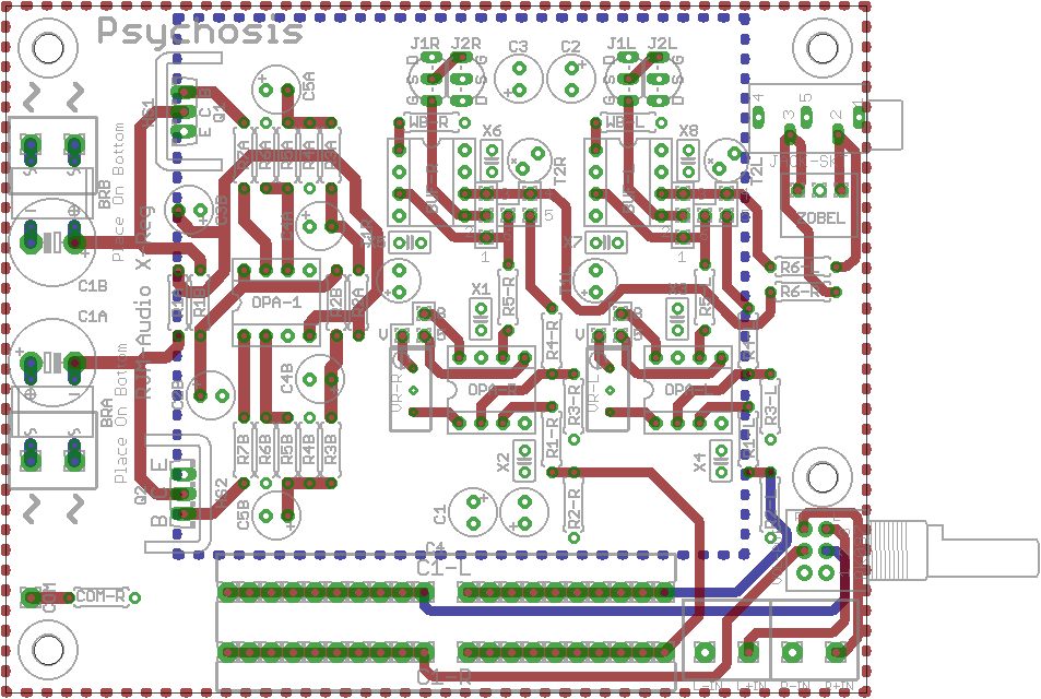

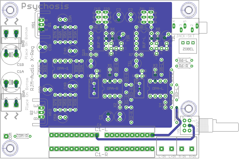

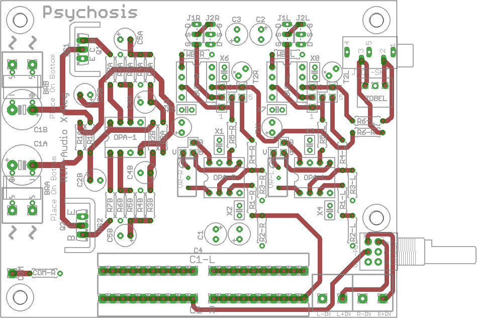

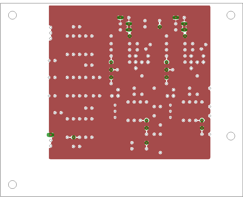

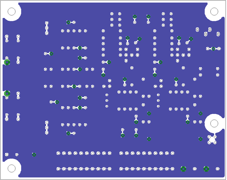

i think i have finished, just need to make the gerbers.
i have put a 14mil pad/hole isolation on all boards.
Work Board:
L1_Signal:
L2_GND:
L3:V-:
L4_V+, Signal:
i had a play with Kicad to see what it done with 4 layer boards and it left the pads on all layers. what i have done is replaced the unused pads with holes which gives more real estate for copper pours.
drill/mill will be top layer for all layers.
Work Board:
L1_Signal:
L2_GND:
L3:V-:
L4_V+, Signal:

Bibio don't totally remove pads on inner layers unless your software has a drill oversize function, if it doesn't leave a land that is 0.15mm (6 thou) larger than your required finished hole size (0.2mm/8 thou) if space allows this is to cater for the fact that PTH holes are drilled larger than your finished hole spec (approx. 0.1mm) and to allow for PCB fabrication tolerances...
I am intrigued by your design Mr McGuire and would be interested in seeing it... Balanced signals and routing does minimise the effects of bad ground (as does LVDS for digital, hence its increasing popularity as the defacto interface, HDMI Ethernet, USB data transfer, some handshaking is single ended hence USB requires a ground connection). The beauty of balanced is the return currents will flow down the opposite leg of the balanced connection, though on a PCB you have to be careful how you route them when ground planes are present as the return can couple to this plane depending on the board stack up and dielectric distances. Pseudo balanced routing can also be used for sensitive analogue signals to again minimise the interaction with the full ground, do this quite often when bringing low level mic signals onto a board and to the first active device, often broadside routed to get good coupling between the hot and return, the ground connection is then done very near the input to the first active device. This is for single ended signals only.
ok. i was going by the drillfile sizes that includes the plating tolerances.
whats the minimum isolation on pours i can safely use?
The drill sizes you specify in your PCB file are finished hole sizes after processing and plating...
So if you specify a 1mm hole the manufacturer will use a 1.1mm drill to drill the unplated hole... You also have to allow for fabrication tolerances so don't remove inner layer pads just make them a bit larger than the finished hole size, adding 0.2mm would be sufficient, so your pad on an inner layer for a 1mm hole would be 1.2mm
