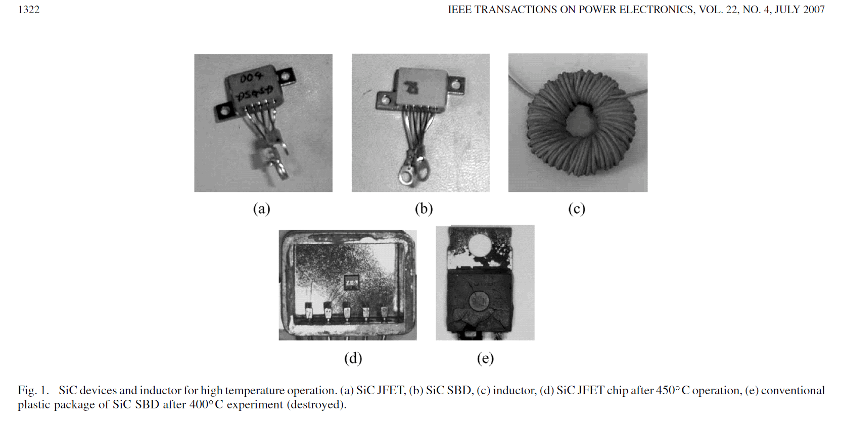

It have been done beforeHey, since you're the "push 'em over the edge" expert here.
How would you go about soldering a device that gets so hot?
I did some playing around with pushing devices real hard, back then, the only solution I found, was to crimp instead of solder.
Magura
EDIT: And you might as well spill the beans. How do we get that plastic casing off, without damaging the fet?
Look at the attachment... please notice publicaton date
Take care
Maybe the temp fluctuation could be handled, by adding some thermal mass?
Magura
Yes, I agree. I was working with bare die mounted to Kapton film only at the die pads. We would typically have several times the mass in copper soldered to the back of the die in a mounted leadframe situation.
BTW, die are typically soldered (Die Bonded) using a "silver solder" type paste that goes liquidous at about 450C.
