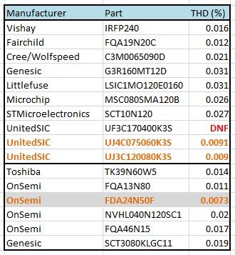

I’m going to be a nitpicker again, but what’s the point of quoting / comparing the capacitances at arbitrary voltages? 500V, 200V, 100V and 25V, respectively. Only the last one is appropriate for a typical Pass design. Looking at the charts, around 25V the capacitances are not that disimilar…

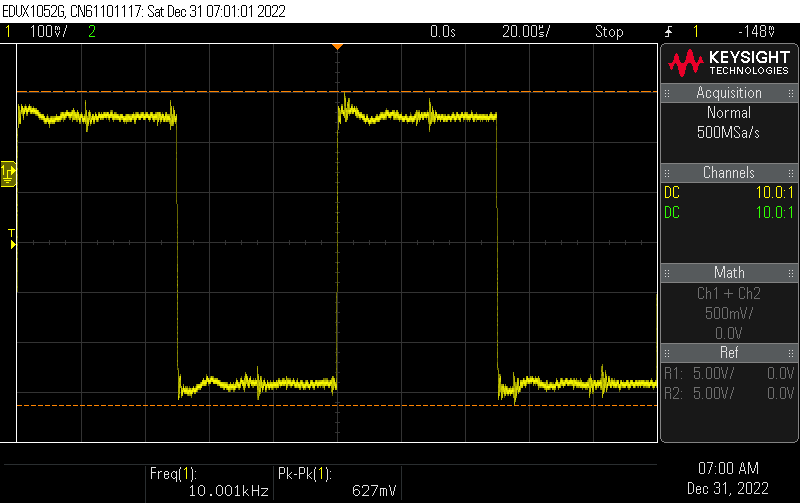

Thanks for EUVL for clarifying potential downsides of only testing for THD, which could be coming at the expense of other performance considerations.

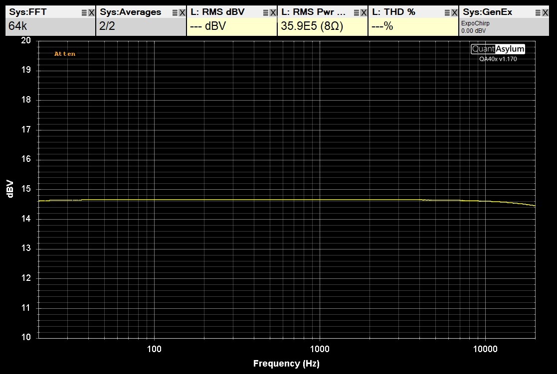

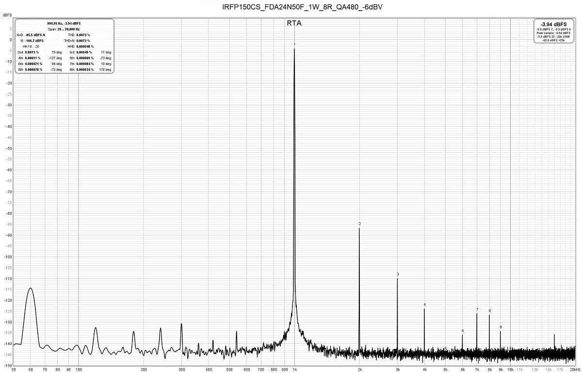

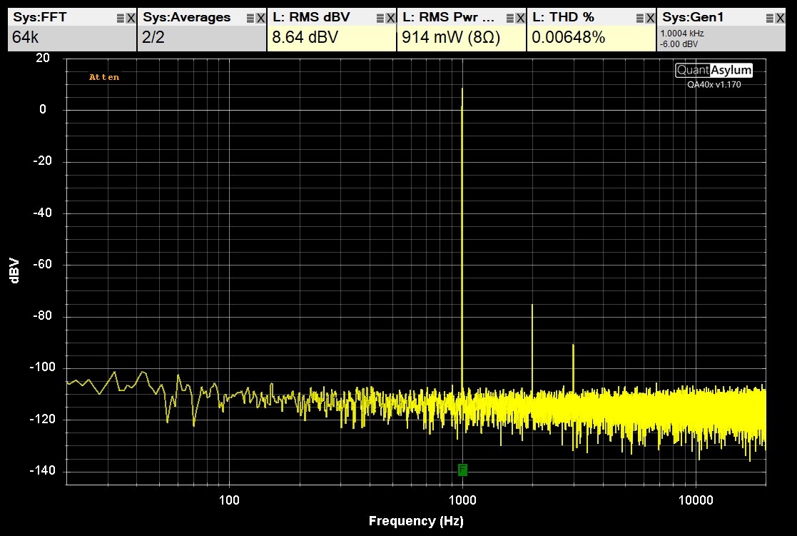

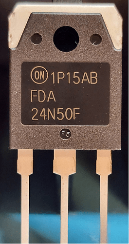

I used this as the motivation needed to address some gremlins in my measurement setup and moved to using a laptop as well. In the end, the payoff was worth it and it looks like the FDA24N50F is a worthy candidate to move to sound quality testing despite being a 'mere' mosfet
THD - 0.0065% (just shy of 1W into 8R)
Frequency Sweep

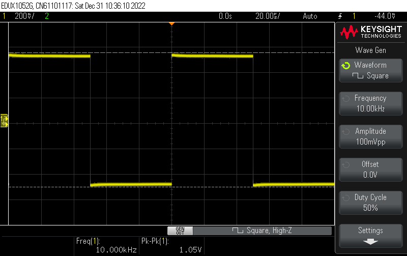

10K Square wave using the built-in signal generator (digital)
Happy New Year FABs!!!
Stephen
Frequency Sweep
Stephen
"Ringing" in the New Year with those square waves?
Happy New Year!!!
I learned something new today! Thanks WBS for identifying this for me as ringing. I thought it was due to a cheap signal generator but I just ran a loopback and will expect something much closer to this in the future. Time to put the FDA24N50F on the naughty list for 2023.
Happy New Year!!!
You need to measure frequency response to 1MHz to catch those peaks further up that cause your ringing.
The square wave is a good test, so you have some stability issues to solve.
And you need to test also with some reactive load.
