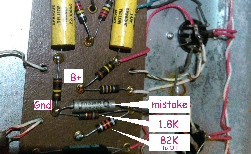

> The resistor/cap im pointing at in the picture dont seem to be in the schematic....
The cap is wrong. It may be a bogus mod. If it is less than 0.02ufd it *may* be a factory tweak to brighten-up the amp (though this is a dubious way to do it).
I do not see two 1.8K in that picture. Are you good with color codes? It is a very useful skill. If you have color blindness, have someone help.

Wow awesome labeling on the photo! Thanks!
I just looked up the code for the resistor - the one you labeled as 82k to OT - it should be 92k but it reads at ~1900ohms. (I havent been reading the resistor codes - just measuring them on my meter)
Gonna pull that cap and replace the negative feedback resistor!
EDIT;
Why would anyone put a cap in that location?
Also, wow - just replaced the negative feedback resistor and it is still reading as ~1900ohms... hows that work? it was 220k (chose a higher value) before installed - now it reads at 1900?
You often can't measure resistors 'in situ'. If there are other paths in parallel with the resistor, you would need to disconnect one end of the resistor to make the measurement.
In this case, one end of the 82k is grounded through the output transformer secondary and the other end is grounded via the 1.8k resistor. So what you are measuring is the 82k resistor in parallel with the 1.8k (plus a little bit of series resistance in the output transformer secondary).

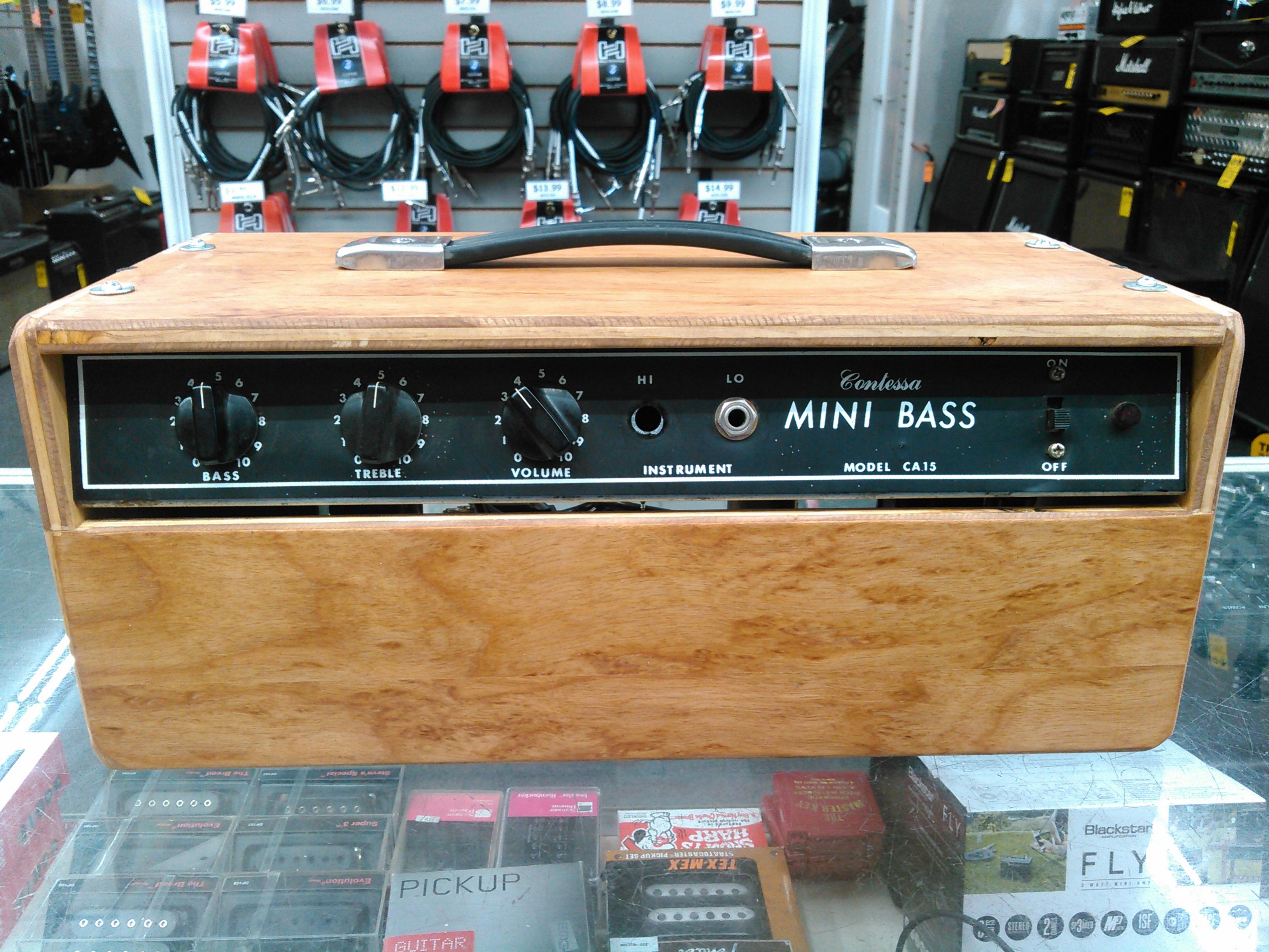

Made a quick and dirty box to house this little guy!
I may try and get a master volume in to this amp - or I may just leave it as it is and start a new project.
