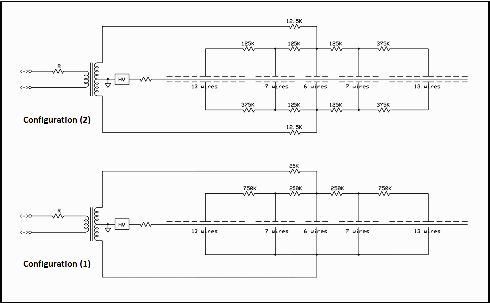

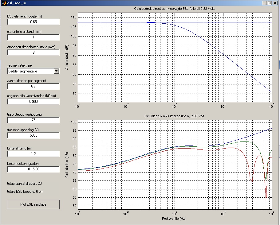

verry ncie to play with, but as calvin mentioned the 6DB rollof is easy done by a resistor in front of the tranny wich also helps the amplifier in the high frequency as well. to use both i need to play allot
in the picture i modeled my new panel im working on, i have 6 wires in the middle without any ressistors then 7 to the sides wich are tamed with 900Kohm
the hump from 9000 i would like to tame with a resistor before the tranny. im not sure yet how this is gone work out.
also im not sure if the 900K ohm has to be power resistors ??? can it be ell cheapo 0.25 watt or something.
on last question does it mean 900K on each stator? at least thats what i thought

Yes, it is a very cool program.
The first set the resistors take the bulk of the power as determined by the highest frequency's.
The spice sim's that I show are for test tones at a full power and the resistors need be fairly large.
But, In the real world this is not the case for the most part as the highest frequency's occur as intermittent peaks and not a constant level.
In one of these threads I show more realistic values of the needed power ratings.
I will try to find that post for you.

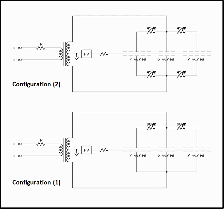

See Configuration (1) for the meaning of the 900K resistors. It is one to each of the 7 wire groups on one stator. The other stator has no resistors.
Alternatively, you can use the more common symmetric arrangement shown in Configuration (2).
The required power rating depends on what voltage you are driving the stators with. Also, you need to consider the voltage handling capability of the resistors, not just power handling. With D/S = 1mm, maximum recommended stator voltage would be about 3kVrms. From this I would estimate that worst case voltage across the 900K resistors in Configuration (1) would be 2500Vrms @ 6Khz when a 1ohm resistor is put in series with the primary. Power dissipated in the 900K resistor would be about 7 Watts. Of course this is worst case with test tones, music will require much less power capability than this.
You could probably get away with using a single 1W - 2W resistor.
However, most resistors have voltage ratings in the 500V to 700V range.
So for reliability, I would use two or three 1W resistors in series for each of the 450K resistors in Configuration (2)
I agree. The series resistor in the primary of the transformer is highly recommended as it protects the amplifier from core saturation at low frequencies and makes the load easier(higher magniture, more resistive phase) at high frequencies.Still there's a small rise in freq response which I try to get rid of with a series resistor in the primarie of the trannie, which makes it an easier load on the amp. As wel as on the trannie.

Isn't config 1 out of balance ? Front filtered and back stator not ?
Although the physical appearance may look unbalanced, what matters is the voltage response across the ESL segment capacitance. Configuration 1 & 2 provide the same voltage response as it is an RC series network. It doesn't matter if you put all the resistance on one side or the other, or some on each side. All that matters is the sum of the resistances in series with the segment. I have confirmed this with measurements.

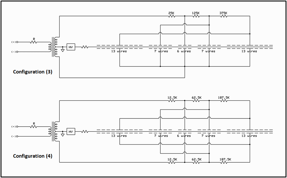

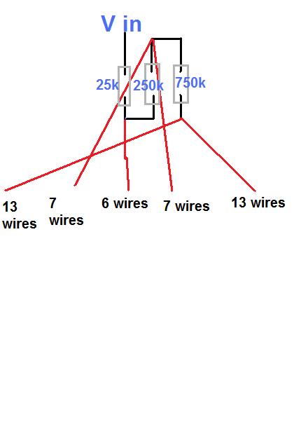

I have made the following electrical circuit for each stator (front and back). How does this compare with the design I made in ESL_SEG_UI?
Hello jeronimo83,
Based on your ESL_SEG_UI inputs, the attached schematics show resistor values and wiring connections that would give the calculated response.
If I understand your electrical circuit description correctly, you should use the resistor values in Configuration (4).
Configuration (1) is most directly comparable with the inputs from the program.
Configuration (2) is the symmetric version of (1) where half of the resistance is placed on each stator segment.
Configuration (3) left and right side portion of each segement are connected and driven with one resistor ladder.
Configuration (4) is the symmetric version of (3)
As mentioned previously in this thread, often the resistor for segment 1 is moved to the primary side of the transformer where it can provide core saturation protection as well. In your case with a 150:1 step-up ratio, the 25K resistor could be replaced with a 1 ohm resistor on the primary side of the transformer(resistor "R" in the schematics).
