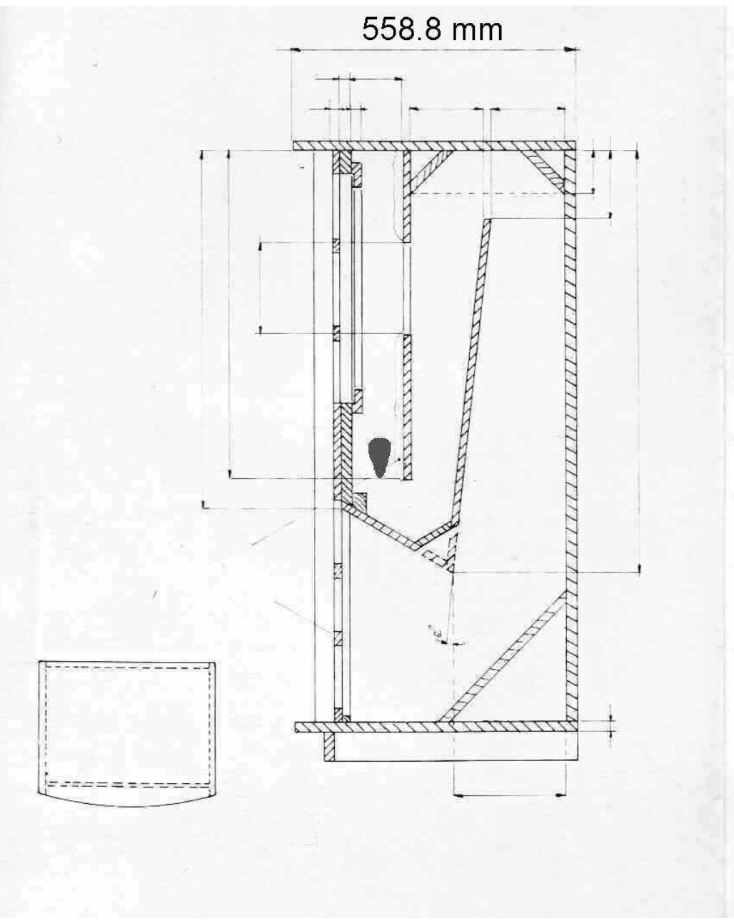

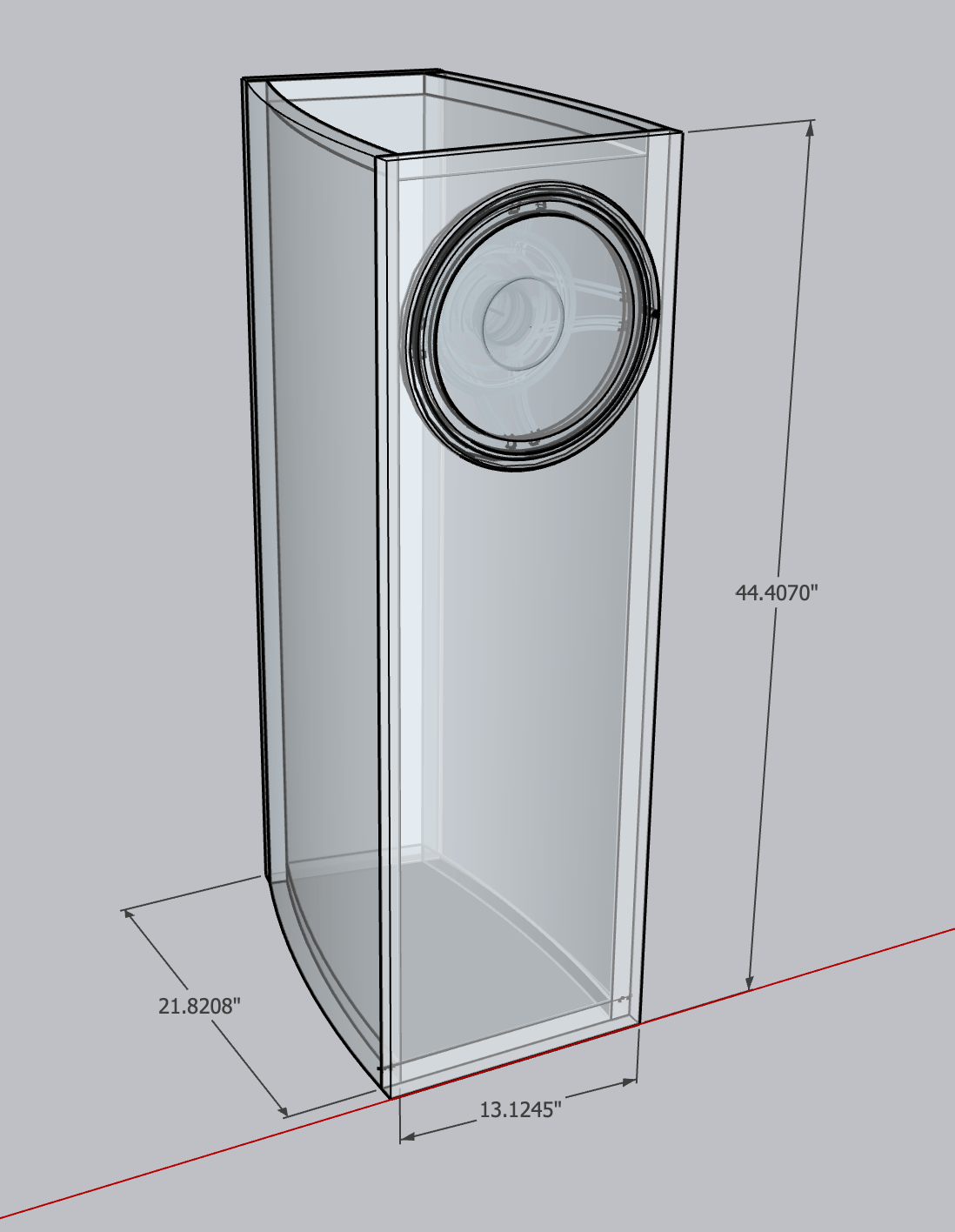

Some ideas below:
The GRF is courtesy of Hans on the Tannoy Groups.io group, but the minimum width he recommends is 25.5 inches.

Personally would just 'squeeze' an existing design and re-dimension it to maintain its flare frequency/factor and accept that it will have a wider horizontal/narrower vertical polar response, which if setting relatively close in a small room is advantageous.
Horn mouth polar frequency: c = 10^6/(a*b)
a = wall angle in deg
b = mouth width (or height) in inches
c = -6 dB frequency
metric = (2.54*10^6)/(a*b) in cm

Which one do you mean?
The straight cab with curved walls, or the horns?
And why?
Hi there,
I was recommending the 'tall & narrow' transmission line enclosures.
Many 'standard' Tannoy enclosures are really quite large and wide.
Your desire for something tall & narrow is exactly the job for a transmission line box.
This design should allow you to have good bass extension without being too large.
I have never built a T/L enclosure, but I understand it can be quite a challenging project.
As for horn-loading a Tannoy, I know nothing about such.
Take care & have fun :)
