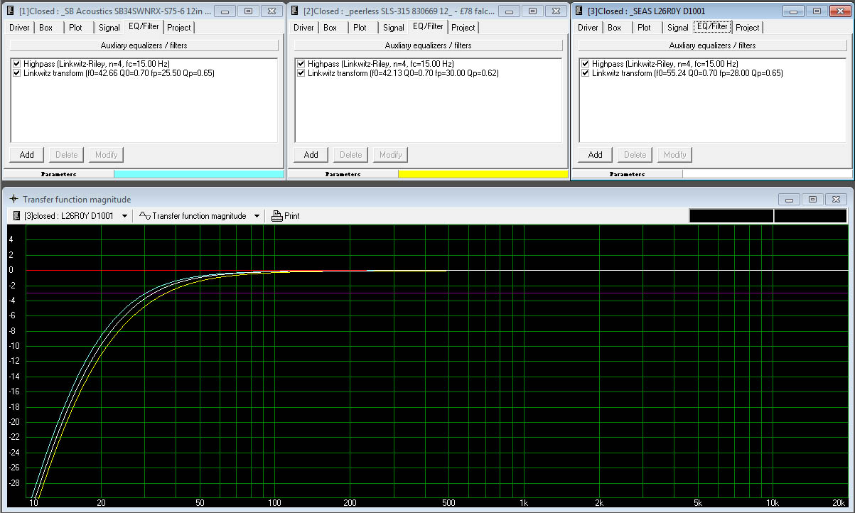

I've had chance to do a bit more simulating - this time with the linkwitz transform and a SPL of 84dB@1m. The attached chart is for three drivers with the LT pushing them all to their respective max cone excursion (in order of lowest to highest cut-off):
#Blue - SB acoustics 12" sub SB34SWNRX
#Yellow - Peerless 12" woofer SLS-315 830669
#White - SEAS L26ROY D1001
Theres surprisingly little difference; between about 30hz and 36hz. The peerless has around 2/3rds the Xmax but is larger than the ROY so can almost match it, the SB is also bigger than the ROY but has slightly less Xmax so is not that far ahead. However the SB is a sub and I've not seen it suggested that it has the low distortion of the smaller coned ROY so I'd be less confident using it up to mid crossover point. As was pointed out above, the peerless is a woofer so should be fine, and although the ROY is a sub it has proven itself.
The peerless is a bit more sensitive than the ROY and much cheaper, but athe main difference is probably box volume. For a native Qtc of 0.7 the peerless needs a box volume of over 190L, whilst the seas only around 20L. With sufficient amp and driver power handling, the LT can correct the Qtc allowing much smaller boxes, so it doesn't need to be a huge issue.
BUT I'd always believed that (all else being equal) bigger boxes and lower pressures/stresses on the cone were best, so if anything I'd be inclined to use the LT to let me put the ROY in a bigger box than necessary rather than the Peerless in a smaller one. Although, they'd probably end up about the same volume that way, so would it actually matter?
