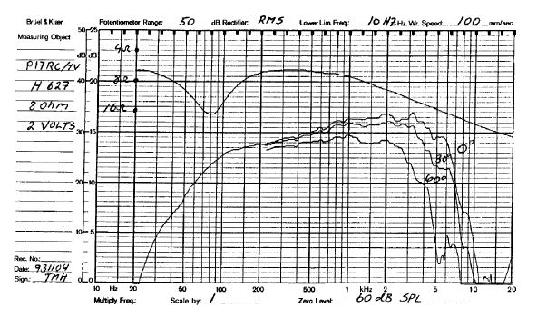

I seem to have 6 of these things, never used.
Does anyone have experience of them - or access to a crossover design?
I'm looking to make something like a Loki, but I only found info on Loki MkIII (and some on MkII). I'm not actually sure that they would have been used in the original Loki.

Oops, ignore that, those are Alu cone drivers. I think the ones you have are paper, and morphed into CA18RLY in a later life...

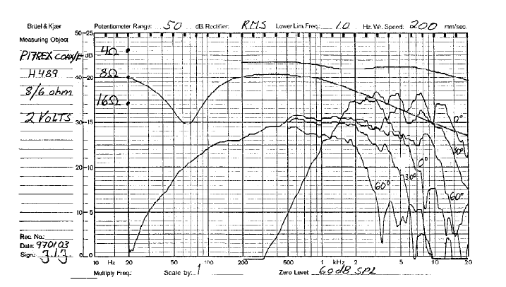

Edit 2 - wrong again, they're coax, Data sheet here: http://www.seas.no/images/stories/vintage/pdfdataheet/h0489_p17rexxf.pdf

P17REX

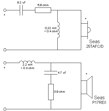

I have never used or seen the co-ax but the P17REX woofer was an excellent driver and I have it in a 2-way I have had for 15 years or more. One of the better drivers of its day. It was used in a SEAS kit called the Embla. The link below will take you to the Embla kit write-up, including speaker data and crossover. The kit called for an aluminum tweeter but at the time they made a very similar fabric dome tweeter -- 25tffc (H519) which I used as a drop in with the Embla kit crossover. It looks like the co-ax has a 25mm fabric dome, so I would suggest trying the Embla crossover.
https://www.sterremuur.nl/manuals/Speakers/Embla.pdf

Oh wait, it's the coaxial version... http://www.seas.no/images/stories/vintage/pdfdataheet/h0489_p17rexxf.pdf

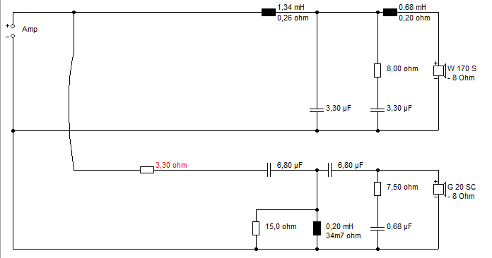

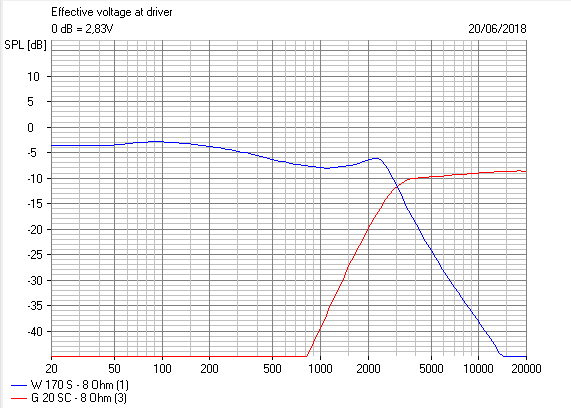

Having had a think about this, it looks like the SEAS crossovers are very similar for all the various co-axials. I include an older (Loki II?) one for interest, because it's a contender.
All around 2.8kHz. I think I would have a stab at the Loki III crossover. Worst that can happen is the midrange is a bit recessed, IMO. Maybe a 1.8mH would help that.
These crossovers are fairly basic, IMO, but fairly typical of horn-loaded tweeter designs. You would probably have to fiddle around with tweeter level too.
That's why I like DSP! I probably could have pointed out that I had the datasheet already - that's for your help.
