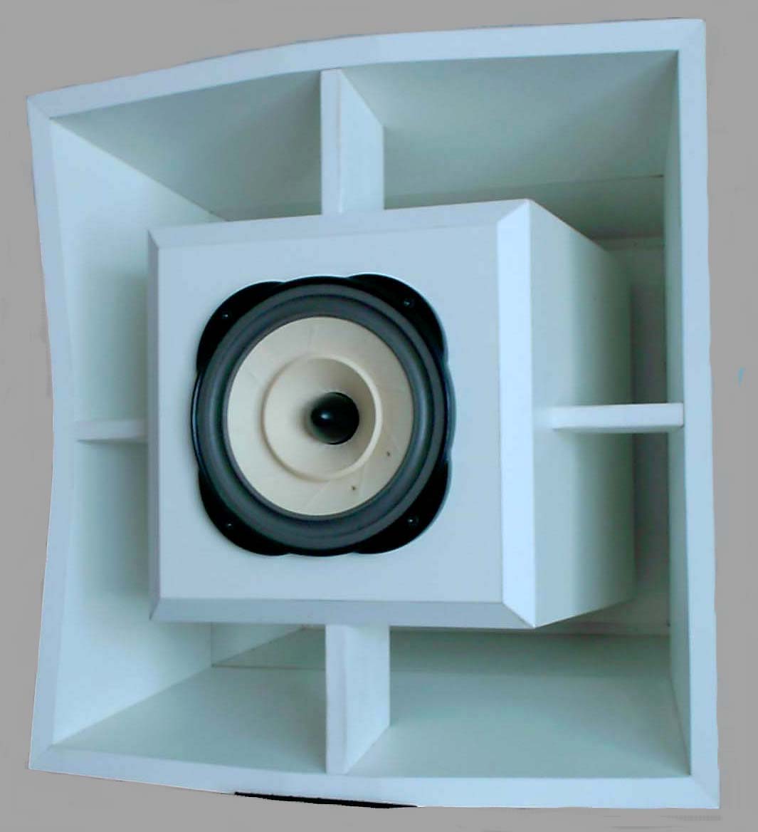

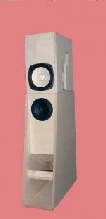

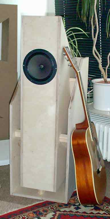

Hello,
it has a good test in KLANG&TON,
and would work superb in my Sat horns, no crossover, fullrange,
down to 100 Hz, ~96 dB1W1m, you need a good sub.
Look my Horn- , Schalmei- , Trumpet-Sat.
Also work in my double horns, bass down ~30 Hz, no bass impedanz flat~4 Ohm,
look my RDH 20, Saxophon, Posaune XL.
New technology very good for tube amps, all ~98 dB 1W1m
look measurements, feedback and plan.

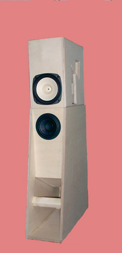

There should be a thread. I’ll see if i ca find it. Here is a picture:
This is an example of a class of speaker called WAW (Woofer Assisted Wideband) also historically FAST (the acronym makes no sense so i can’t remember it). It is a 2-way that attempts to maintain the magic of FR with as much bass as you are willing to throw resources at. Often one sees a movement from multi-ways to FR and then WAW (if bass/levels/dynamics prove insufficient from the FRs you try).
The spots on the cone are the EnABL (you will find some controversary around it, mainly from those who have never heard what it does). EnABL is not restricted to FR drivers.
