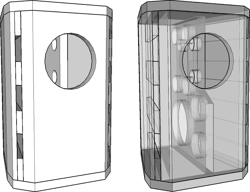

The plan view looks to be the same shape as my trapezoidal miniOnkens, with a teardrop approximation.
From the sketch i would suggest your bracing could be better. For one they should run vertically to satisfy this general rule of bracing: the aspect ratio of the subpanels created by the braces should be higher than the aspect ratio of th epanel being braced.
The braces should also reach all the way across the box, extending the vertical bits across the box and lose the horizontal ones. I also like to brave teh back of the driver against the back and top.
Double bottom likely unnecessary.
Do note that given the aspect ratio wthis will be a quarterwave box, so it can’t be modeled as a bass reflex.
I have literaly 100s of these trapezoids, this is the visualization (for a much smaller box) which shows th eminimal bracing — note that the “triple” sides accommodating the vents is a naturally braced panel. In larger ones the bracing gets more extensive.
