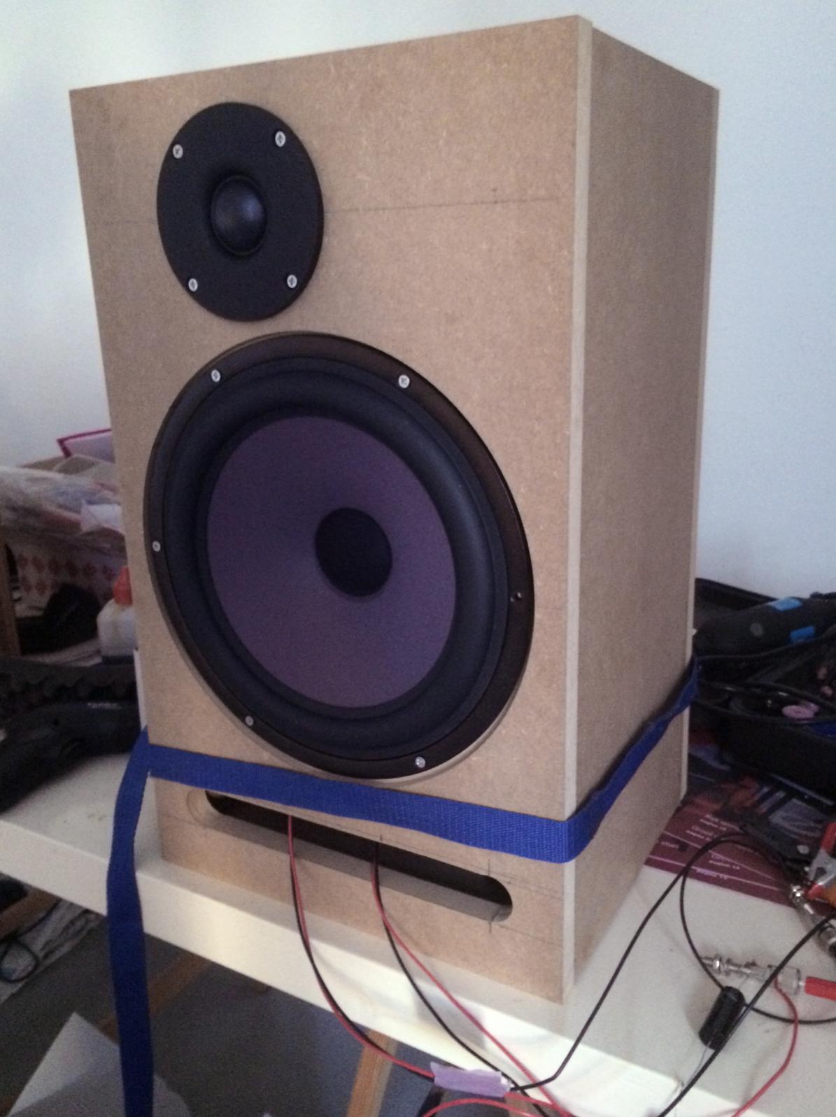

Today i got all parts for the seas A26 and could not resist to testrun the speakers in boxes i already build. The baffle cutouts are too big & too small, so i have to make those again. Also the baffles are not glued yet but sort of held in place by a "quick release" cord (is that proper english?)
Long story short, these things sound amazing already! I'm a bit confused about bracing/wall damping however. My not so educated gut guess tells me not to use bracing but instead use bitumen on the side walls to lower the resonance, and glue some damping material over that. Or would some bracing help here? I used 18mm mdf.
According to seas plans the "advanced builder" could use bracing, madisound just uses bitumen like stuff though..
Anyone any good ideas?

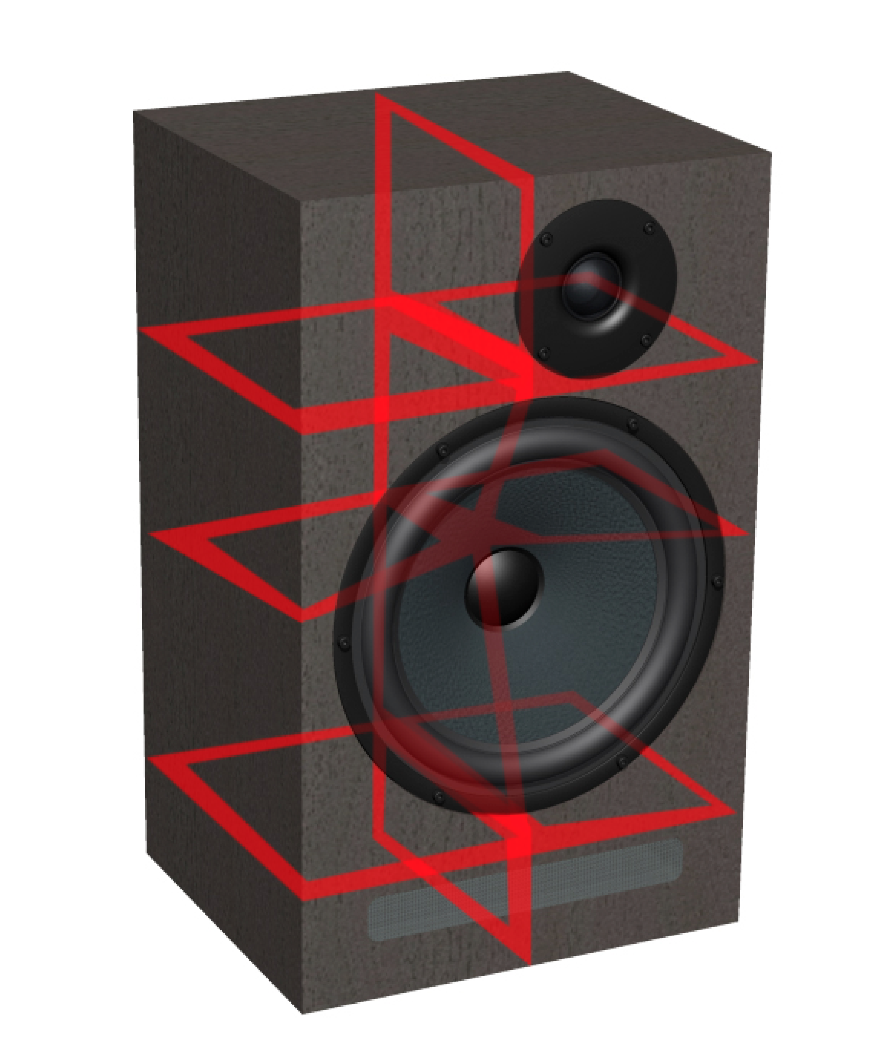

Agree, so i'm going to make a set of boxes with braces; can always go back and cheaper than sealing everything up, go funky with veneers just to think in a few months time "might i have done better"?
Just read this http://www.diyaudio.com/forums/multi-way/172073-bracing-overkill-yay-nay.html thread, would something like my drawing do?
I would make the braces from 18 mm mdf.
And do i need to adjust the cabinet size to make up for the extra room the braces would take?

Nope. That's terrible. You're just sticking battens across the panels willy nilly! :eek:
You'll just increase wooden colouration to higher frequencies. You'll hear the battens vibrating into the midrange.
The BBC damping idea lets the cabinets flex below 200Hz, but above that, colouration is inaudible.
If you are going to brace, it should be done with panels made of the same stuff as the cabinet.

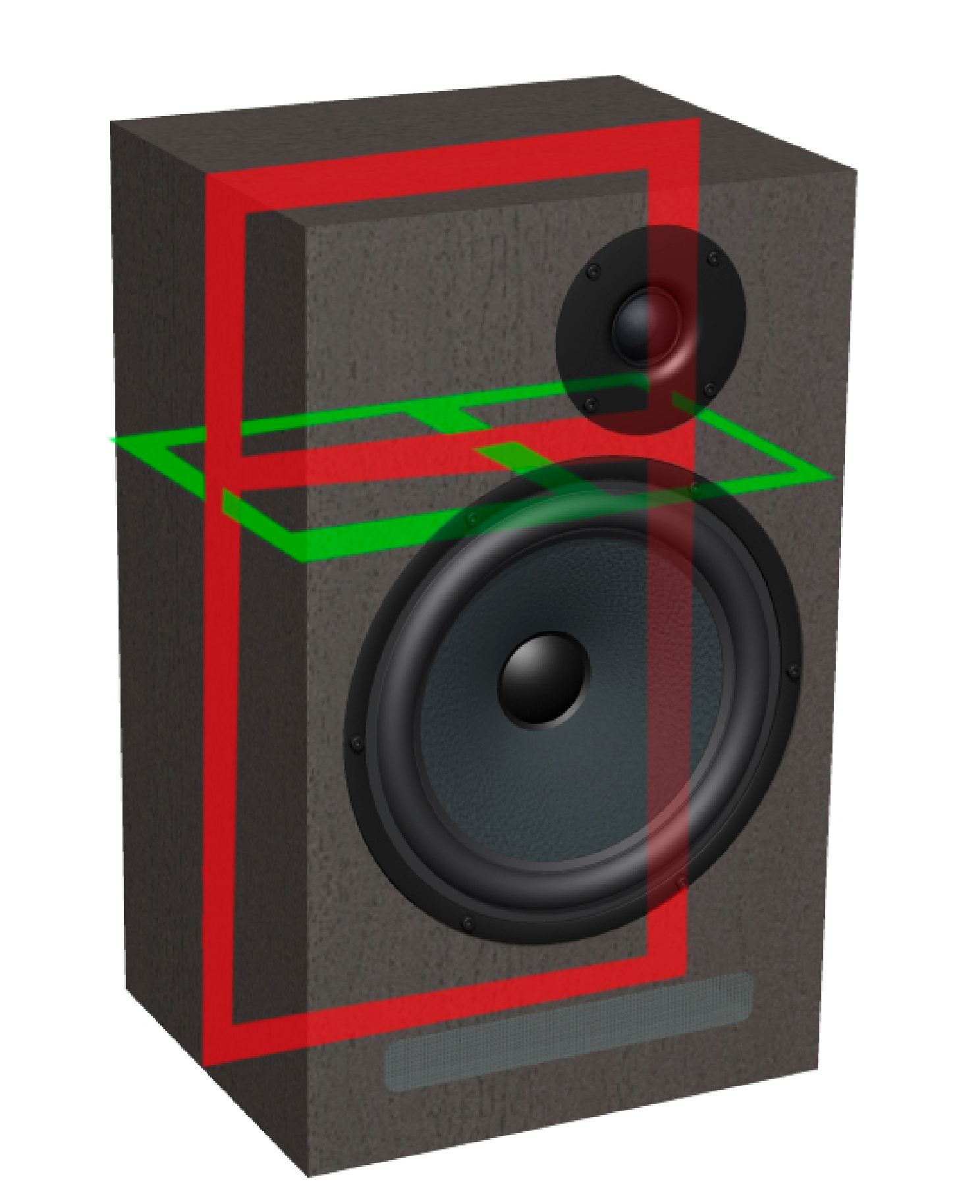

Ok, new idea;-) How about this? What i get from your link it seems to look like my new sketch; i would make the braces from 18 mm mdf. The vertical plain would be 1 board with cutouts, and the horizontal ones 2 separate boards with cutouts.

One more thing, for my leaning curve..Would one extra horizontal brace under the woofer bring anything? Since there isn't much wood on the baffle left i could imagine that that extra brace would tame the coupling from the woofer to the baffle more. On the other hand it would also couple the front to the back more as a trade-off..
Gerben, I'm not against bracing altogether. Just that sometimes it really isn't needed. :D
I know you want to get the best out of these, but really, there isn't anything to dislike about the SEAS near-Golden Ratio Cabinet. If you think about it, the bass unit is mostly braced by the side panels.

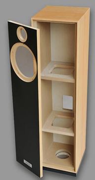

0.618:1:1.618 is considered near optimal in most respects. Where you go away from that, then bracing and stuffing (for the long axis mode in this reflex tower) will definitely help. Like the MDF WLM La Scala tower design below.
See, if the cabinet is totally rigid, how is the damping on the panels going to flex enough to absorb midrange energy and colouration?
You're going to get a terrific result with little short strengthening beech battens, the glued damping panels, foam lining and some BAF stuffing. It's cost effective and tried and true. Troels Gravesen discusses how he learned to be less anal, and just get on with it below:

Your first cabinet effort looks fine to me. The bass rebate is near enough. The tweeter rebate should be easy enough to chisel or cut to size. Flush mounting matters more with tweeters than basses as it goes.
478544d1429555800t-seas-a26-aperiodic-bracing-damping-screen-shot-2015-04-20-20.49.24.jpg
Most of those old BBC designs were made for removeable front and occasionally rear baffles. You're not taking that approach. I'd just stick 1 or 2 short small battens either side of the bass unit in the join to the sides. It just holds the joins together better, strengthening the cabinet in the long term without affecting the sound.
You could dot a few more around on the other panels too. If you do the damping carefully, you are way ahead of the standard of most commercial speakers.
