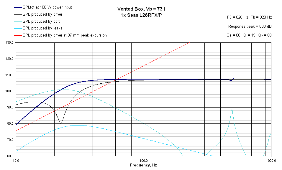

OK, here comes another simulation of L26.
This time I tried Unibox v.4.07, an interesting Excel workbook from Kristan Ougaard. You should try this!
I really like the plots from this program. Beacuse it shows so much information at one time, and still its very easy to see.
You get Total FR, Driver FR, Port FR, Leak FR, Port res, and Driver xmax in the same plot! Very good!
It is a couple of things of interest here:
Vb 73L, Fb 22,5Hz
Bassbox Unibox
F-3dB 29Hz 28Hz
F-6dB 26Hz 23Hz
Min port diam 72mm 81mm
Port L (Ø75mm) 300mm 299mm
CD > 7mm (100w) 27-48Hz 26-56Hz
Max CD 8,5mm@35Hz 11,3mm@35Hz
Vent Air Velocity 16m/s@15Hz 30m/s@15Hz
As you can see, the Cone Displacement still worries me!

Some more comments;
That you have reduced the Fb from 22.5 to 20.5, do actually increase the pipe length more than I expected. So that isnt so bad as I thought.
But when you ad more fill (assuming that it actually works at low frequencies) the pipe length should be reduced!?
I do know that bassports/pipes have nonlinearity, starting at rather low air speed. And I dont think Bassbox calculates this.
When I simulate your design in Bassbox, it becomes more similar.
Vb73-75, Fb22,5-20,5 fill 10%-35% and flared portends.
Bassbox then get a portlength of 40cm, but this is with a smaller flare radius and smaller max diameter.
The max cone displacement is 17,2mm (p-p)
But the Frequency response has a more linear roll off in LspCad at 100w (because of port nonlinearity). At 1w they are similar.
All in all I think they give very similar and accurate results.

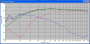

I'm still wondering about CA26 vs L26, so while listening to some heavy bass music today, I was wondering how this CA26/BR/testbox-combo measured.
I measured nearfield both the CA26 & the port with Speaker Workshop, and then combined them. The box is 54L and the port is Ø7,6 x L 22,5 cm.
I looked at my simulation in Bassbox, but it was difficult to compare. So I simulated it in UniBox, and imported the Fr-file into SW.
The result was rather interesting I think!
Look at the attached file;
CA26=red, port=blue, combined=black, and Unibox-sim=green
FUN!
FUN!
I don't think you can combine (that is sum) the port and nearfield response - since you have unknown relative phase between the two measurements (ie. it's like measuring a tweeter, then turning the box 180 and measuring the woofer response - then combining those two measurements to get the system response).
Even though - a pretty interesting measure!

Since I measure it indoors, there is no other way to do it. And if you look at other measurements from DIY subs, this is often the way its done. Of course there can be phase problems that is hidden, but most simulation doesnt take this into account either.
So for the purpose of checking a simulation against the finished box, its OK.
What you get in sweet spot is a different story!

Well with my luck of simulating in Unibox in mind, here comes a plot for compering:
Dark blue: CA26RFX, Vb58L, Fb33Hz, 100w
Black: CA26RE4X, Vb65L, Fb33Hz, 80w
Pink: L26RFX/P, Vb70L, Fb21Hz, 120w
All three is loaded with max long term power.

Hi Norcad,
My prototype design has the L26 close to the floor. I figure I'll get more even reinforcement (aka similar to ground plane) and less peaks / dips - since a "gap" between the driver and floor will cause cancellation at repeated intervals of distance for a given frequency.
Here's an example of an 8" woofer approx 60cm from the floor. Notice the dip centered around 100Hz - very similar to your simulations. There is a peak around 60Hz - which may not bode well for my L26 as the LP to the midrange causes a high Q peak around 60Hz.... may need more work.
David.
David.
