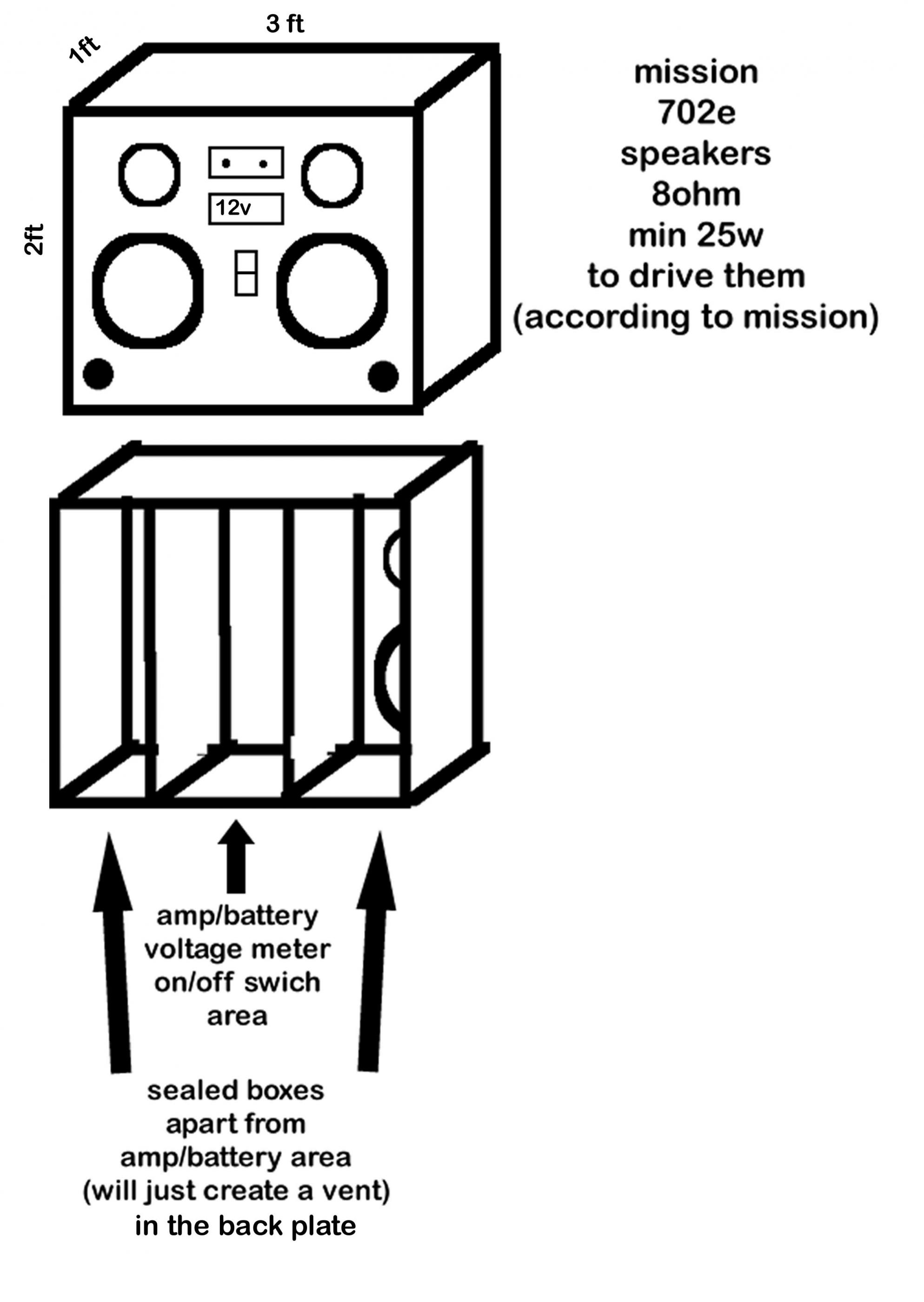

Would would you suggest I could build knowing my specs...would a mono board sitting in each mission 702e with each having that 12v battery.....wired so I can plug my input to both...or a stereo board and then the best way to wire up both those 12v batteries for longer playing time rather than loudness...thank you for your input/help already...you do make it sound easier than what I've been reading on the Internet lol......
This is the sort of look I'm going for but using both my missions... and it gives me something to stand on when im painting 8/12ft high lol...I have the wheels and pull up handle already lol :0)

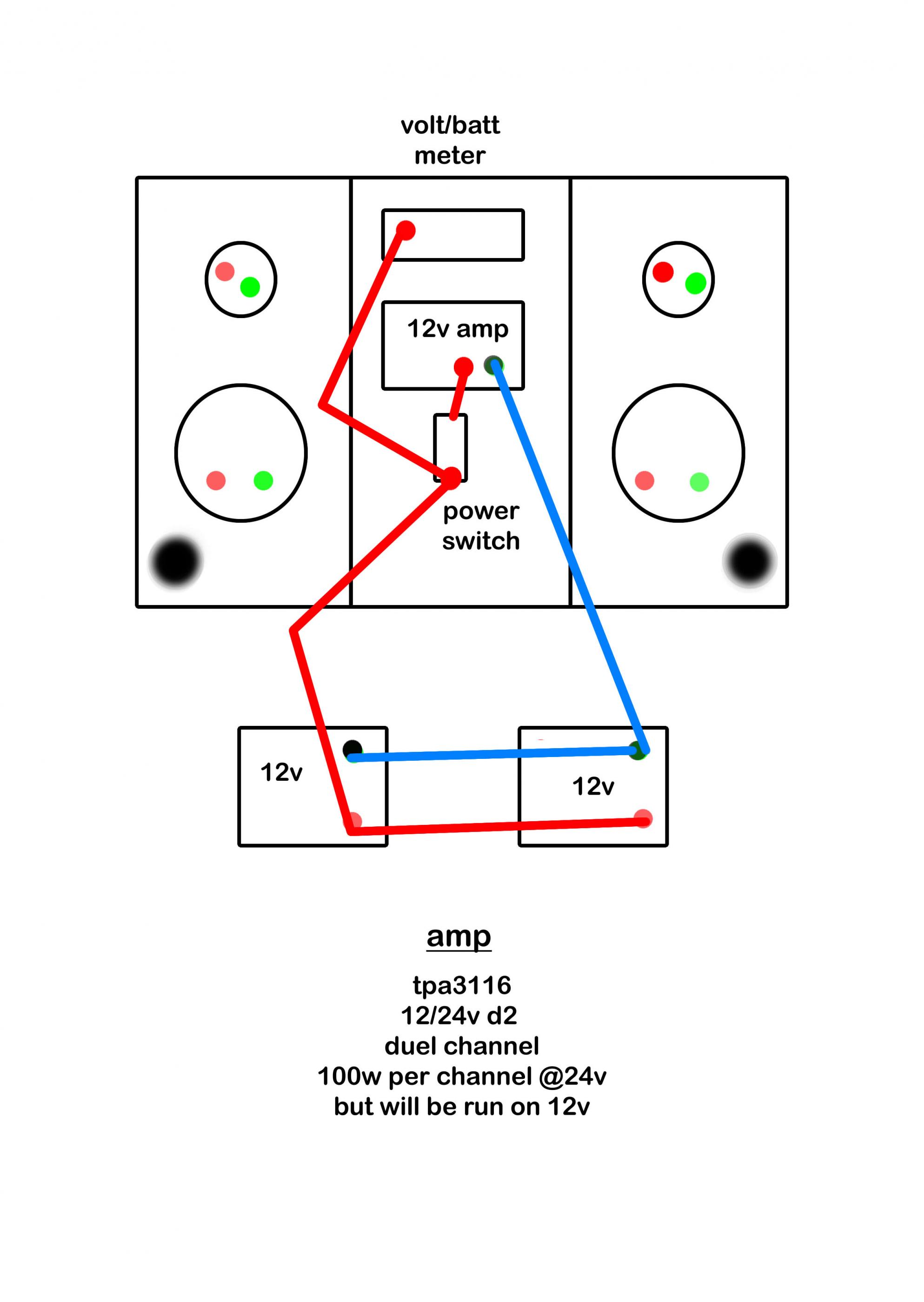

The amp is tpa3116 12/24v d2...duel channel 100w @ 24v but will run it at 12v....I guess the questions in asking is
1...does this wiring look right?
2. What ah batterywould I ned to run for 6/8 hrs at 12v.....can't find out how many ah the app and speakers would push out otherwise I would use an online battery calculator :0)
Thanks for any help...if you are UK based I'm happy to produce you a piece of art for free if you can idiot guide me thru this as I know absolutely nothing about this side of things. (Very gratefully for help received already from this site :0)..if outside uk you can still have it free but would have to go half's on postage :0) Trying to help where I can :0) mateyb southwest on fb...
Can't really see from the pics but I have the + battery wired to the on/off switch then split to the amp and voltage meter and just to the - battery running to the amp....so is this right?
I'm probably in the wrong partor the forum now but it is a d class amp ;0) thanks...can't seem to upload the plans even those I can see it hear on the thread......will upland them to my Facebook so you can see what I mean....mateyb southwest.......thanks
Your Mission 702e were 8ohm speakers, right? Well, out of 12V, at best you can expect maaaybe 10W or so relatively clean, or 15-20W distorted. If they were 4ohms, that'd be a different story...
You'll really want to series up the batteries if you want to use these particular speakers. That "100w" rating is... "marketing-ly optimistic", let's say, especially given the 26V max supply the TPA3116/8 are rated for. With a 4ohm load, at 26V, you can expect a clean 70w, or a distorted 85w-ish. Half that into 8ohm, "obviously".
Runtime's gonna depend, i suppose, mostly on how loud you'll expect to run these, and/or what type of music you'll be playing. In the sense that stuff with, say, prolonged bass noted will, in time, require more "juice", for a given volume level.

Thanks for getting back to me....so would this board be better? Only 25w per channel and it says best suited for 8ohms.....will happily upgrade to 24v....
KKmoon TDA7492P 2x25W Wireless V4.0 Audio Receiver Digital Amplifier Board Module with AUX Interface: Amazon.co.uk: Business, Industry & Science
was just seeing if there was any issues using 2 x 12v or 1 x 24v (cheapest was my choice)...also would that wiriing right in the diagram with powerswitch (forget batterry part now I know 24v :0),thank you......I'm only trying to do this on a cheap budget of £50 (I know that goes up now coz I need 24v battery) otherwise I would buy new 4ohms speakers and leave missions alone
You CAN connect two 12v batteries in series, to get 24v, y'know ;) But you'll have to do your research which one of those options is the cheaper.
Regarding "suitability", i'm inclined to call BS on that. TPA3116/8 will work just as well (if not better, since they can provide about double the current than the TDA7492P) , but take your pick. But then again, if you go with one of those TPA3118 + bluetooth boards, you can even get away without a heatsink.
