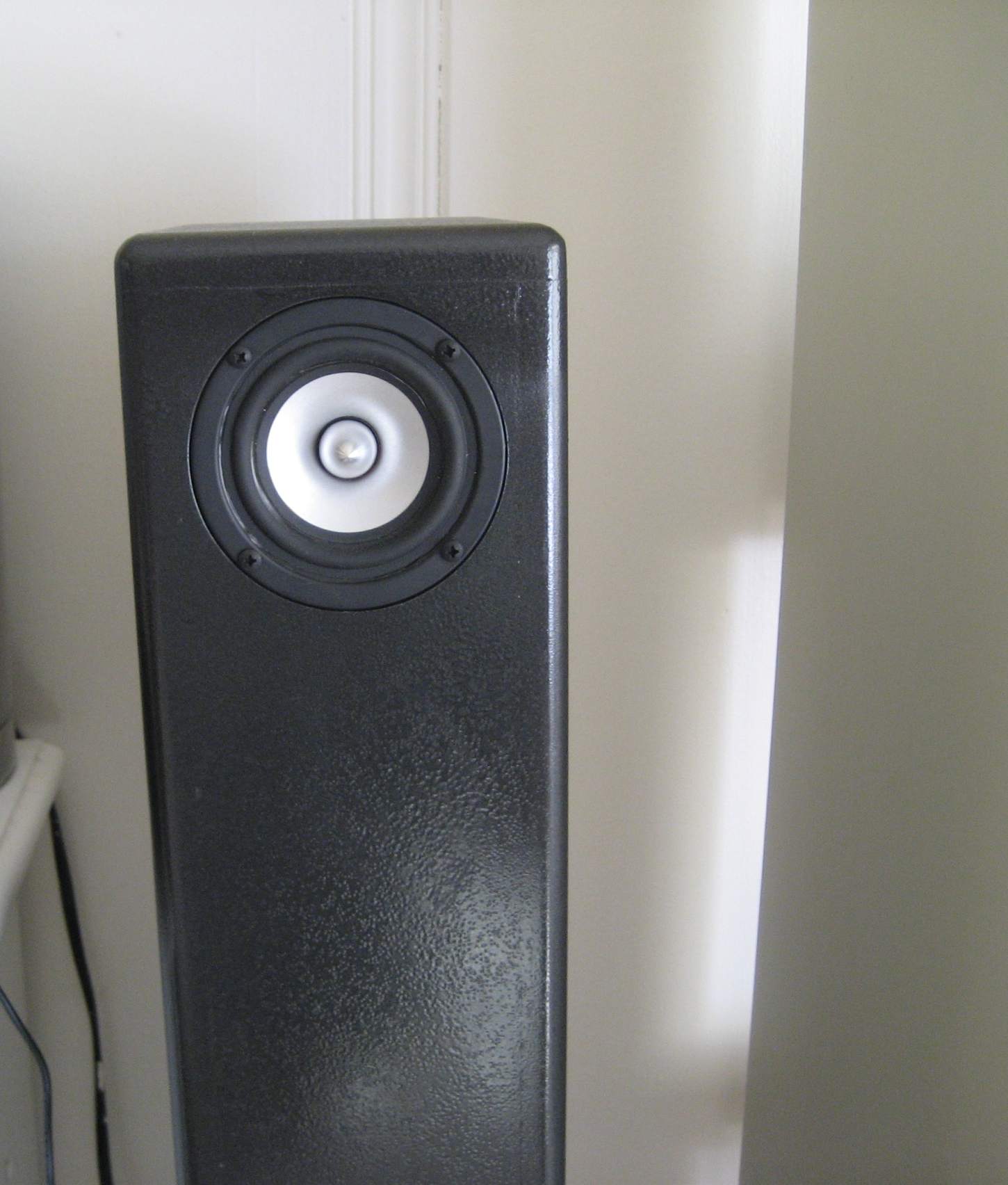

I tested watered down pva, shellac, Laquer, BIN sealer, and Drywall compound. The problem is that the face of MDF has a paper finish, and the exposed cut edge is raw fibers. It's very time-consuming to make the edge match the face. I sealed the edge with Laquer, then kept adding coats and sanding with fine sandpaper. Drywall mud is fine after the first sealer coat, but no easier to work with.
The most frustrating thing for me was hiding the seam. I finally gave up and went with a 'hammered' finish paint to camoflage the seams. Looks ok, but I'd go nuts trying to get a full gloss shine on MDF.
You can easily see the seam around the top of the Cyberg's Needle in the picture.
Did you make them? What do you think caused the seam?
Paul
Seam is the glue joint
I did make them. The seam you see just above the driver is where the top is glued on. I'm not a fan of exposed end-grain. I normally make make miters, or veneer the edge. These were just an experiment to see what full-range speakers sound like (as opposed to 2-ways with a crossover). I dressed them up as far as possible so they'd look good in my daughter's room.
If I ever use MDF again, I'll plan on covering them in veneer. The expense would be much greater, but I just can't get a fine enough finish with raw MDF
