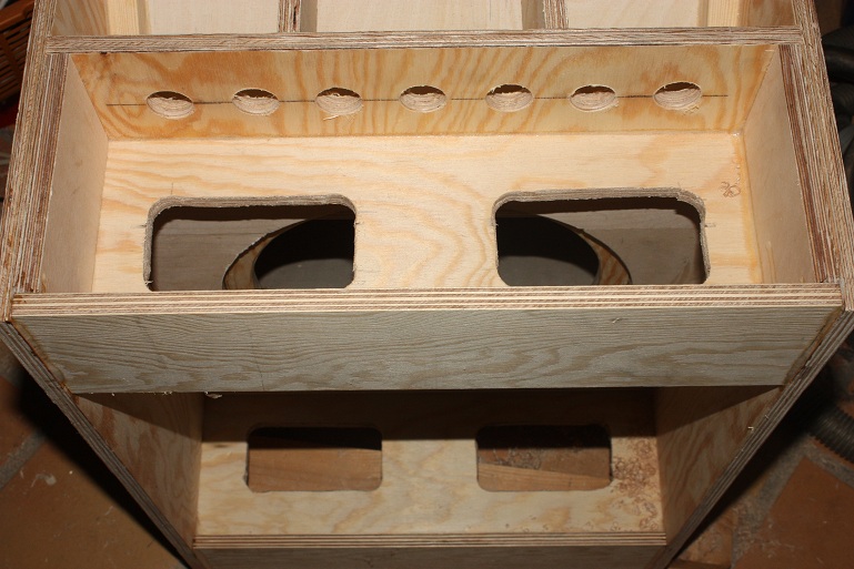

closed apperiodic design
especially leightweight, and portable
though light, still very stiff and 'dead', due to bracing
and stuffed, the bracing also works as acoustic valve, for the apperiodic system

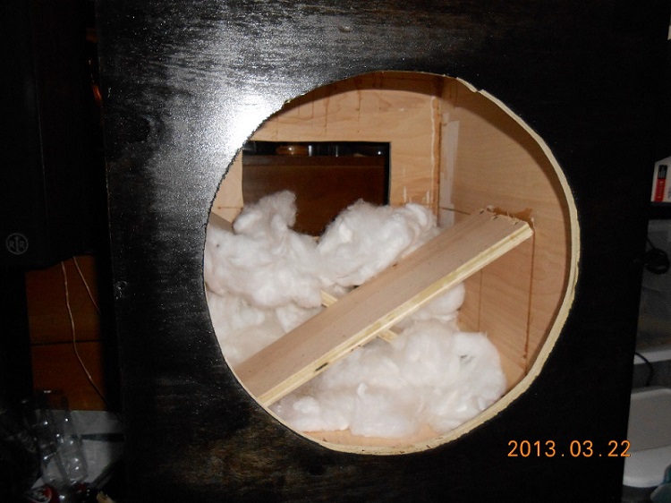

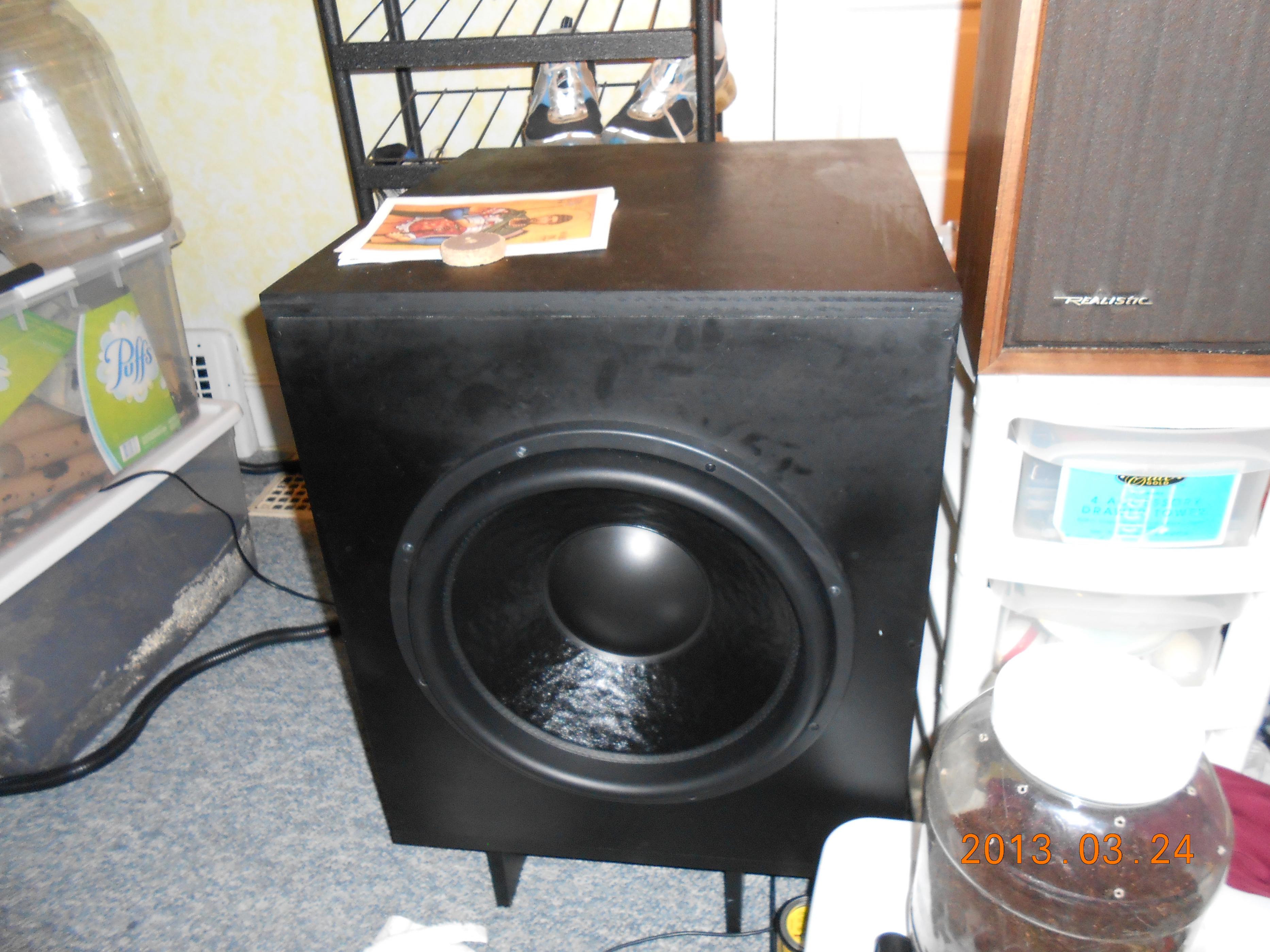

me & a freind built box but I have to seal up up with extra wood bracing , plus it needs more bracing so back of box doesn't flex.
I went sealed but box is large enough to make it ported if I disliked sealed.
approx 4.5-4.8 cu footer
Awaiting box'es need for extra bracing it is ported because back is open down-facing, sitting on the Styrofoam that came with the sub when shipping...Port doubles output almost.. but It seems like bass is not very controllable
