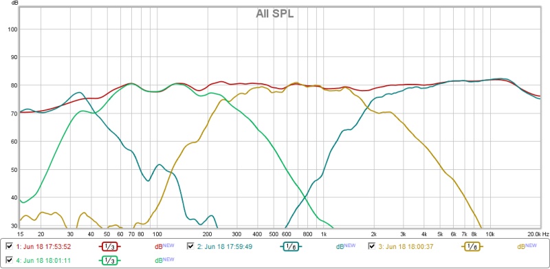

You can see at present these speakers use LR24 crossover slopes (all via analogue crossover), but given all three drivers (esp the 12MU mid) have a large usable pass-band, if I went with a digital crossover, a Harsch would be very easy to achieve.
Perhaps I should think about getting another 4x10hd......
